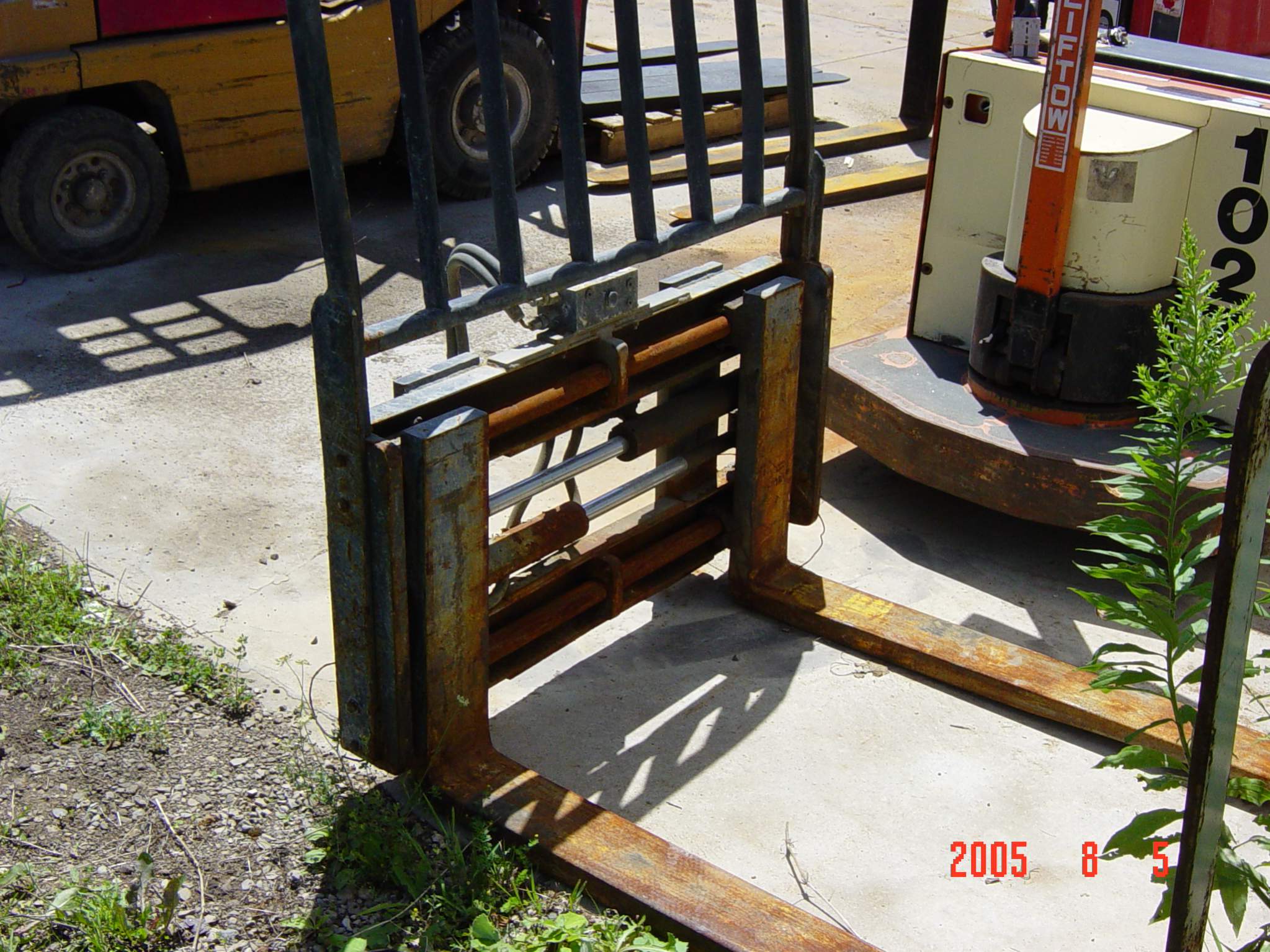

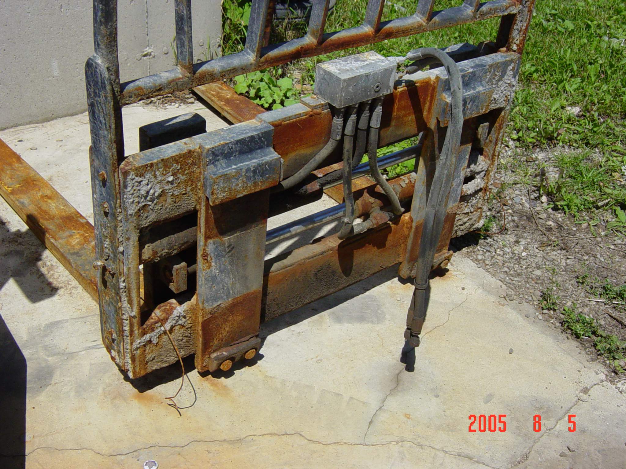

There is an interesting pallet fork att for skid steers sold by Sheyenne tooling and mfg called the tele-fork

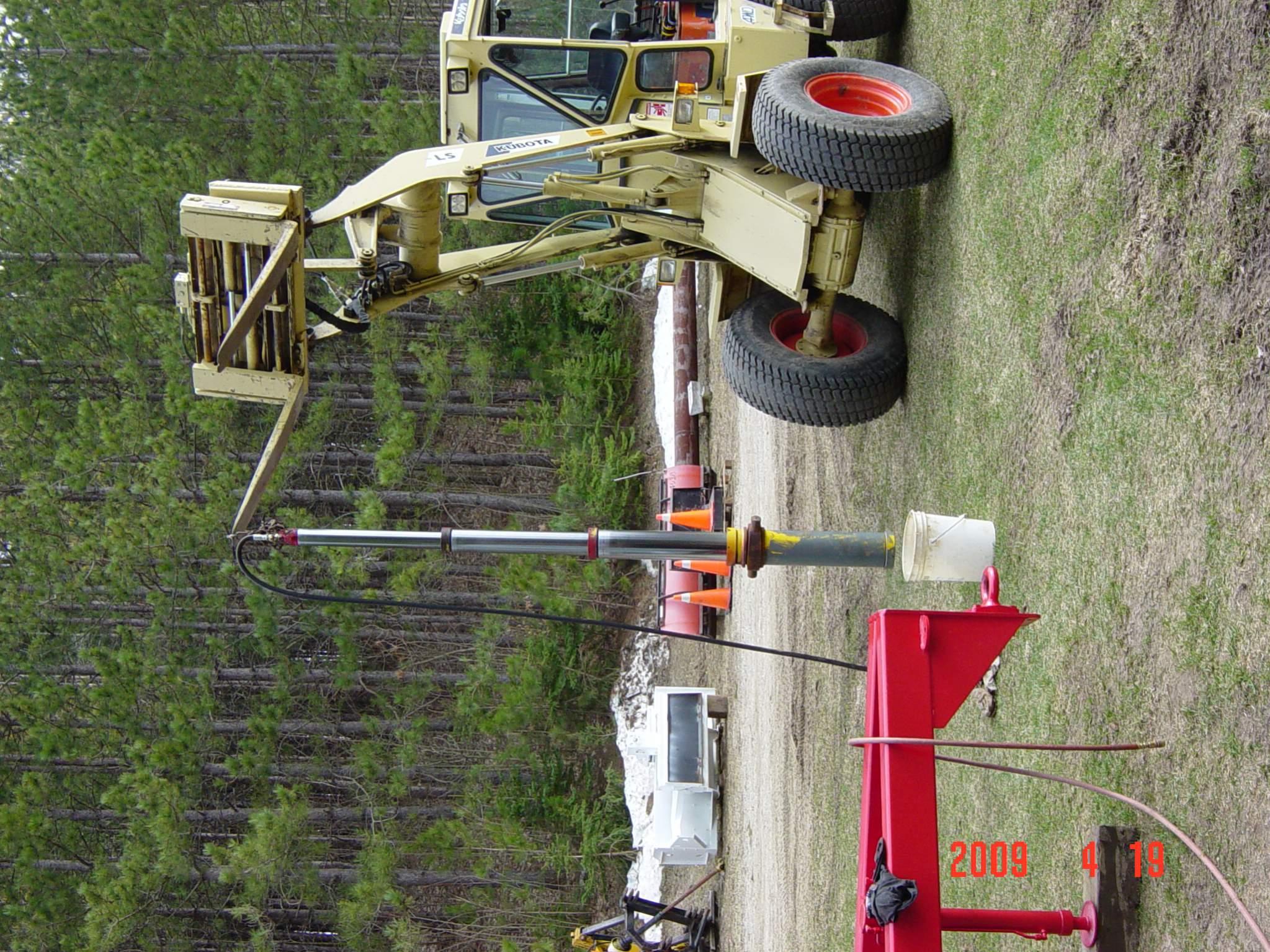

These were the forks as I found them. I think I may have paid $500.00 CDN.
I have used them to pinch and carry large rocks but this is bordering on abuse!
Oh, I did make the mistake of welding a SS plate straight on. Now, I don't have much upward tilt, but can bring the forks down past perpendicular which serves no purpose.

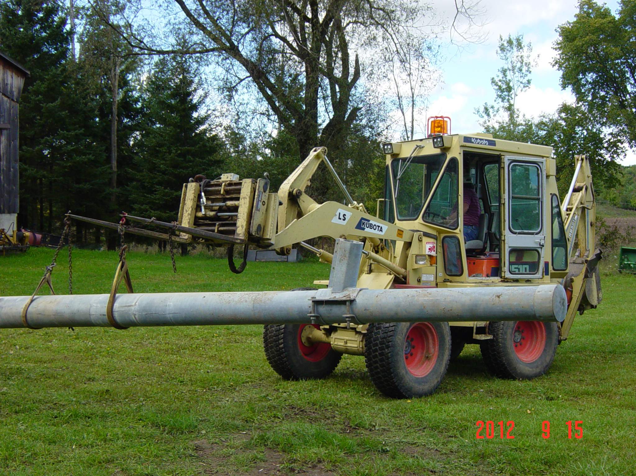

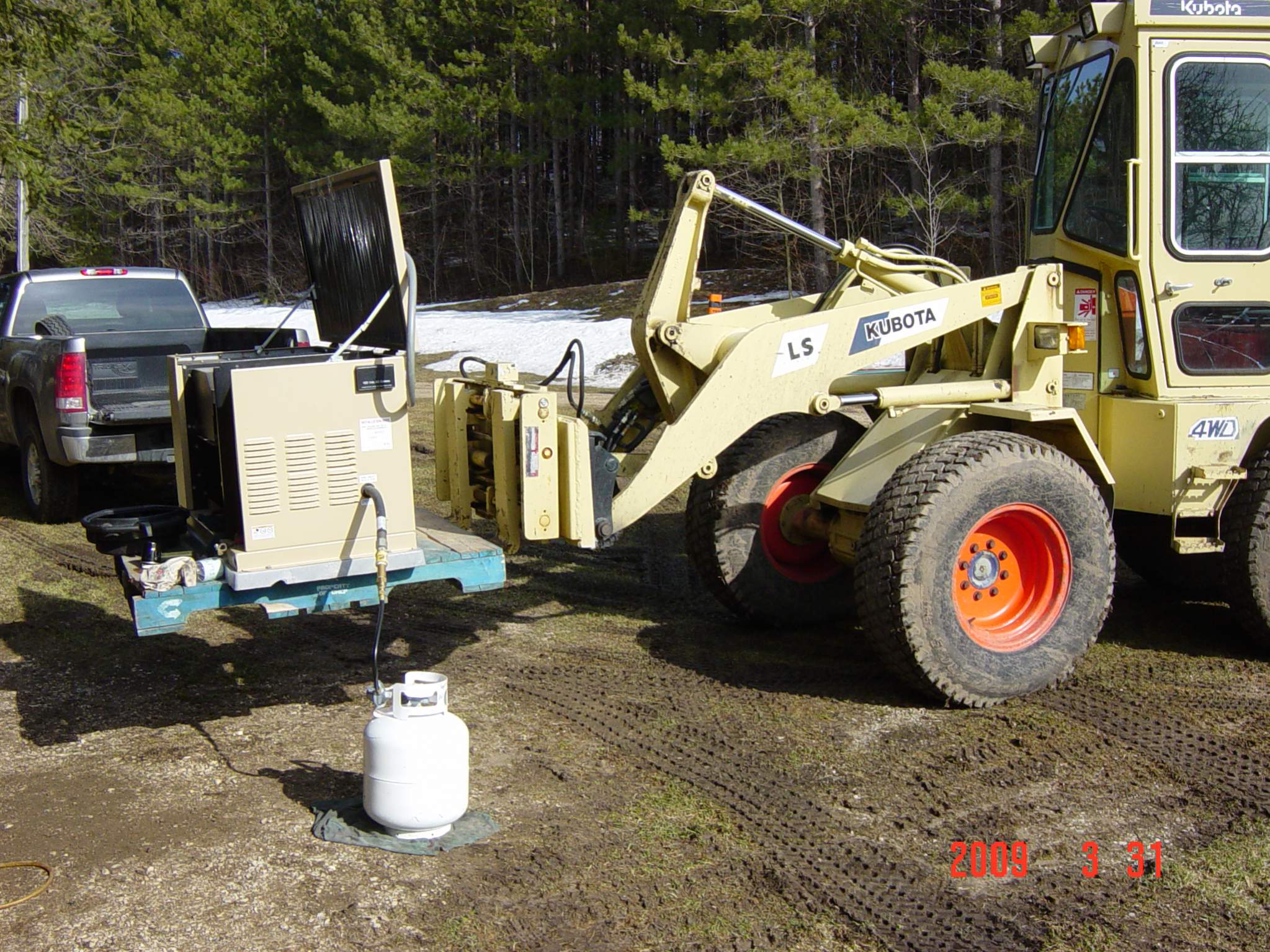

Some pics of the finished product in use. Sandblasted and painted.
