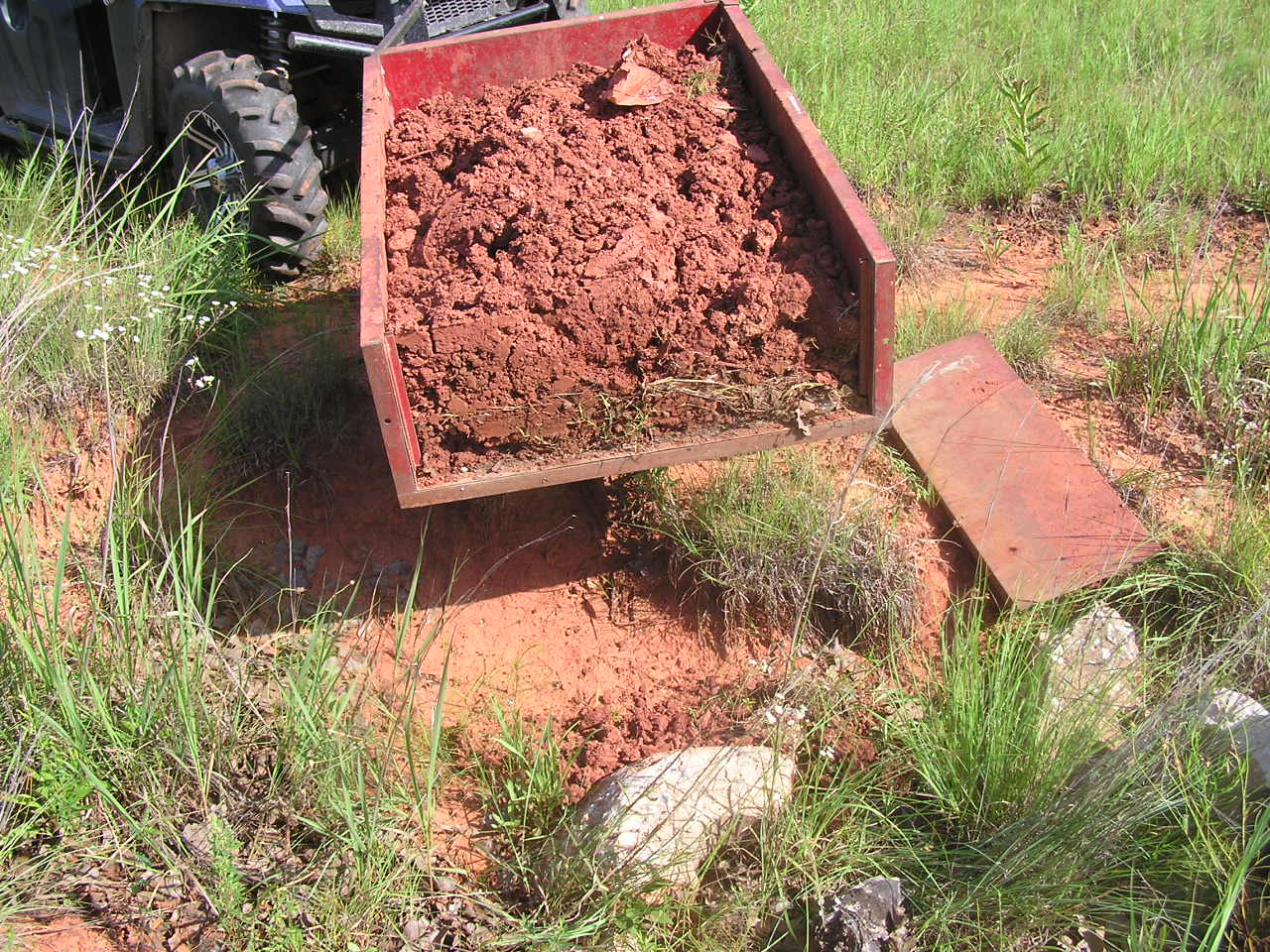

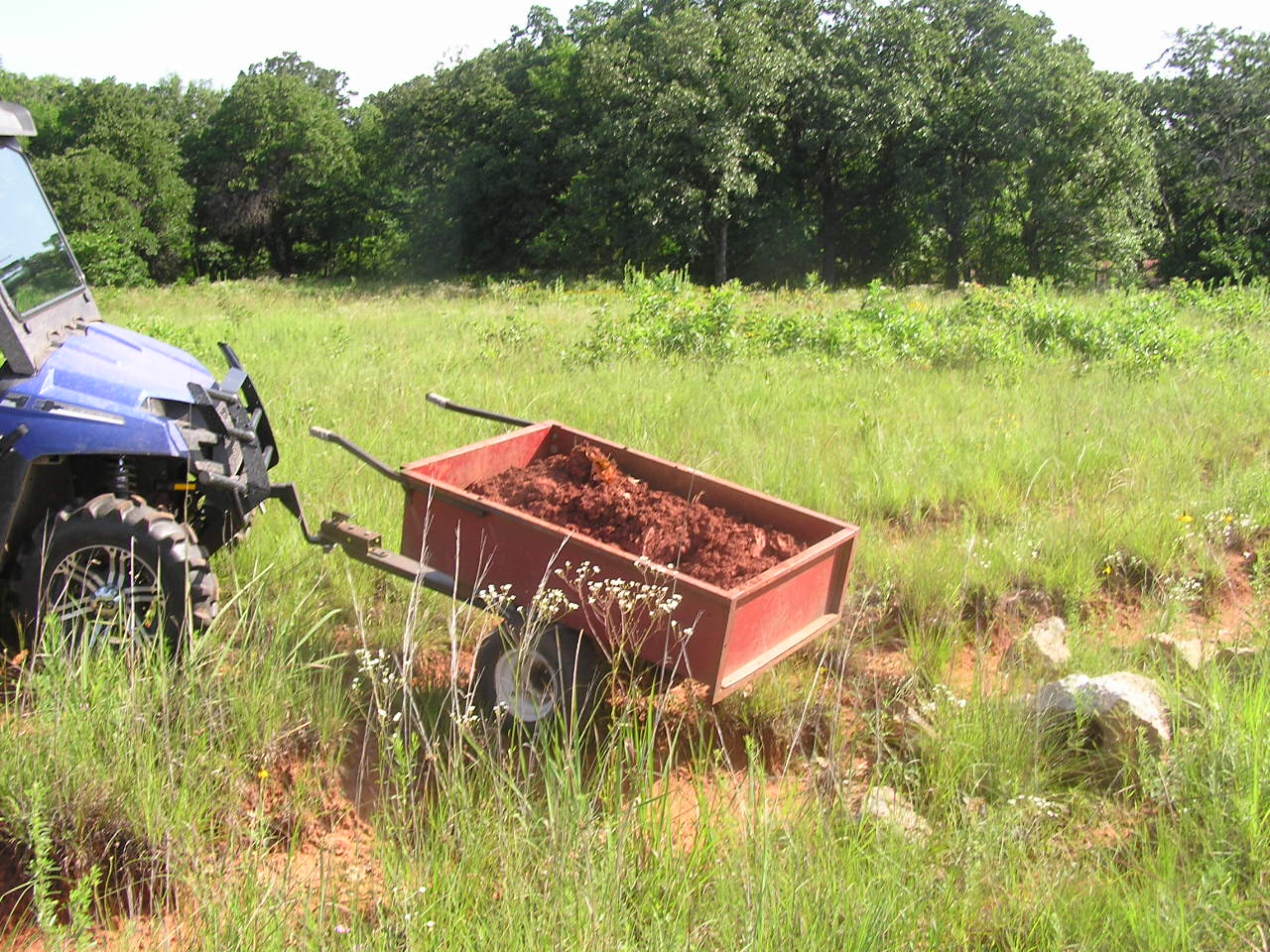

That does bring up a good question. How much tilt is needed?
Then I've got a tipping garden trailer that barely tilts 20 degrees unless it's over a bank. (which it often is)
The trailer needs help to discharge a load. -------------
I would say that somewhere around 35 degrees of tilt is enough for anything but wet clay.
I bet there are other considerations and opinions on the details. ;-)
Here is some damp clay in the garden trailer. Just over 90 degrees worked well. :D

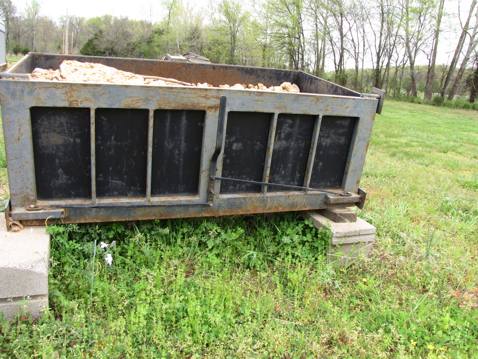

It's 14ga metal. Here is a picture of the tail gate latch and 3pt hookup.. That was put on right after the pictures from 2009 when I made it. 2 or 3 of the neighbors seen it and just had to have one, so I made them one as a good well thing.
