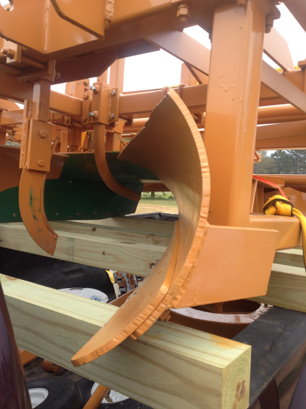

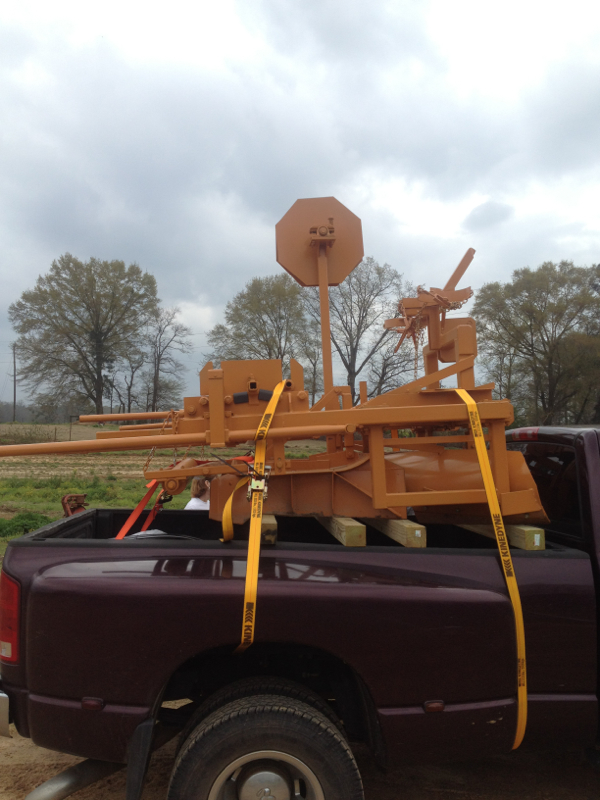

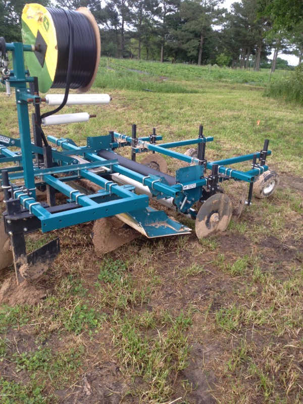

Pics of my Buckeye.

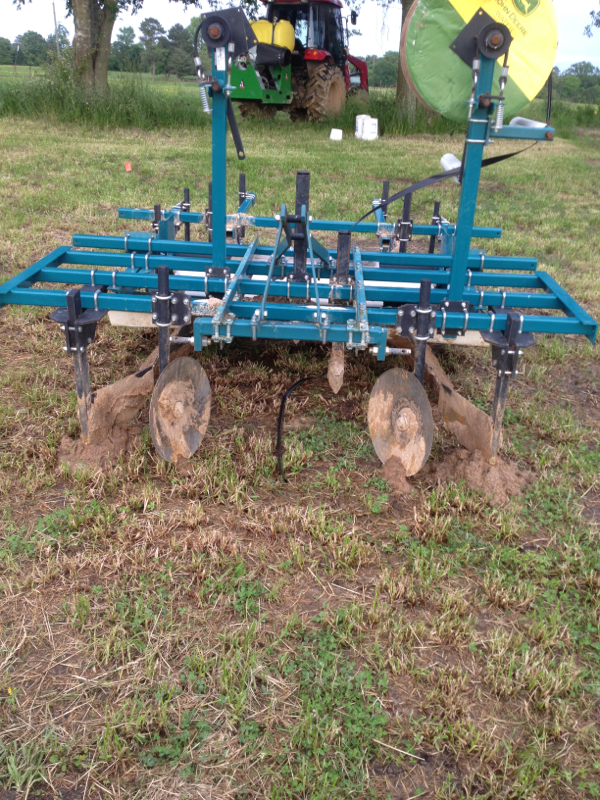

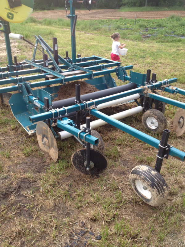

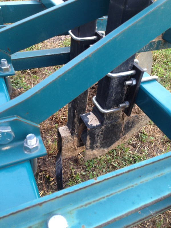

Close up of drip and a Reddick.

For what help it may be?. I narrowed the front end of my pan to try and get nicer sides. I thought that the sides would smooth better. It helped with my soil- the wider mouth was forcing the soil in and it was firm inside the pan but sides would bulge out as the pan left. Now it slicks out nice. Working with your soil is the hardest part, keep up the good work!

Thanks, I have it done but it is too wet for me to try it so far. I am sure there are adjustments to make. Yours looks a lot nicer than mine. My drip tube is set up like the yellow one and I wish I had as much roll in my wings as the photo. I can always weld something on mine to roll the dirt. Looking forward to trying it out. Thanks for the pics.
