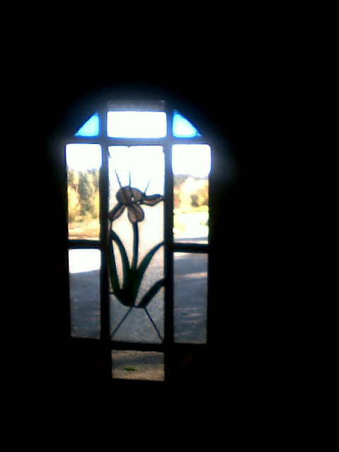

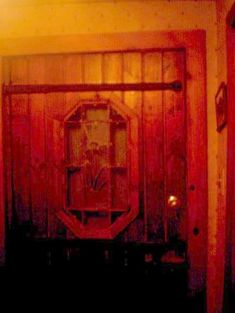

The camera angle makes things look crooked, but they're not, I checked after looking at the photo. These strap hinges were off an old barn door so I can't claim credit for actually making them. I just reworked them to fancy them up a bit, by beating the rounded ends on and hammered the straps to give them a hand forged look. We handmade the door itself including cutting the logs and sawing the lumber (for the whole house). The window was out of a 100 year old church in Montreal and the Iris leaded glass center was made for us by my late brother in law. It's been working good for 35 years and I expect will be good for another 1000 or more.
