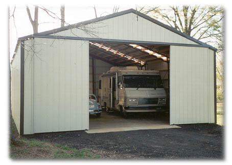

I’ve included a photo of a similar Bota-barn to the one we’ve ordered.
The total price should be somewhat less expensive than a typical stick-built barn if all labor is considered. However with this system we believe it can be erected quickly by ourselves (before winter) but also have the significant benefit of owning a building with a very tall ceiling height and no internal vertical columns. Later we plan on modifying the building, with time and money, to add a garage type door or two, windows and perhaps create a workshop in there. To keep the total cost under control we plan on building it on concrete piers, using barn board for the exterior sheathing and hot-top as interior flooring.

I'll try to add the photo again.
tony

Mark,
The building will be similar but have red-stained barn board siding with white trim. Roof will be the silver colored Galvalume material (For simplicity and durability) and have the same pitch. I opted for the standard shallower pitch to improve my chances of not falling off the roof while I build it. I'm not fond of heights. In fact we'll likely rent a sissor lift to erect the roof trusses and roof sheething to be safe. Besides it looks like another fun power tool. Wonder if I can get a sissor lift attachment for the 540 PTO?
