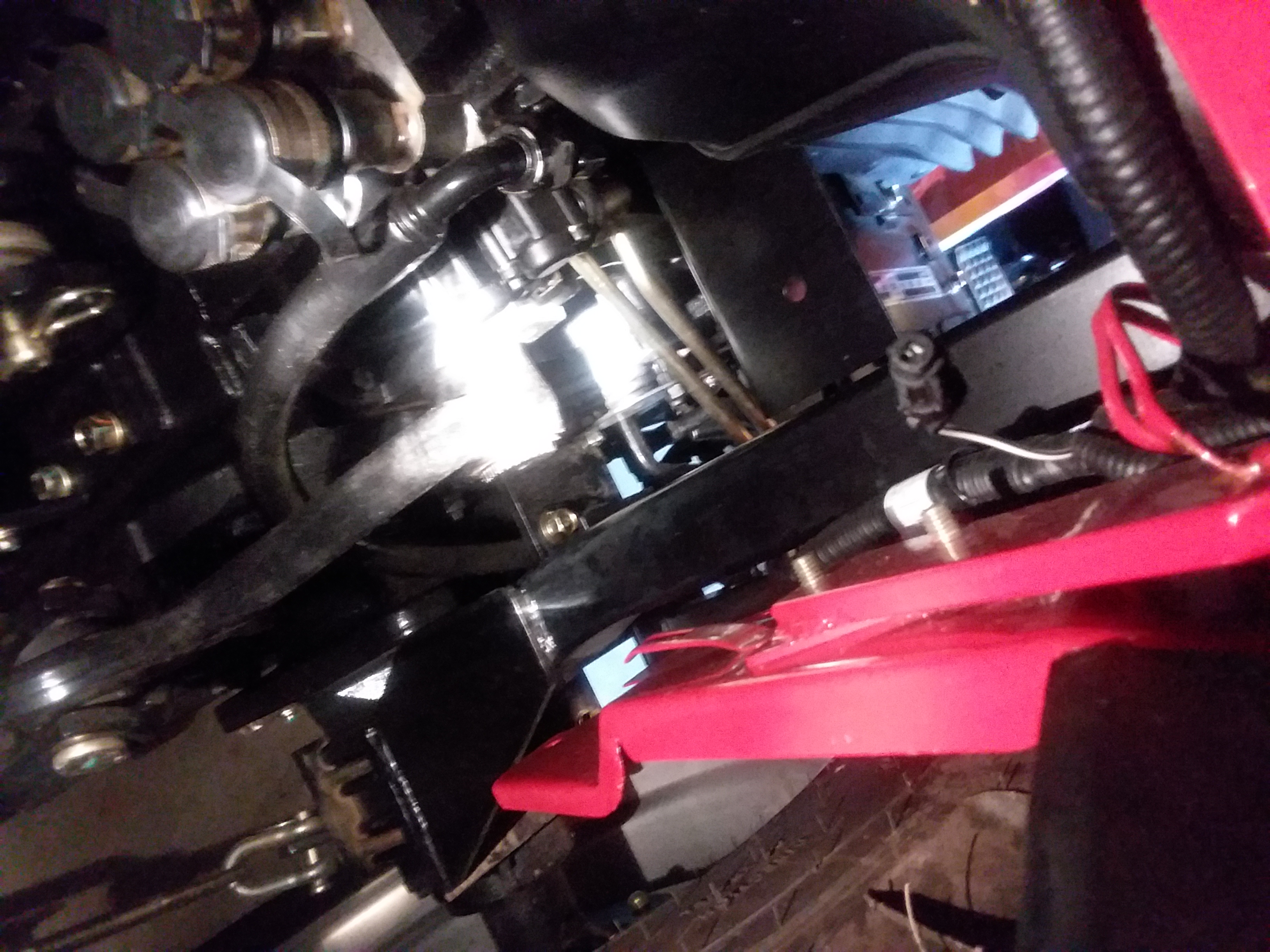

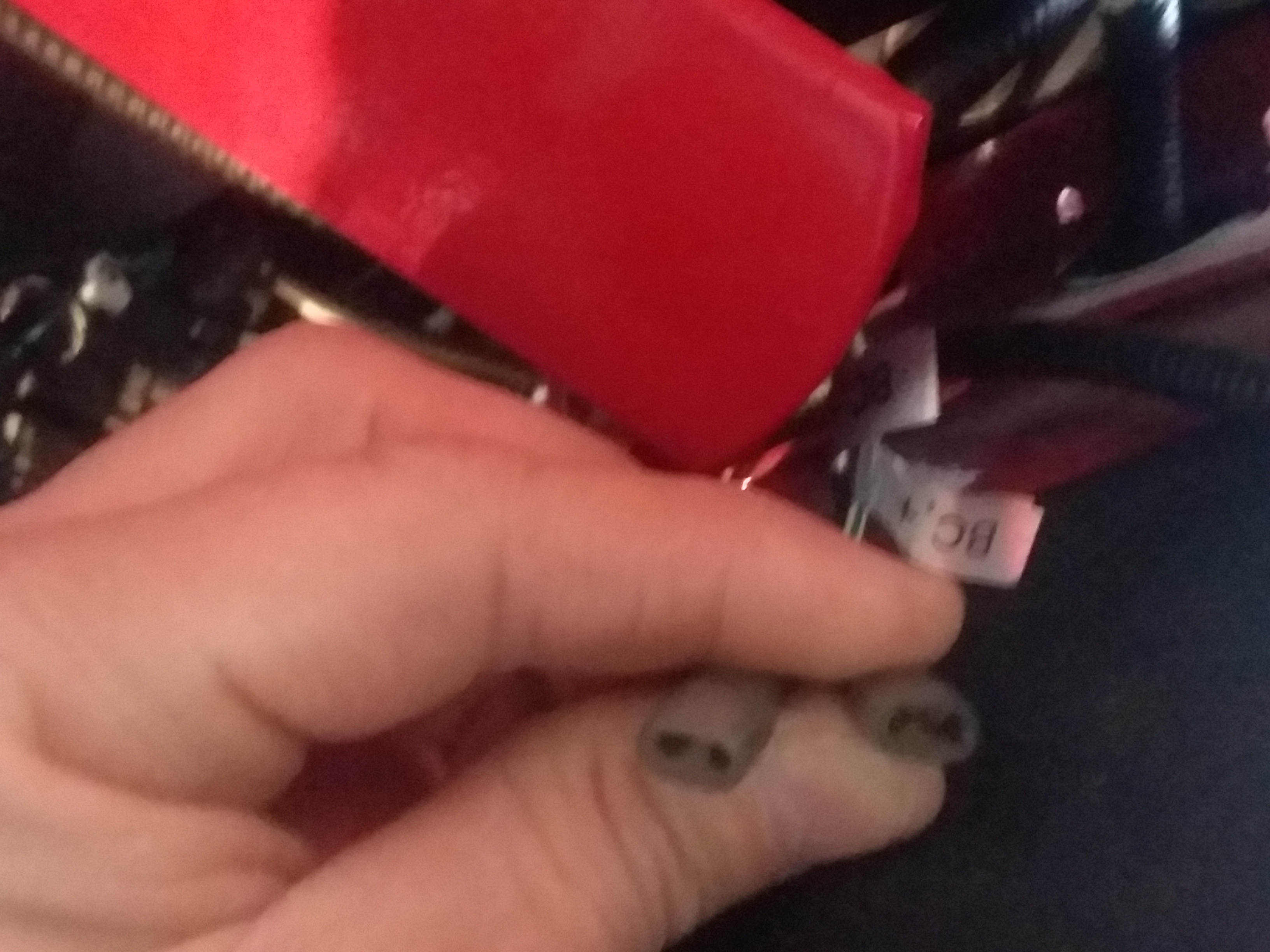

airbiscuit there is two plugs behind the right tail light that say BC+ and BC - is that what you are talking about? There is a single wire with a single black plug as well. I can't seem to find anything on these.

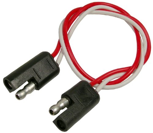

On my New Hollands, under the seat, there was an unused plug that looks like this:
It was live when the key was turned on. It is part of the wiring harness for a work light. I believe Kubota does this as well. Do you see anything like that? Are your BC+ and BC- plugs unused (nothing plugged into them)?

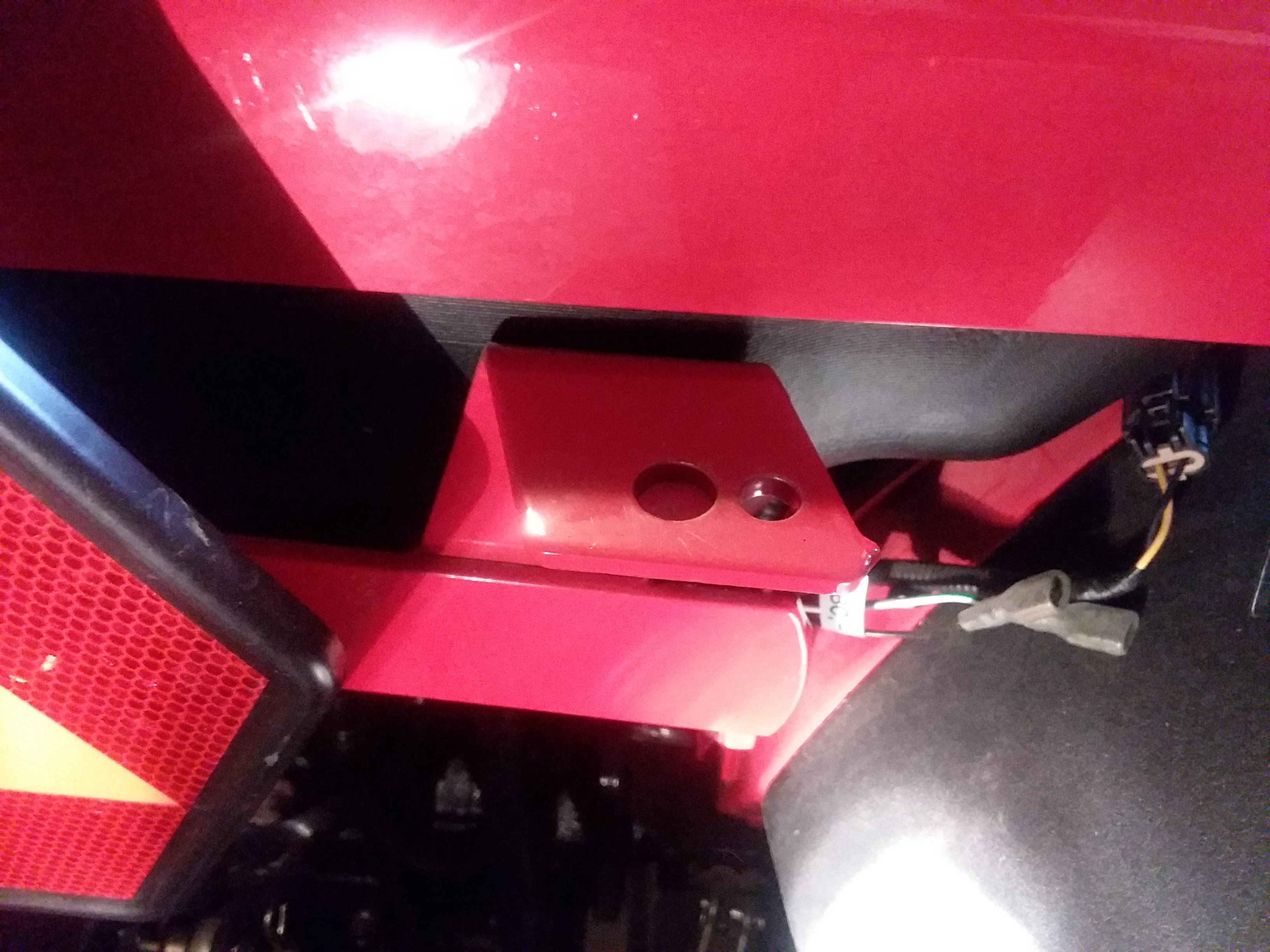

here are some pics of what I have on that right side by the tail light and then wires going to the trailer plug.

That plug in the middle picture looks interesting. Have you connected a meter or test light to any of the plugs to see if they are hot, always on, or only on when the key is in the run position? You could ask the Mahindra dealer what unused plugs are for. That might give you an idea about their capacity.

I tried the dealer they didn't seem to know much, I went over the manual and could find nothing about it. I have not tries a meter or test light I currently don't have one but that was my next step.
