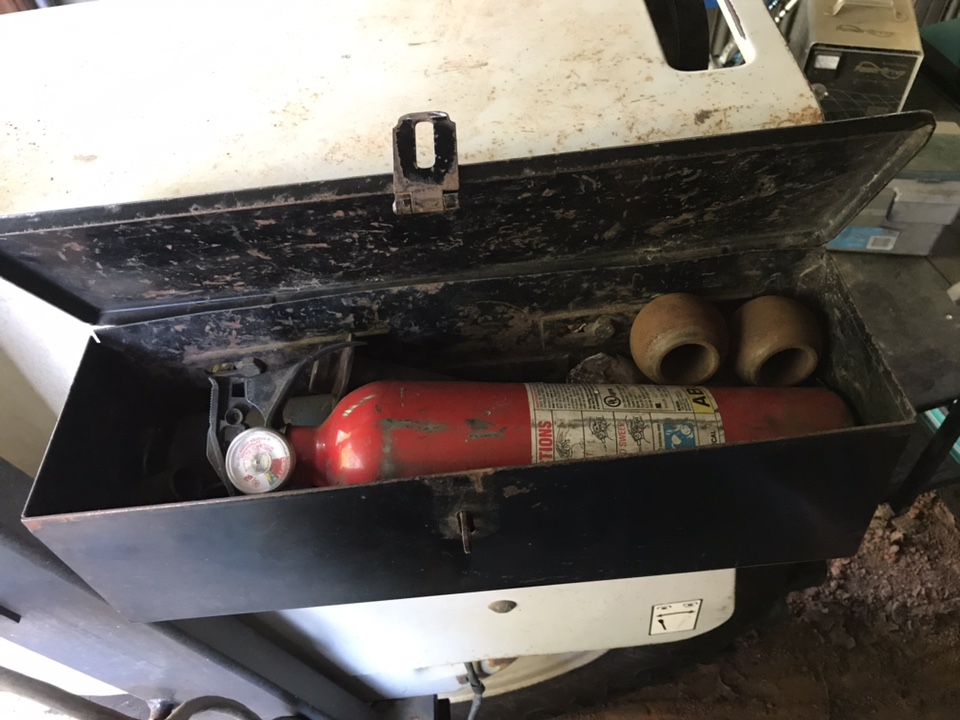

I took this picture today. Better than nothing.

That's good to know about the all steel designs. Once this one's time is up I'll look into that for the next one.

Make sure you give that a good shake from time to time.
Fire extinguishers mounted vertically are notorious for not discharging because the powder gets pounded into the bottom neæ±* to ever come out...many machines have burned to the ground because of an extinguisher that didn稚 fire.
