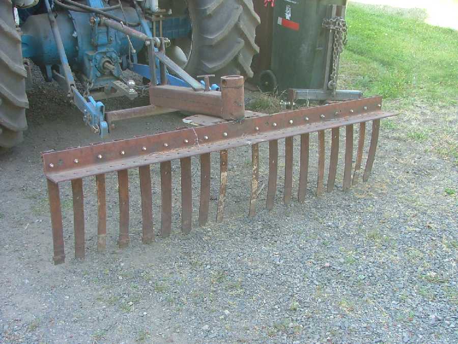

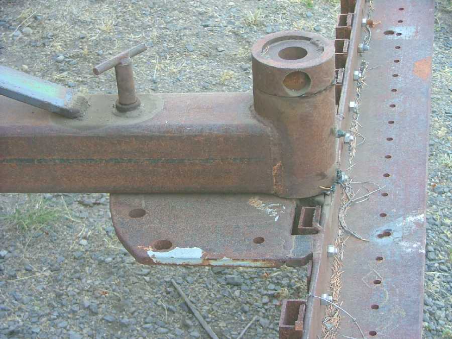

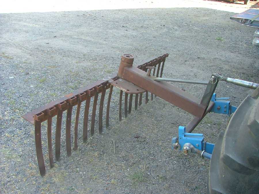

Here is a landscape rake that I constructed about 7 years ago. I was looking at the one that Big R had for sale. They were made from light metal maybe 1/8 inch.
I figured that I would have the material in my goodie pile and could make one that would stand some abuse.
I planned on purchasing the tines until I checked the price.:eek:
That was when I decided to try the car springs. I had to change the way they would be bolted to the angle iron from the horizontal leg of the angle to the vertical. Have you ever drilled 18 3/8s holes hand drill?:eek:
The springs were cut using a plasma cutter and the holes drilled on the drill press using a low speed, sharp drill and plenty of cutting oil.
The pockets at the top of the spring is to keep the spring vertical. I was not going to drill another 18 holes by hand.
The thing does work pretty well, maybe not the way that tines would have worked but for my purposes it is OK.

Any landscape rakes I've ever seen have the tines bolted to the frame and not welded.
You are correct , but a lot of the home made ones i have seen , the guy has just grabbed the welder and welded them on and they have broken off . I was simply advising of the risks to anyone reading this thread who may not have known and taken this route .
With proffesional tynes the holes are made before they are tempered . With car springs you are trying to drill through hardened spring steel , one false move and the hole will work harden and without expert help you wont get past this hard spot . I take my hat off to kcprecision for drilling those 18 holes , i bet he was ready for a beer after that .

A carbide bit will drill right through a spring. I've used concrete bits and touched them to a green wheel to sharpen the cutting edges. Use a drill press. Ease off the pressure as it breaks though the other side. Use a coolant of your choice. If you canter the bit with a hand drill, it WILL break the carbide insert. :eek: But, the concrete bits are cheap.
If you have an A/O set up, you can spot heat where you need the hole(s). Heat to yellow and let it cool. Drill with a standard bit with coolant. You don't need "spring" where the hole is anyway.
