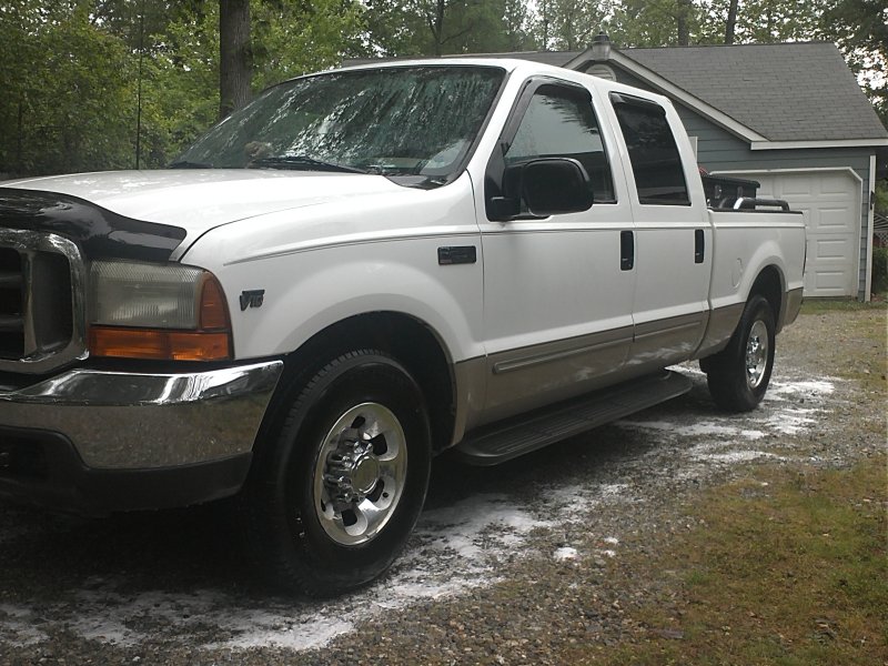

Yeah!..... I'm sure the 10 ply tires will provide enough strength for the occasional loads I will haul, things like mulch , ornamental gravel,
tree & shrub trimmings maybe cleanup debris, etc,etc, I will be changing the rear tires to more of an A/T tire, to perhaps get better traction when off pavement, actually I've been wanting for some time to replace the sissy looking wheels it currently has to a wider and stronger steel wheels, I'm not sure if it is understood that I have a super duty f-250 and is to be a stronger truck then the standard F-250 is, at least is what they told me when I purchased it in '99, and when looking underneath at it's frame and suspension it looks built like an army tank, Though I've never actually compared it to the standard f-250,:confused: here is my truck,

No difference. Salesman gave you a line. A 99 to basically current is all the ame chassis and all are branded Super Duty. There were slight mods along the way such as converting to coil springs in the front end versus leaf springs in 2005.
What you really need to do is some home work. Look at the drivers door sticker and see what the GVWR is. It will be on the vin sticker in the door jamb. They range from 8,800# to 10,000# depending on configuration and options such as snow plow prep, slide in camper prep, ect. Now go to a truck stop and weigh it. Cost $6 here. I do mine with me in it and 3/4 tank of fuel. My guess is 7,500#. Thats what my 04 was. Subtracting that from your particular GVWR will give you the payload. If its the 8,800# that only leaves you 1,300# and if its the big dog 10,000# GVWR like I had in my 04 it would be 2,500#
Now find out what a dump bed weighs. Lets say 1,000# and subtract that from your payload and thats what you can haul. You see where I am going here.

It read has front GVWR 4100 lb. rear 6084 lb. but a total GVWR of 8800 lb. so I guess I have the wimpier of the two, huh! it is but only a 2 wd,
Now again just to be clear, I'm not thinking of changing out the bed to a larger dump style bed, but only to convert it's standard truck bed to have the ability to lift / tilt and dump, so only requirement are the components to change it over, the hydraulic or electric cylinder and what ever reinforcement would have to be done, do you think these parts will weigh 1000k ?

You try to convert a standard bed to dumping for anything more than looks and it will buckle - if not worse. By the time you do all the reinforcing to make it able to be dumped it will end up weighing more than some type of standard dumping bed. Combined that with the low GVWR of this truck, I think you would be better off selling it since it is still a nice looking truck and buying something that was designed/built to do the job. Why screw up a nice looking truck that still has some value and turn it into a total pile of crap that has no value and nobody wants.

Well the value is one of the reasons i would try and do this truck as a dump, Yes its still nice and thanks for the complement, and still has under 160K on it, with the transmission rebuilt a few years ago, when Brand new this truck cost 24-k BTW noticed no zero's there Mike, ;)
and as good of care as I've taken to the ol- truck ( inside still like new ) I think because of its v-10 being tough on fuel the NADA has it only valued at around 5-k which really is disappointing to know, as we all know we never can tell what we might get or what another person has put their trucks through, or how was kept maintained, I know my truck and I know how I serviced it regularly, But is a good point made, I would'nt want to destroy it, I never thought that by adding a dump bed would be much different than having the bed as it is but only to lift and dump,....... Hmmm! ......got to contemplate over this some more,
