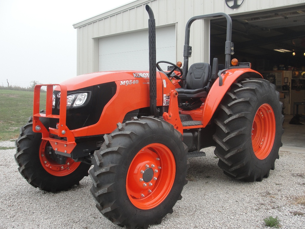

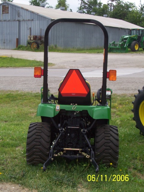

Here's a couple pics to support my opinion.
First is my M9540. Second is a SCUT. Note how much taller the ROPS is on the SCUT.
