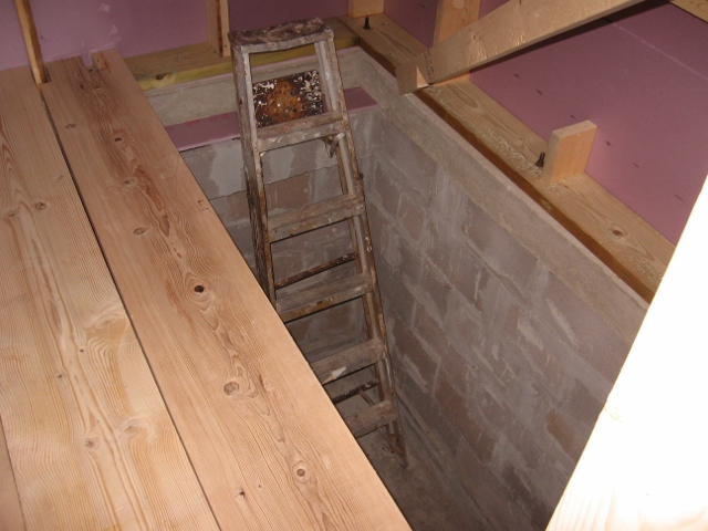

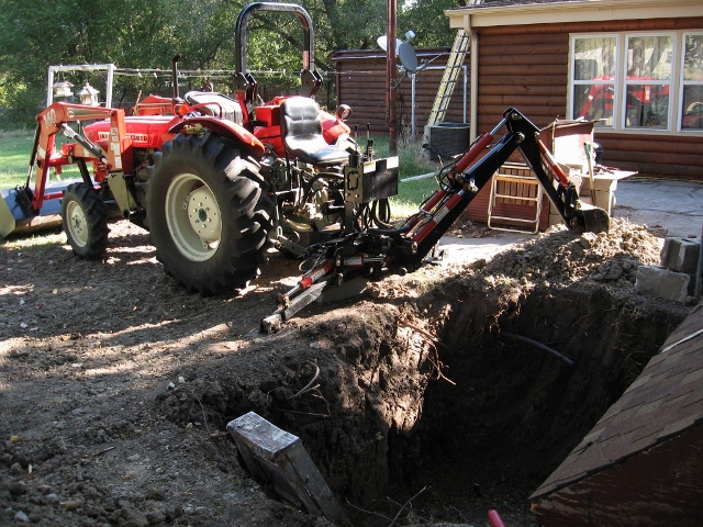

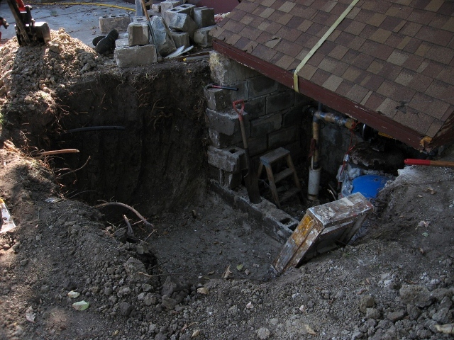

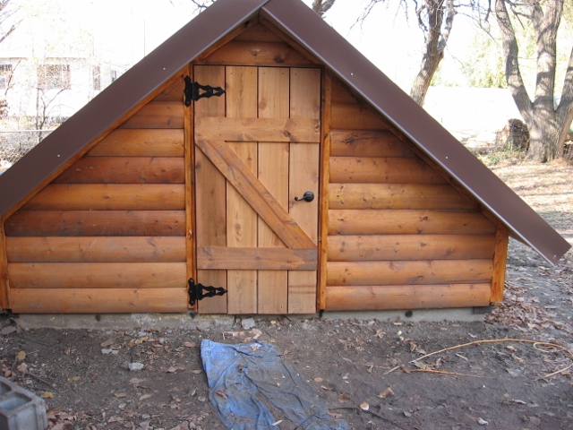

I just got done with my little basement project I dug with my cut bh been working on it every spare minute since 9-20-10. It will serve as a tornado shelter and a water well house.

car doc it look great
   / Anyone ever use a CUT mounted backhoe to dig a foundation? #31
Thanks!

Very nice job Car Doc. I would certainly feel confident using my backhoe to complete a job similar to yours, and the outcome of your project verifies that the work was well within the capabilities of a CUT backhoe. Nice job.

That was about the limit for mine.
