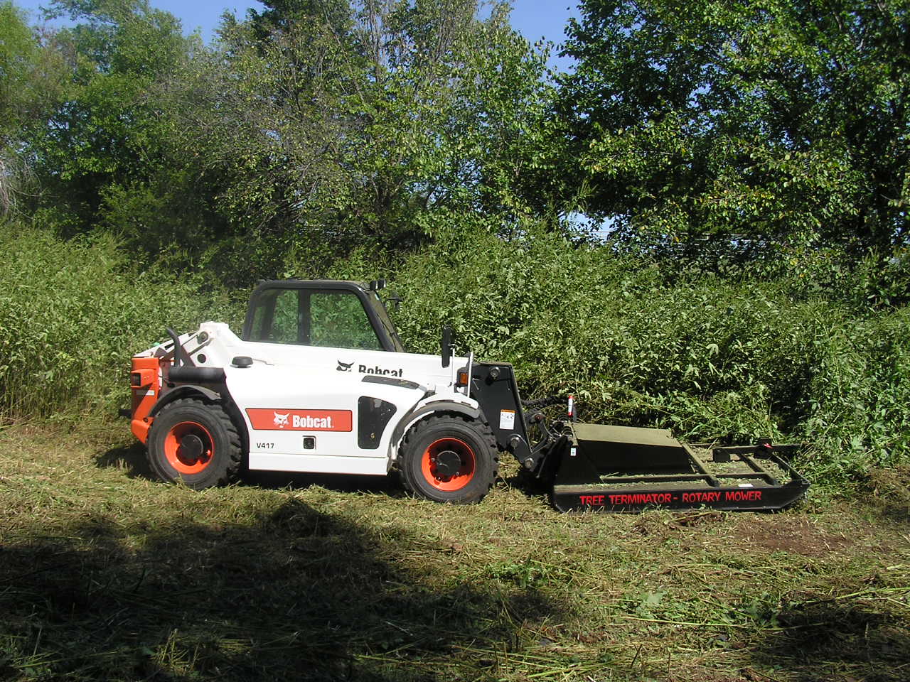

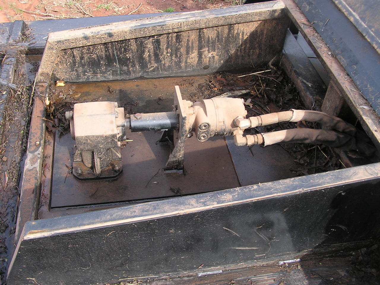

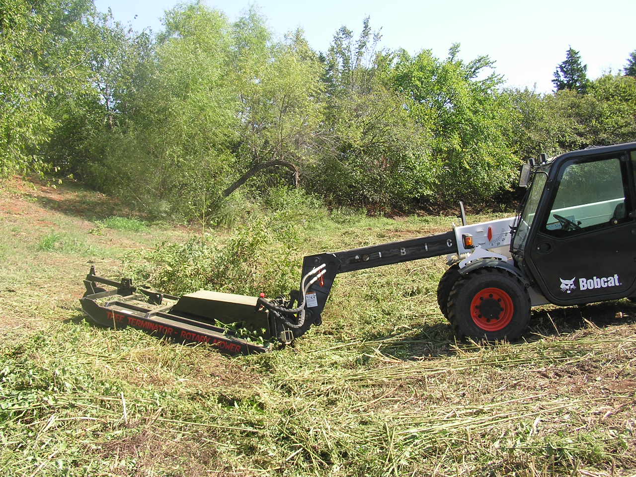

My only motor driven attachment is rated for low flow, 15 to 25 gpm, it has 3/4 inch hoses:

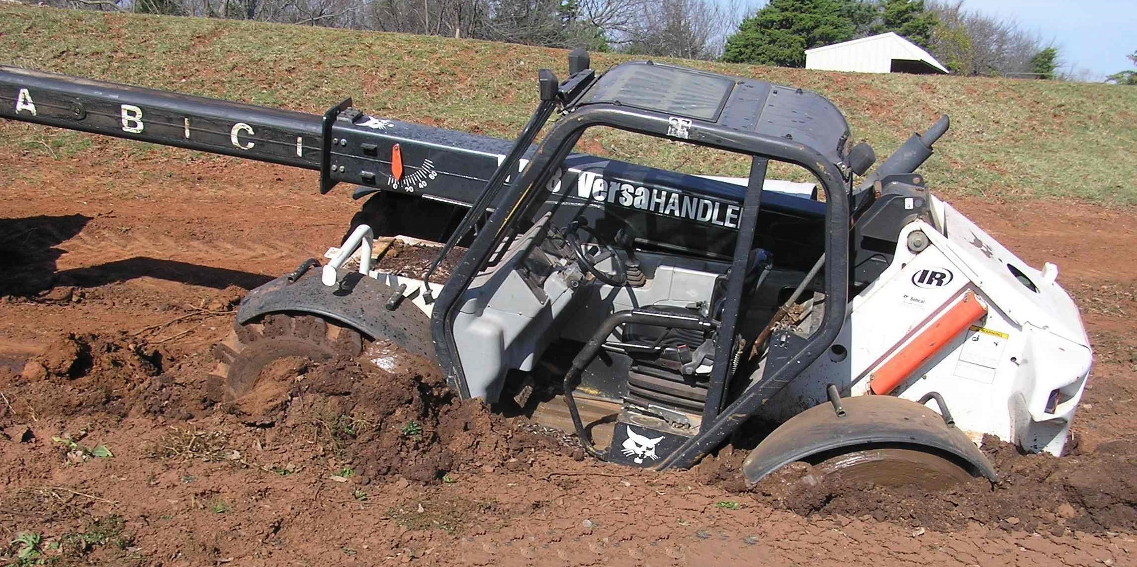

This was some 8' tall ragweed:
That little creek is mostly silt, if I drove forward 5' the wheels would sink down to the axle :eek::
Same pond, same silt, different CTH:
Get a Compact Telehandler, they are amazing.
