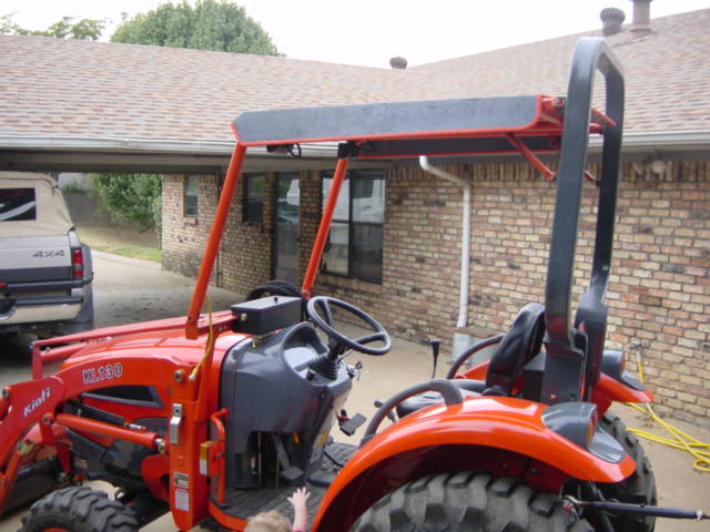

Here's how you brace the canopy.
I really like the looks of that. Did you buy the canopy or Fab it yourself?

bullebak said:
My wife always worries that this heavy sunroof might collapse one day and fall on my head (the black steel tubes alone weigh 7kg (14lbs) due to faillure of the U-bolts to the ROPS - and off course it lifts the centre of gravity increasing the risk of rollover under critical circumstances.
I was thinking of replacing the steel tubes with aluminium ones. Any comments would be appreciated.
QUOTE]
I don't think the benefit of weight savings between the aluminum and steel tubes would justify the trouble. The aluminum will need to be thicker than the steel to have same strength. If the fear is the ubolts failing, replace them with higher grade units (grade 8 or better). As far as center of gravity issue, it may be worth looking into. I have seen canopies weight 20 lbs, I have seen them weight 200 lbs. 20 lbs on a 4000lb tractor won't shift the COG anything worth mentioning. 200 could make a difference in marginal situations.
I built it myself, I've got a lot of trees to deal with.

grizer said:
Wallace tractor, sorry about mistake on braces, his worries about sun roof are approching rediculous anyway.
My wife worried more than me... but to call it rediculous isn't right. One just does not redicule a safety concern! And in the case of a rollover, who knows how the sunroof might cave in (on the driver).
SuperDuper: The sunroof support doesn't need the strength of those 2 heavy steel tubes, the roof itself is quite light.
RedRocker did it right! I'll copy his design (with permission?) as soon as I have the shed up for the tractor and some equipment installed.
