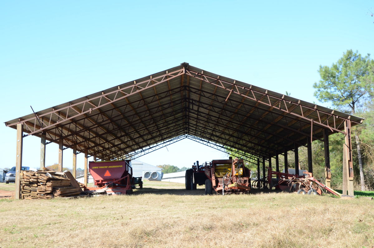

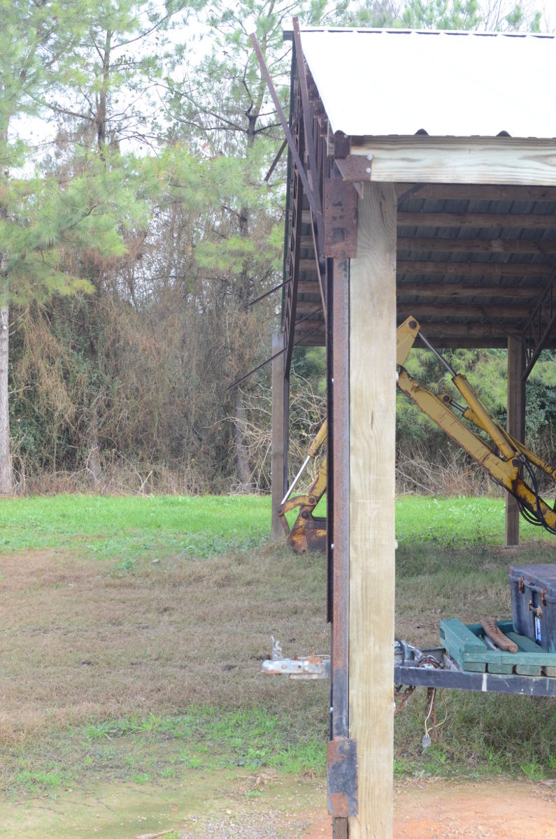

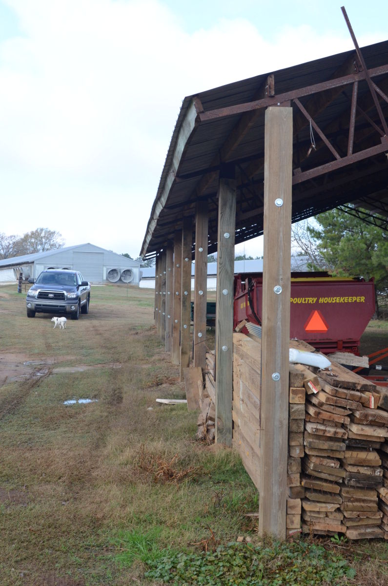

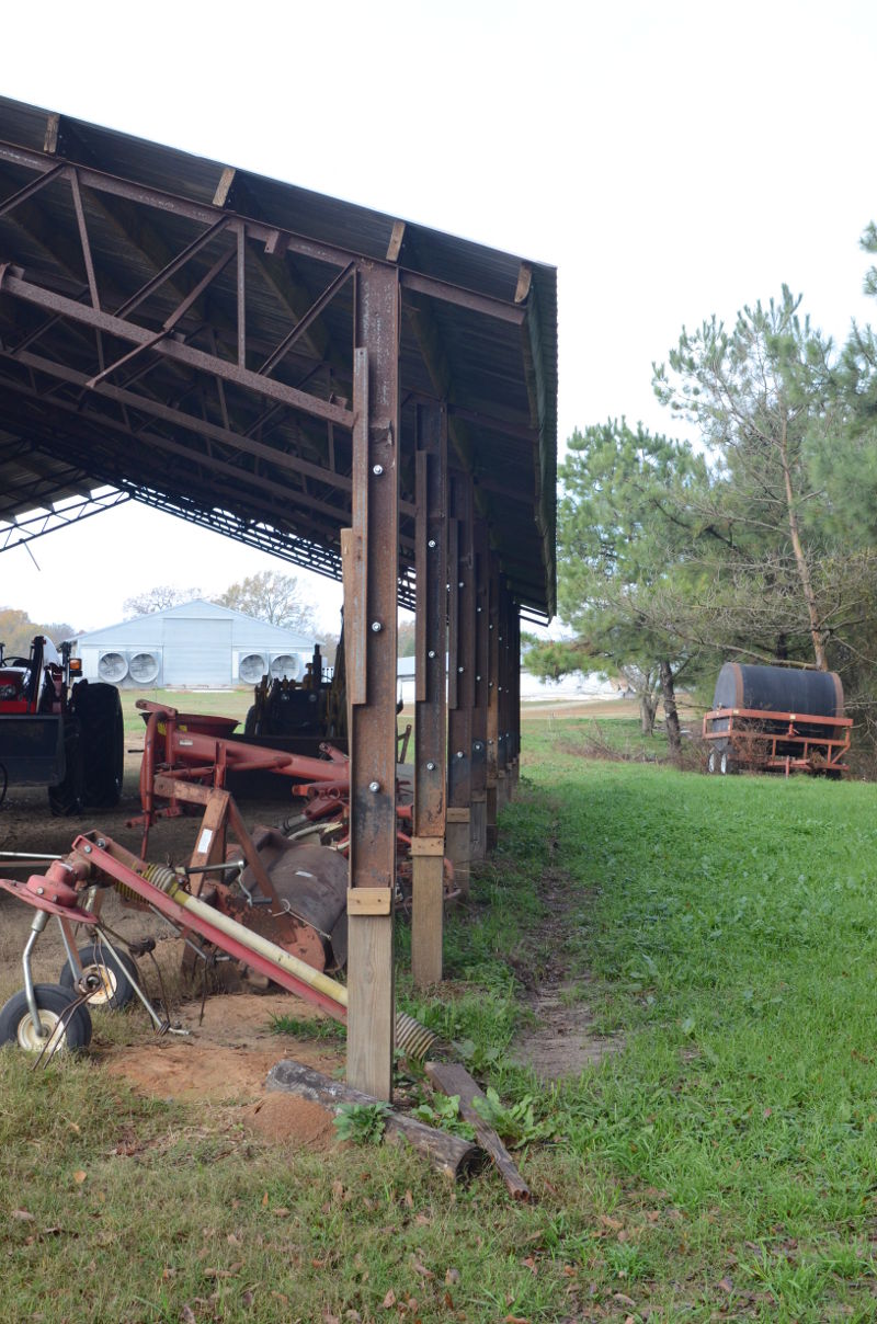

Sorry for the delay. Here are some shots of my Dad's shed. Note that the truss legs have to be mounted on opposite sides of the posts; for example, in the first pic, the near truss is mounted on the front face of the post, while the far truss is mounted on the rear face. It's because of the way his trusses were manufactured.
Also note the ground underneath his shed isn't level, but he compensated for this by simply adding a block on the face of each post, then resting each truss on the block while bolting it to the post. The blocks could be removed now, but there's no real reason to do that.
I have other photos of his shed as well, so if there's a particular view you need, let me know and I'll see if I have what you're looking for.

My Brothers barn is 40x160 and he used similar trusses. His trusses where new, not recycled. Only difference in how is is framed than those in the pics above is that his uses metal tie bars about half way down each truss to keep the trusses from collapsing under their own weight. In the pics above, I dont see whats keeping the poles from spreading and the roof from falling in on itself
