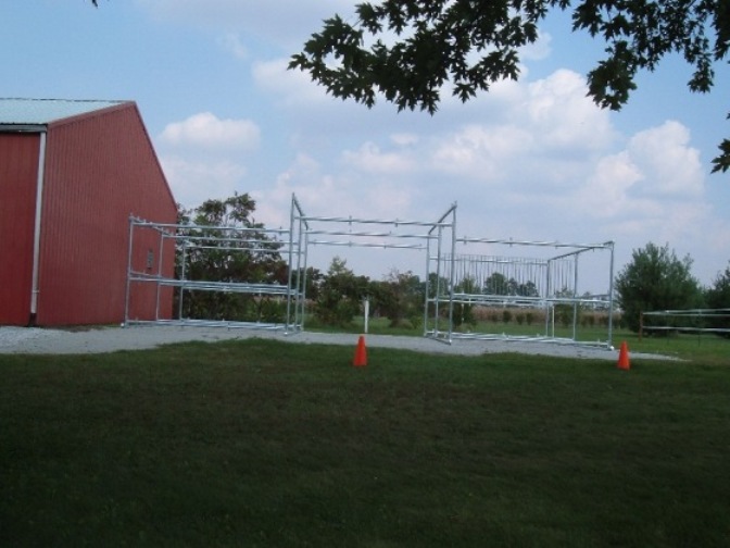

Maybe this isn't what you're talking about, but there are companies that make pipe barn kits.
