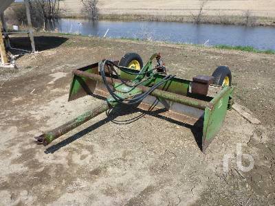

I have a an old John Deere, Killefer 8' soil mover, ;like (one can tilt it manually a turn buckle type thing),
never use the tilt feature,
have used it to move a lot of dirt and level things, If one has huge pile to move back it up on the pile and drag it down,
It can work my old John Deere 4020 (90 hp) for all it worth, at times, most of the time not, unless I am cutting and dragging a full load,
very similar to the one in the picture, I repainted mine some years back
