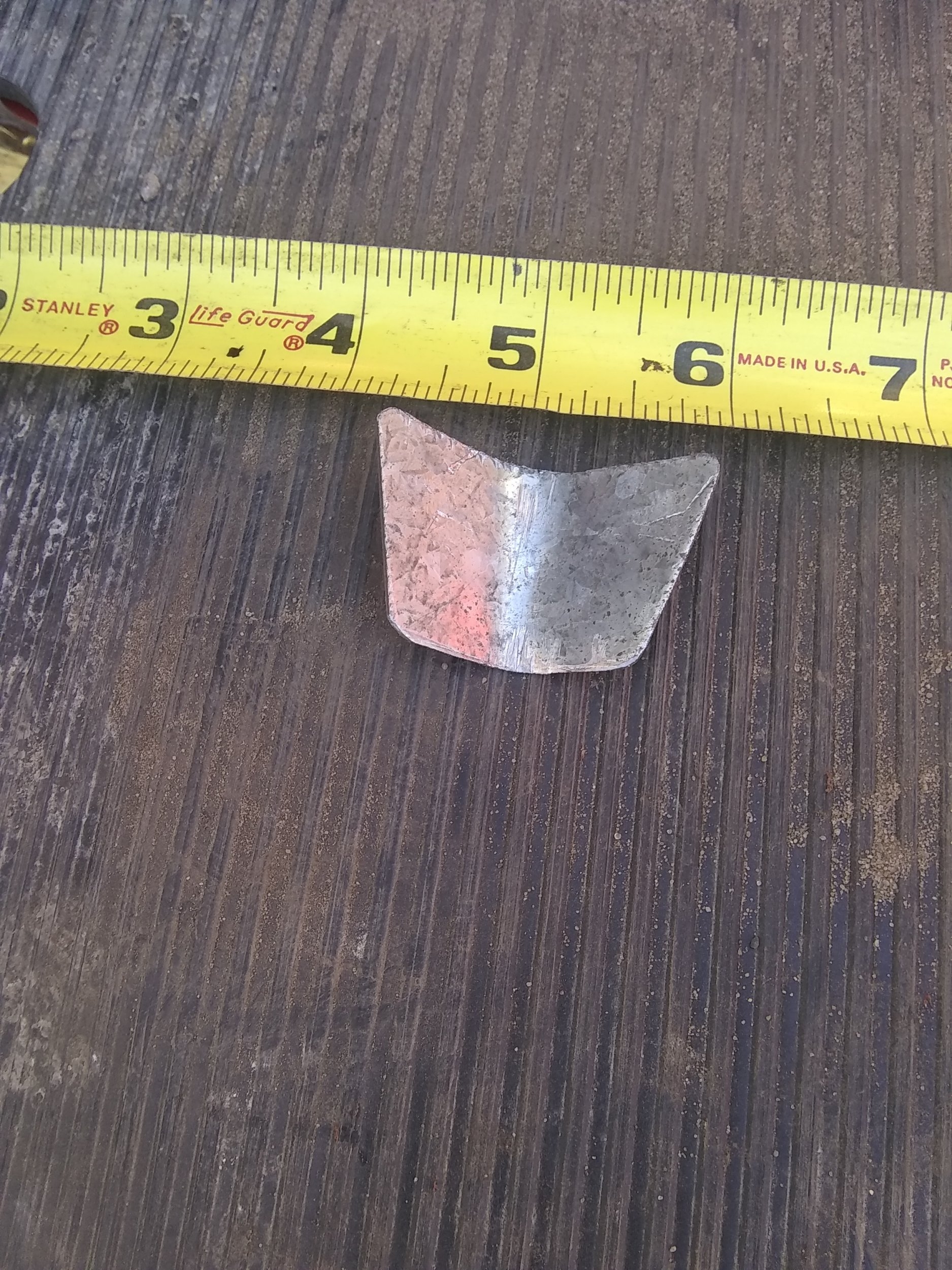

Perhaps a lip made of RTV under the drain will allow a funnel to capture the mess? I will be trying this on mine soon.
The owners manual mentions annual coolant change, and directs you to a hose, which seems to only drain the radiator. Draining the block seems to require removal of a plug on the side of a block, but it's definitely a messy process as the coolant runs down the block, axle, frame, and everything else in the vicinity.
Is there a better way to do this?
GC1705
I RTV'd a sheet metal lip under the drain plug that's just big enough to accommodate a funnel.
