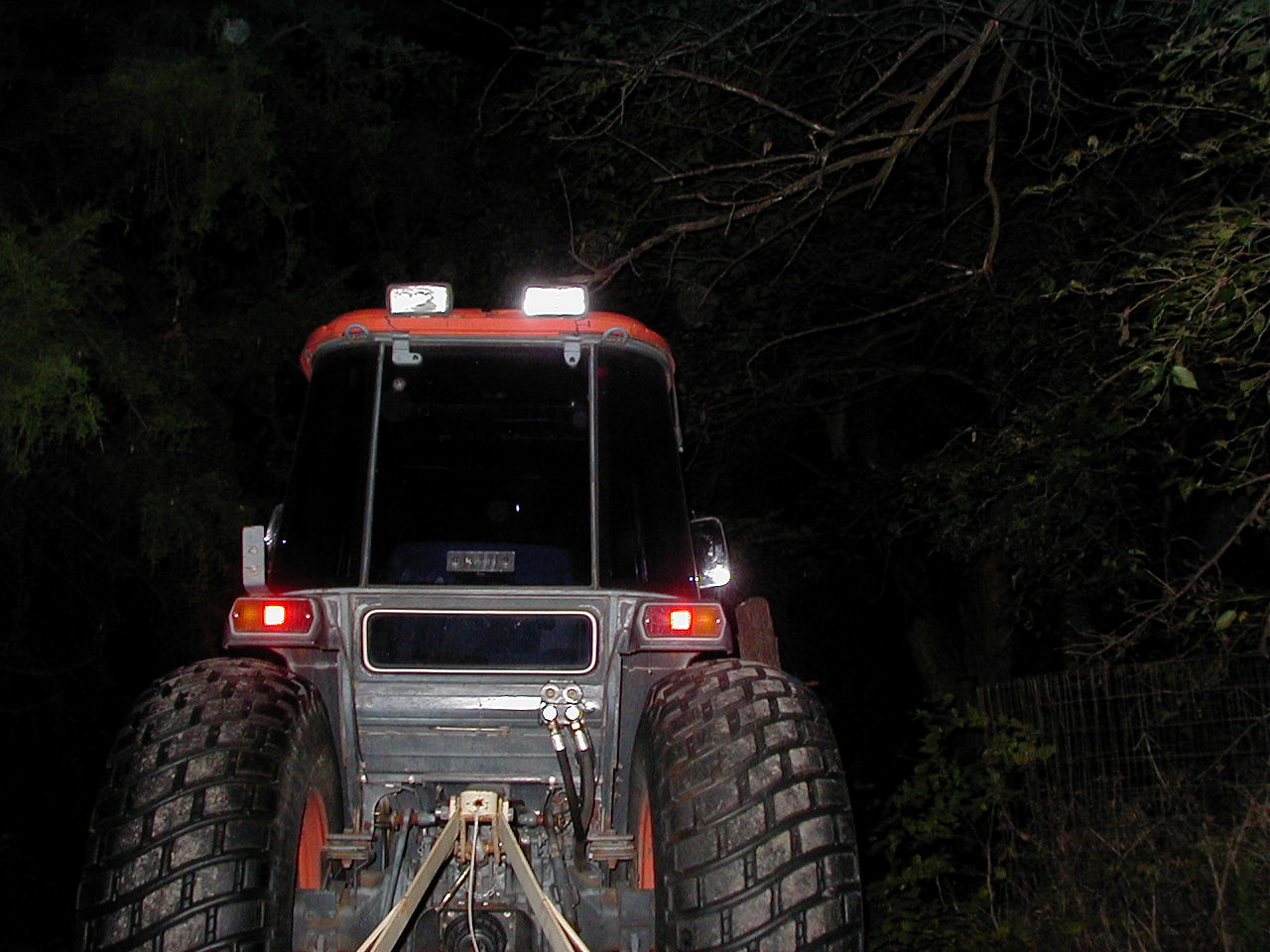

Like these?...
They are 55 watt quartz flood pick them or at about any auto parts place. Even Wal Mart has them around $20 easy install my Grand L4200 had wiring already in the roof of the cab, I just picked up another Kubota lighted pushbutton switch like the one for the front work lights. KennyV.

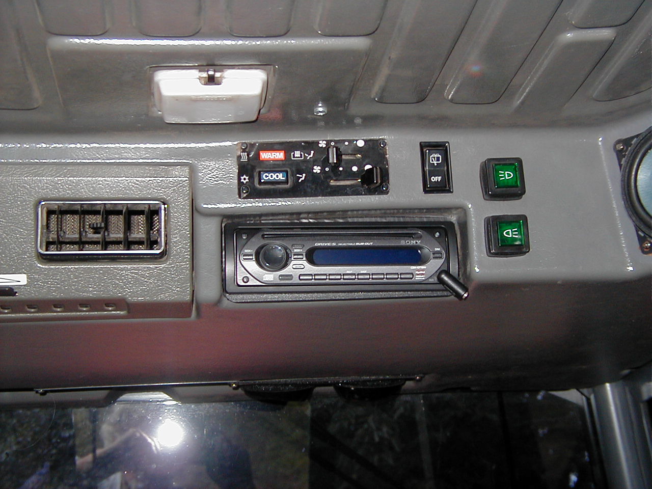

Is there wiring under the headliner and just tucked away? all I need to do it plug and play?
   / Anyone have a DIY rear light on a Cabbed Grand L? #6
I installed a pair of rear lights high on my cab... the roof is relatively easy to remove, just a few bolts. It is light but best to have an extra hand to take it off and replace it... just because it is large and difficult to handle. There ARE wires in the headliner... i didn't find a real simple plug where I could just "plug and play" but using a voltmeter I was able to find 12 Volts available and install a separate switch in one of the blank spots next to the other controls.
Recommendation.... don't do like I did... I installed two lights that have a point beam... wish I had installed a couple that were more of a broad beam. However, they work and are just the ticket when it's dark and you need to see back there.

The factory wiring was under the outer covering. Also the fused power line was already ran from the fuse panel to the location to the right of the radio. All I had to do is pick up the square green pushbutton switch shown in the attached photo. There is another set of wires going to the rear, I assume they are for the rear windshield wiper option that I do not have. KennyV.

I installed the Kubota OEM rear lights on my 5030HSTC.
The switch and lights are plug and play, but I had to call my wrench to find the wires in the rear.
Like Tx John said, you lift the cab lid, and install the switch; it just snaps into an open slot, and there is a plug connector ready for it right there.
The wiring at the rear is not intuitive. It concealed in black electrical tape and taped to the rear flasher bracket. If you did not know it was there, you would not unwind the tape to find it.
