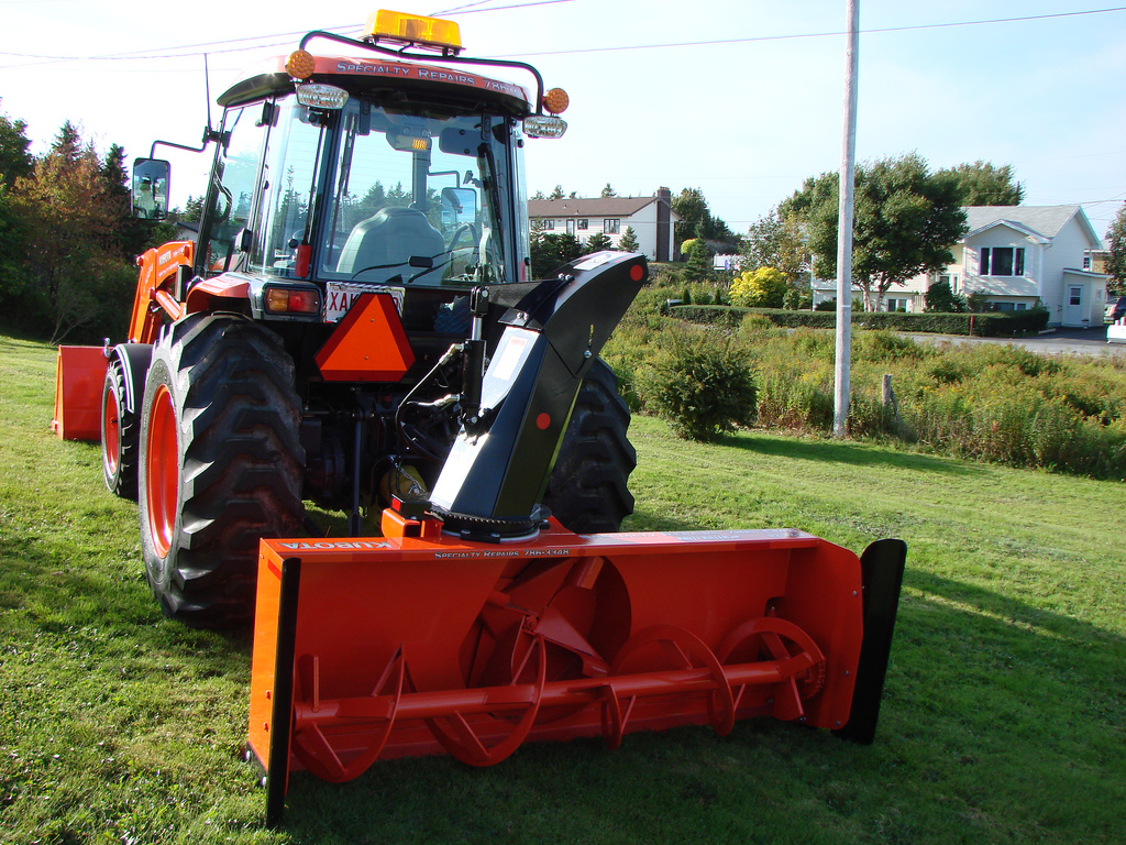

I thought the rear lights on my 08 Grand L 4240 was one of it's strong points and I would have thought all Grand cab models came with factory rear lights. Must just be a Canadian thing :rolleyes:
