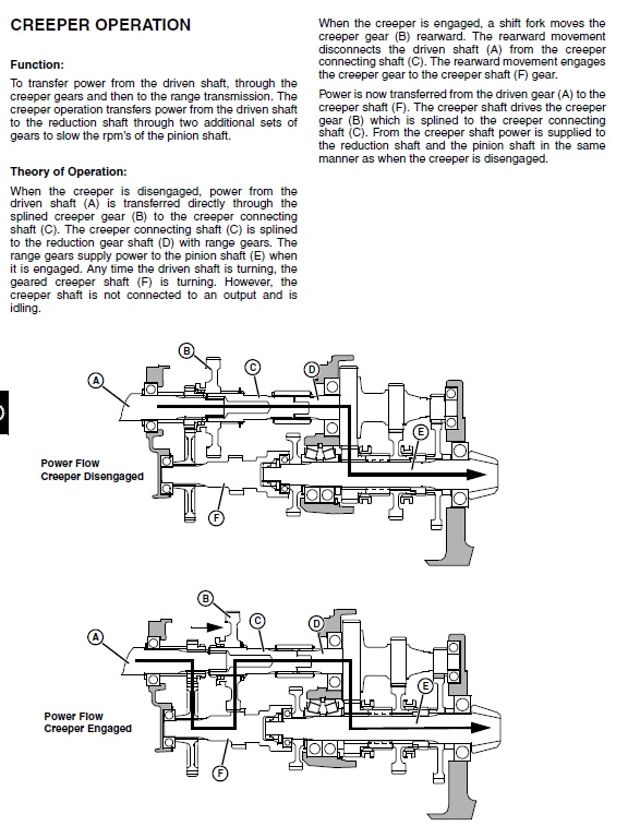

Here is a schematic of the operation of the creeper gear.. so if you can figure out if it is in the tranny, and how to move it with your lever, you may have success..

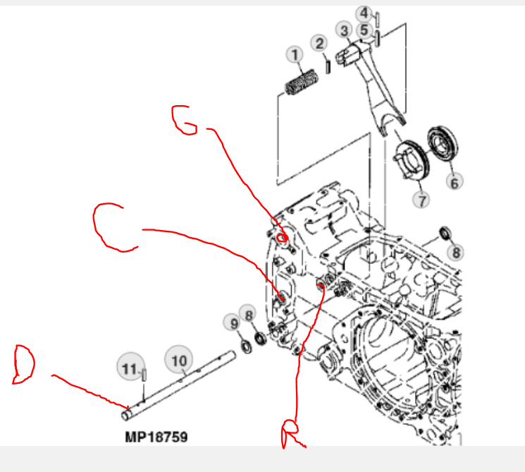

Maybe this will help. This is the transmission case, left side. D = Differential Lock. G = Gear shift. R = Range shift. C = Creeper shift

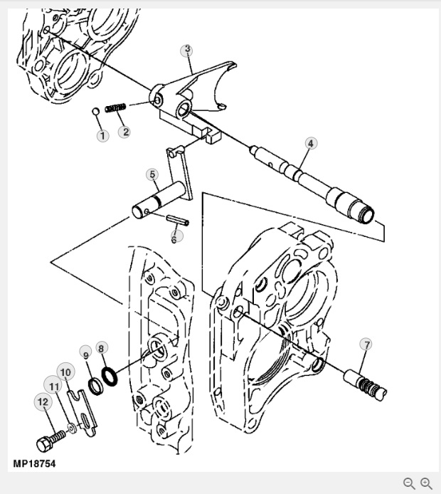

Can add to Zeb's post, the creeper shift mechanism..

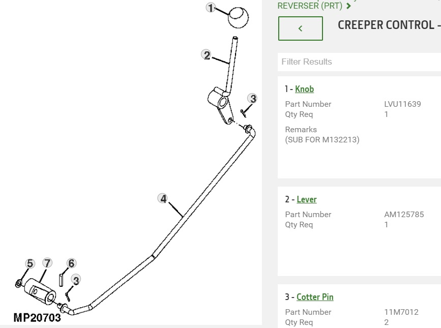

And the creeper control shifter . Hoping the OP is getting some help from this. Maybe we'll hear back.

Great!!! Thanks guys. I'll compare to my trans tomorrow and report back
Thanks. It doesnt appear the creeper is in there.

Do you have just the shaft coming out of the transmission case? Or also the linkage and lever?
