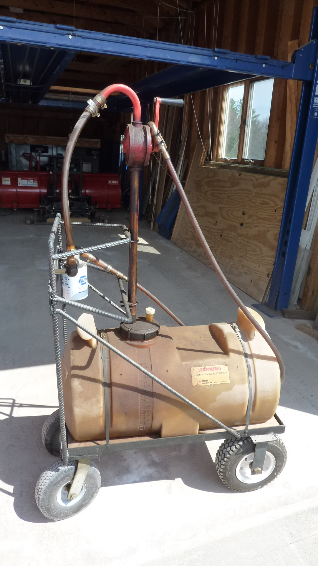

I made a cart to hold a 26 gal poly tank with a hand pump.
It isn't pretty but it's very functional. I roll it up a ramp to load on a trailer and wheel it around to fuel wherever it's needed.

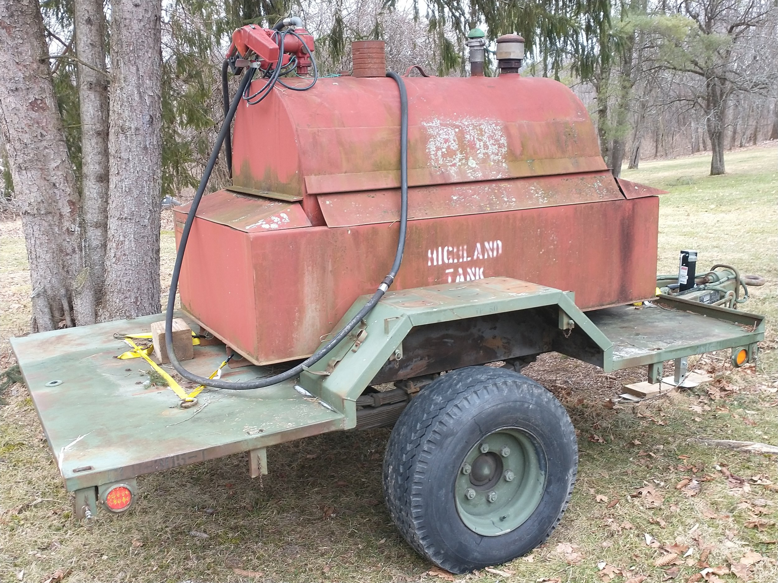

Mine is a bit bigger then you mentioned, 300 gallon on a trailer, 12 volt pump.
