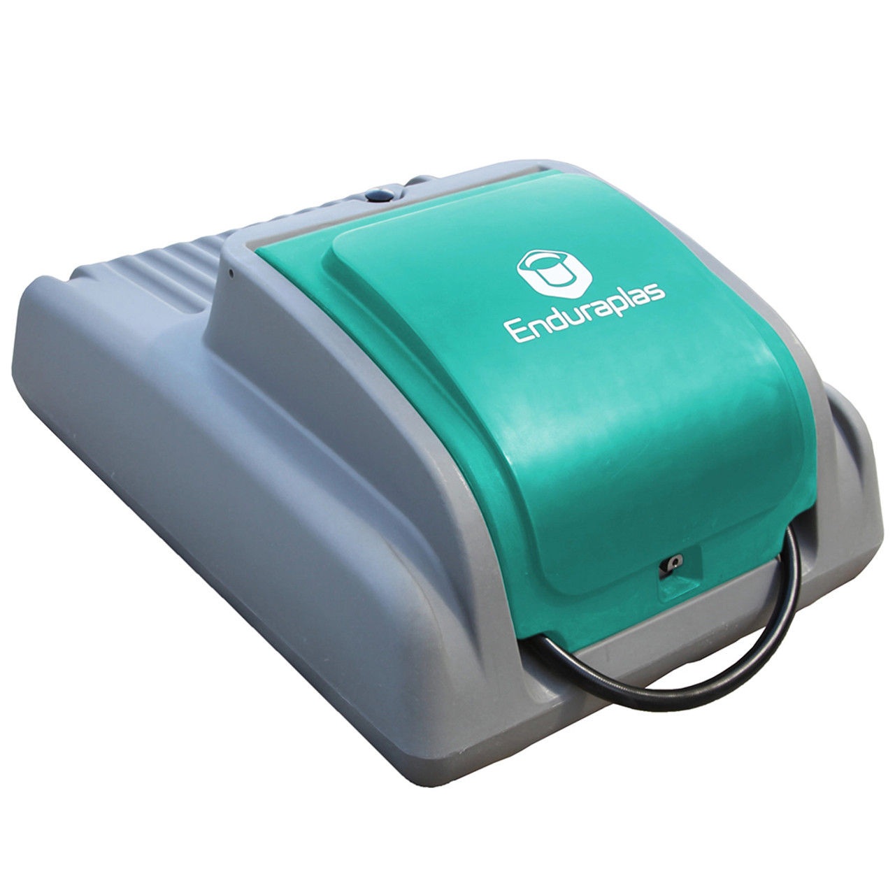

I went with one of these as a solution that is the best I could find for my use case. I got the 58-gallon version and built a pallet for it. It was also $100 less a month ago.

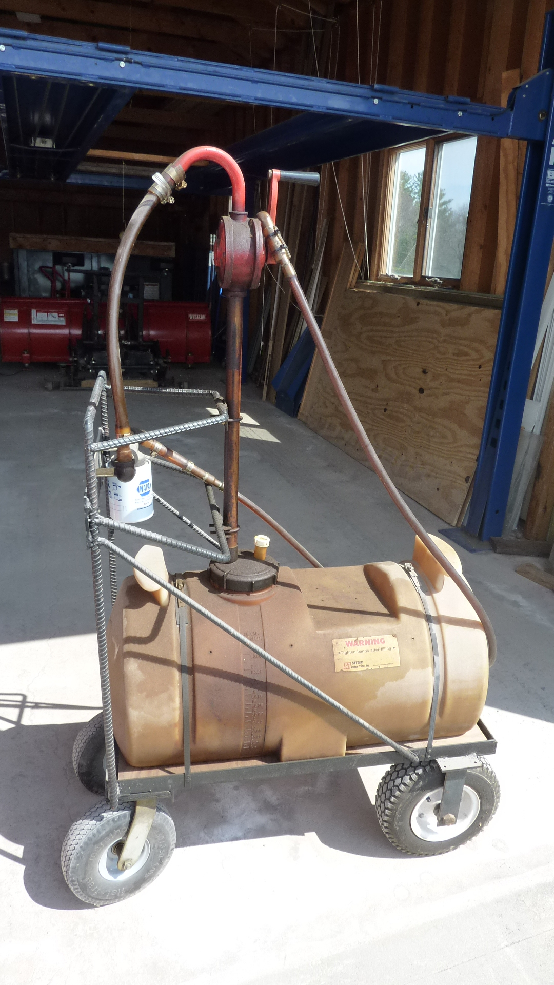

I made a cart to hold a 26 gal poly tank with a hand pump.
It isn't pretty but it's very functional. I roll it up a ramp to load on a trailer and wheel it around to fuel wherever it's needed.
If that sprayer tank has a bottom drain like mine I wouldn't trust it for holding diesel. I'd use a steel or HDPE oil drum.
No Drain. It's had diesel in it for over 15 years with no leakage.
I built it from junk I had laying around so it doesn't owe me anything. I really didn't expect it to last this long but I still use it.
I could have used a small steel drum but I want tp keep the center of gravity low to make it more stable while rolling around. It would be too difficult to rig a hand pump to a drum laying on it's side without cutting & welding. There is also the possibility of leakage around the bungs as well as the difficulty in refilling.
The old sprayer tank I had seemed like the easiest build.

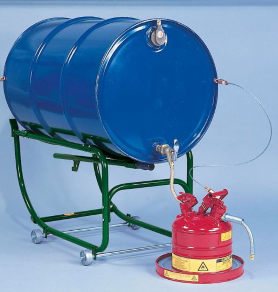

I use 55 gallon drums, there are a number of manual and electric pumps already on the market that thread right in the large bung.
Or you can build or buy a cradle and valve that threads into the small hole and lay if over so gravity does the work.
That’s about as cheap and simple as it gets.

Pretty when it's all clean and dry, but all I see is a dirt and grit magnet and multiple sources of garbage to get into a fuel system.
And your still lugging cans of fuel around and how are you going to get your drum refilled?
   / Anyone have a portable fuel tank for carrying to jobsites/fields etc? #20
Those roller drum cradles are designed to pivot upright to refill.
They don't roll very well over rough surfaces though and there is no easy way to attach a pump when the drum is horizontal.
