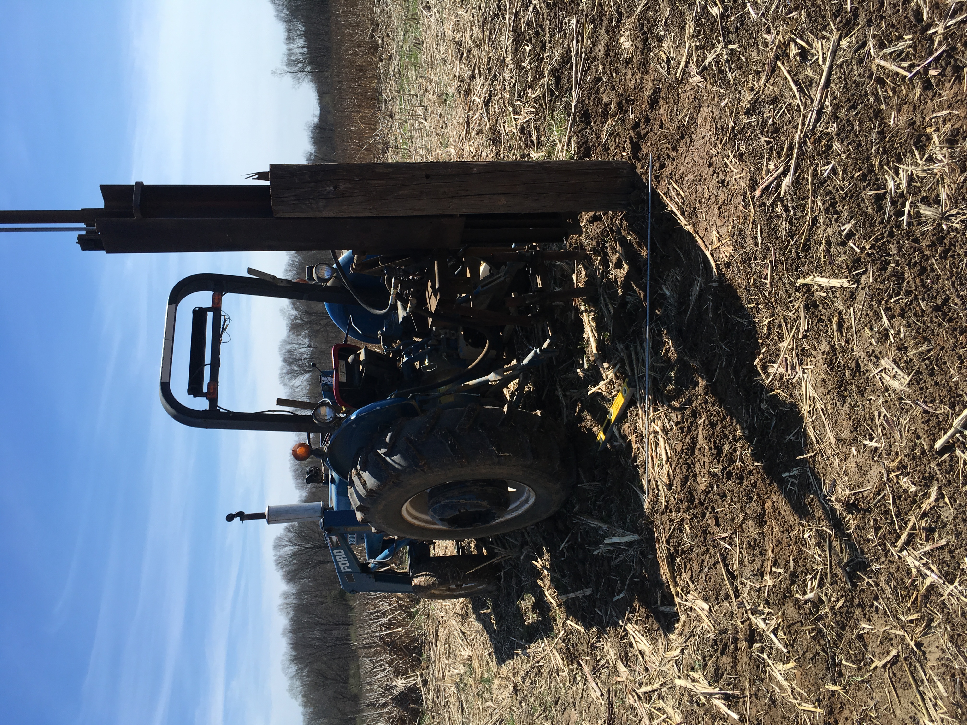

I've got an old Shaver HD8 that works pretty well, it would be nice to have some of the more modern safety items and I could see where the hydraulic adjustments would be nice rather than the screw cranks. But the screw crank adjustments aren't horrible to work with either.
Two days ago I put in a few posts for a new pasture I'm fencing off, this is a 9" post at the small end and I put it 3' deep. I did sharpen a point on the end as it is a big post, the ground was plowed about 10" deep a month ago. As always the usual first 12" is easy, I will add the wetter the ground the better and it will still be solid.
