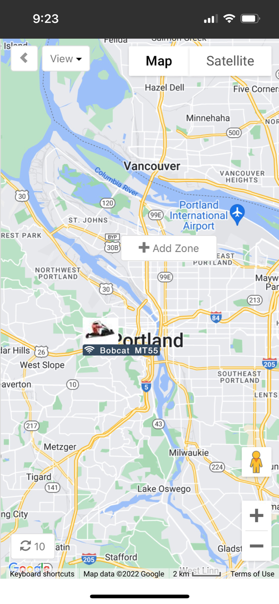

I went with this
under $50 upfront $87 or so for the year, has internal battery good for 18 months trickle charges from my tractors 12 volt system. I installed under a console on the tractor so it is undetectable and works if someone removes the tractor battery. the service has geo fencing and alerts me when my tractor leaves the zone i drew on the app. this unit uses GPS and cell tower triangulation if GPS is blocked and will save position data until it comes back into cell range if it loses cell coverage. the unit reports local temp and battery charge.
