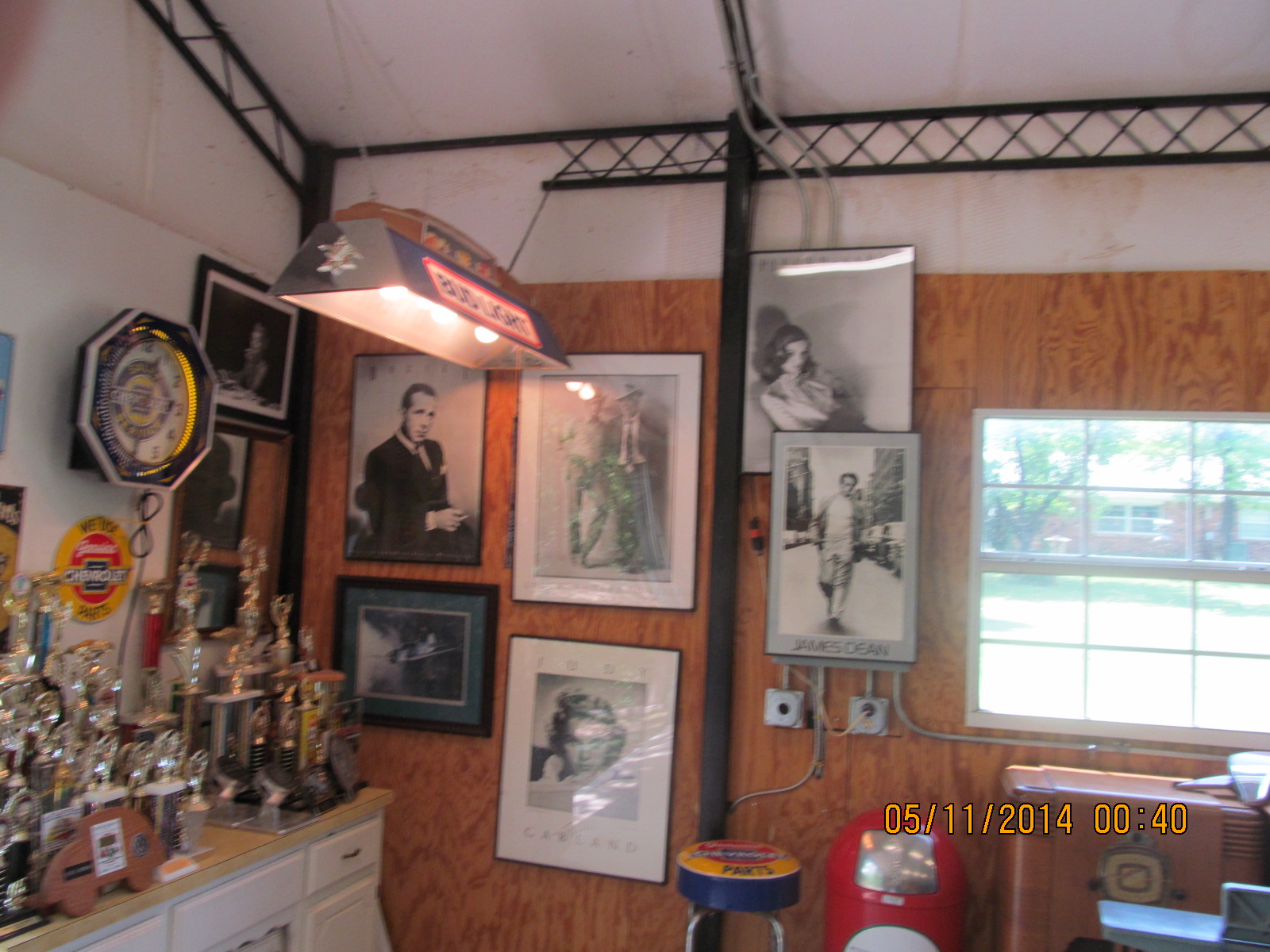

I have a 24X32 that I have had for nearly 20 years. I was told it would withstand 85 mph winds, but when you look at the framing you wonder. So far, so good. I love it; cost me about 17k with slab, insulation and electrical.
