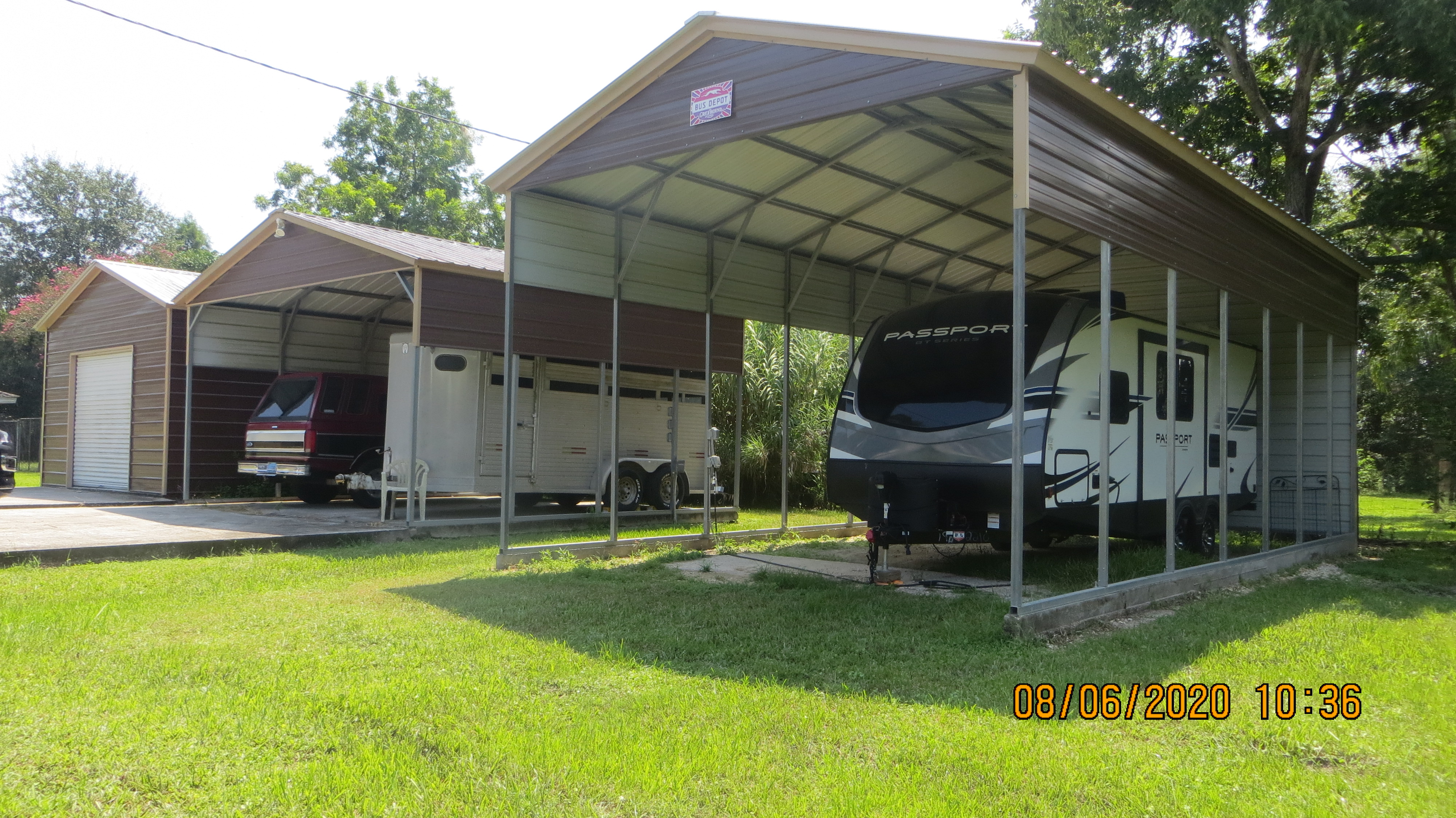

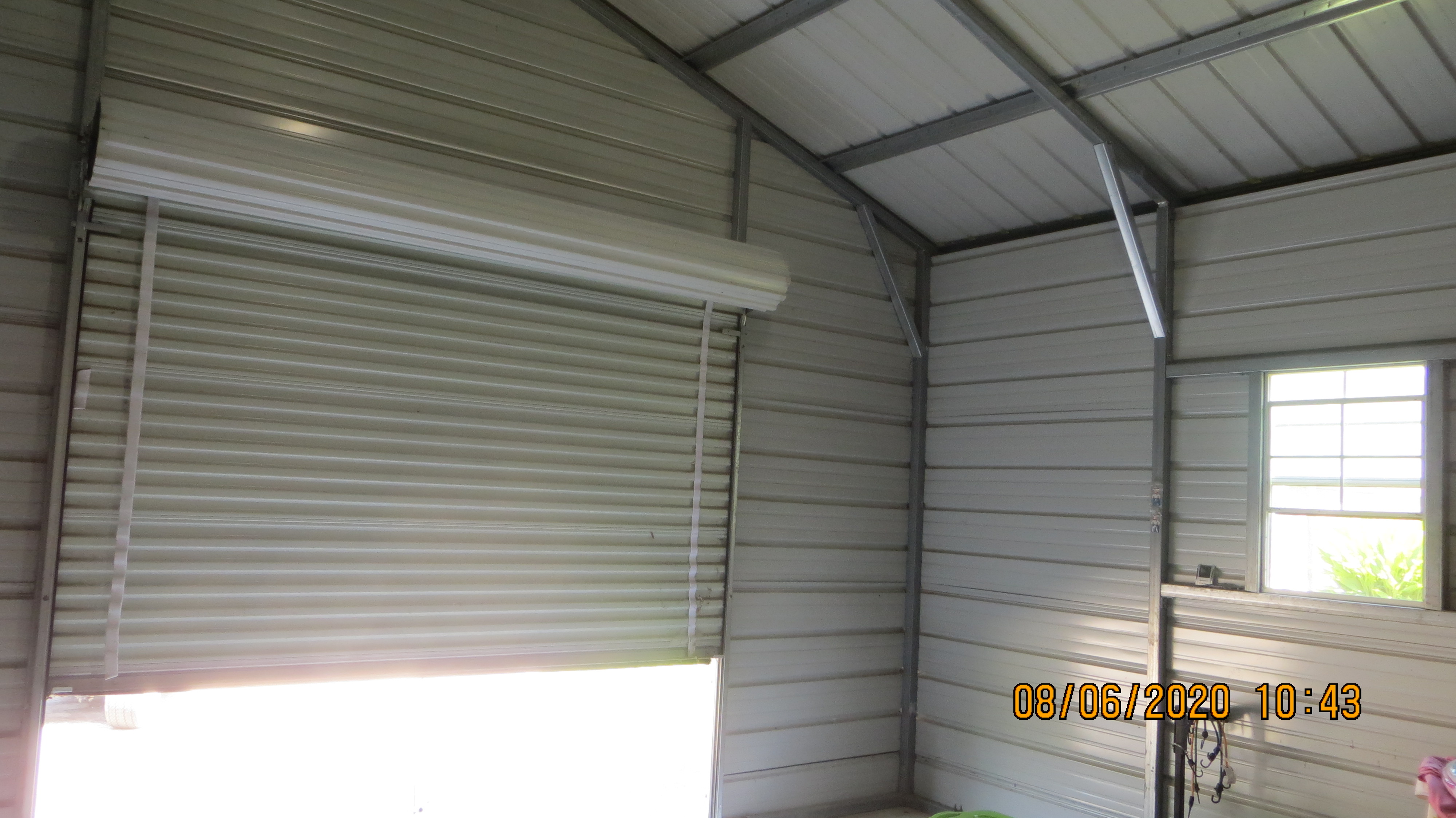

I have a 24X32 that I have had for nearly 20 years. I was told it would withstand 85 mph winds, but when you look at the framing you wonder. So far, so good. I love it; cost me about 17k with slab, insulation and electrical.
View attachment 665320 View attachment 665321 View attachment 665322
Carolina Carports claims their construction is certified to 170 MPH winds with the 12 gauge framing.
I have a cheaper version carport of similar construction that I bought in 99. Pretty sure it has a lighter gauge frame but I never measured the frame or panel thickness. It is anchored with 4 pieces of 5/8" rebar with one end bent and hammered down on the base which is only black angle on that shed. Not a spec of rust anywhere and it has sat there through multiple CAT3 hurricanes. That is what convinced me to go steel on the barn.

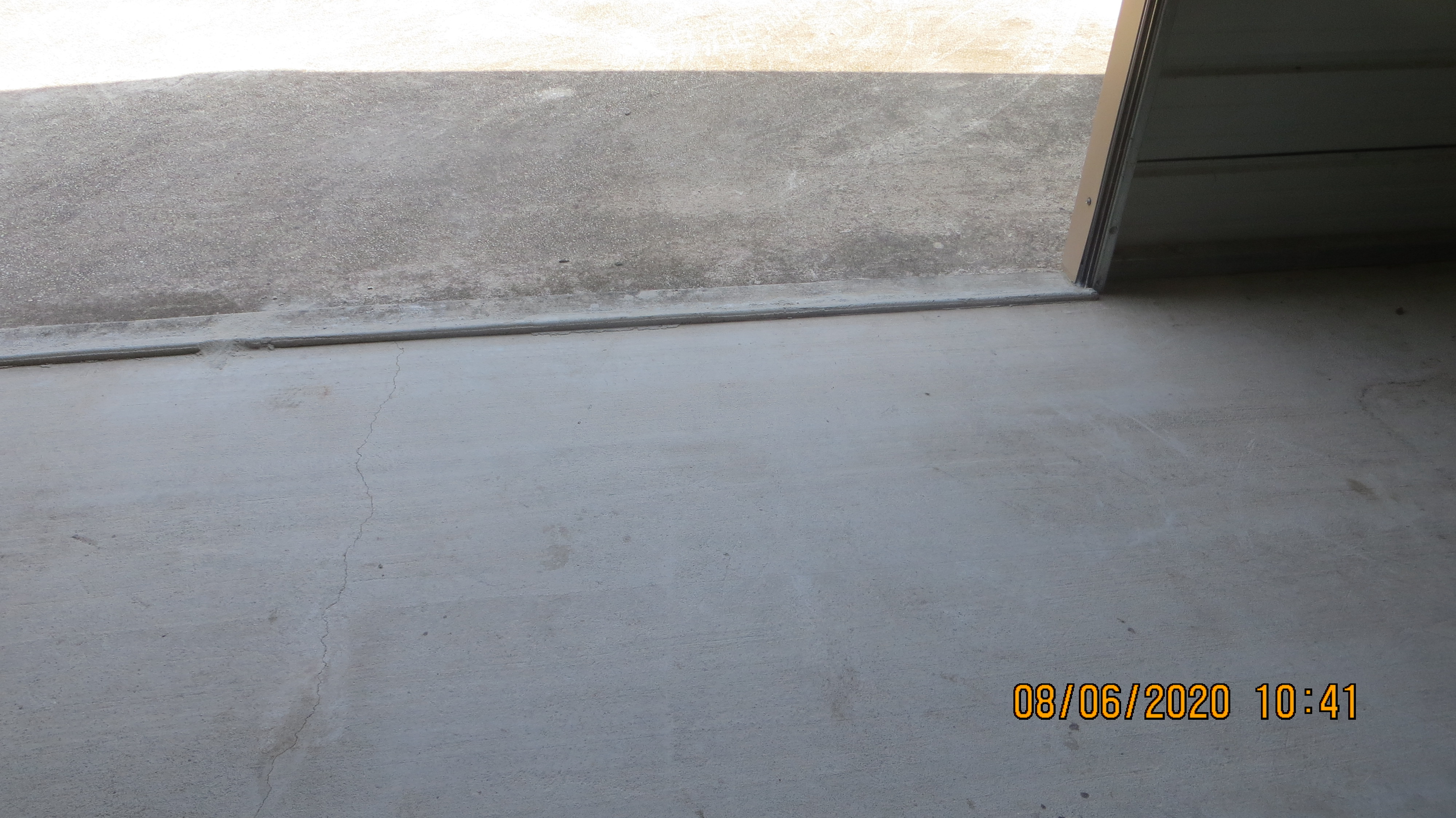

I have 3 of these buildings and have had no major problems with them and they have gone through some minor hurricanes with no damage.
It is imperative to have your slab absolutely square and with the correct dimensions in order for the building to be built properly.
The only problem I had was that in our heavy, blowing rains, water would come under the roll-up door. I had to build a barrier to keep the water out.
