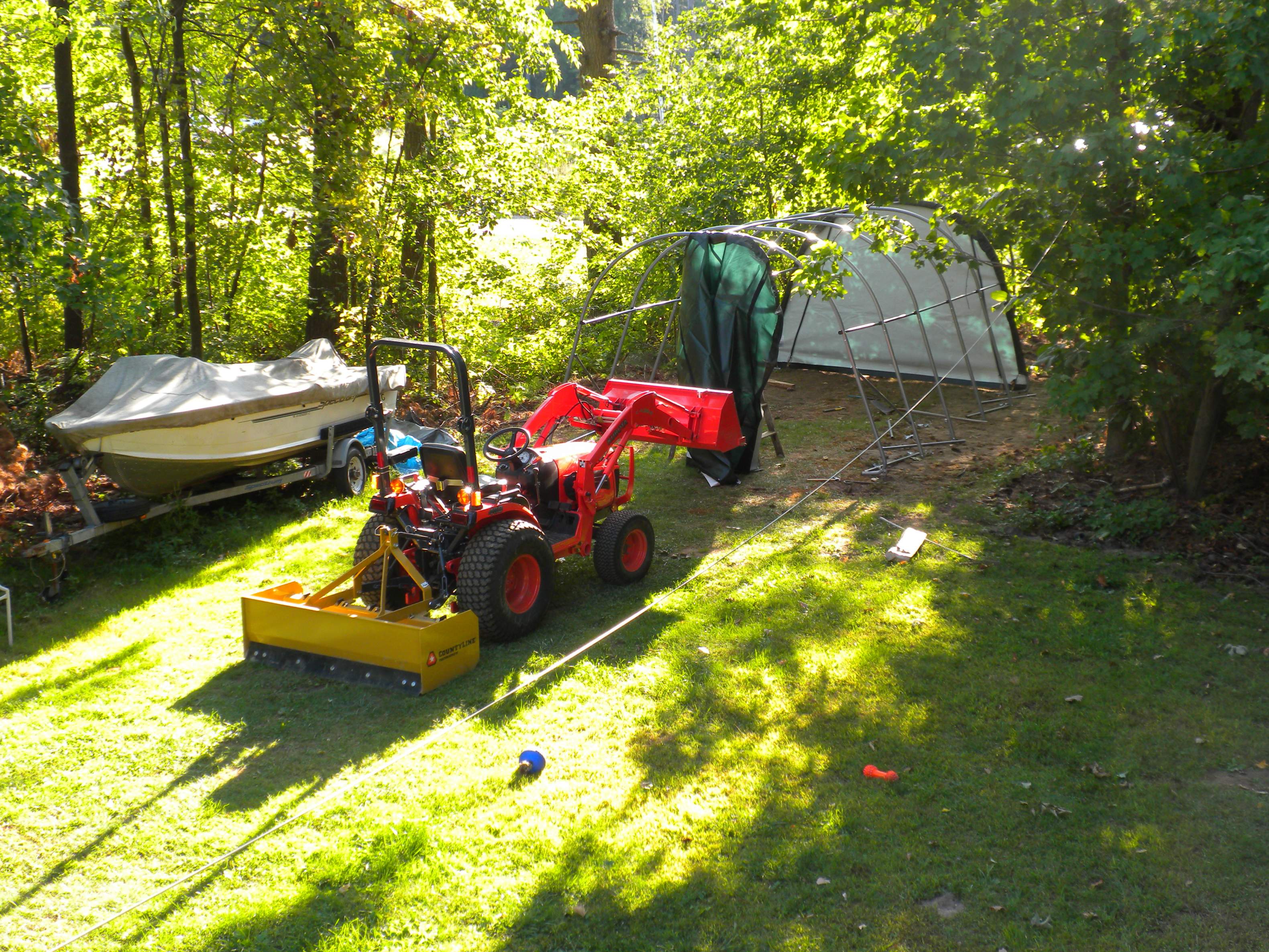

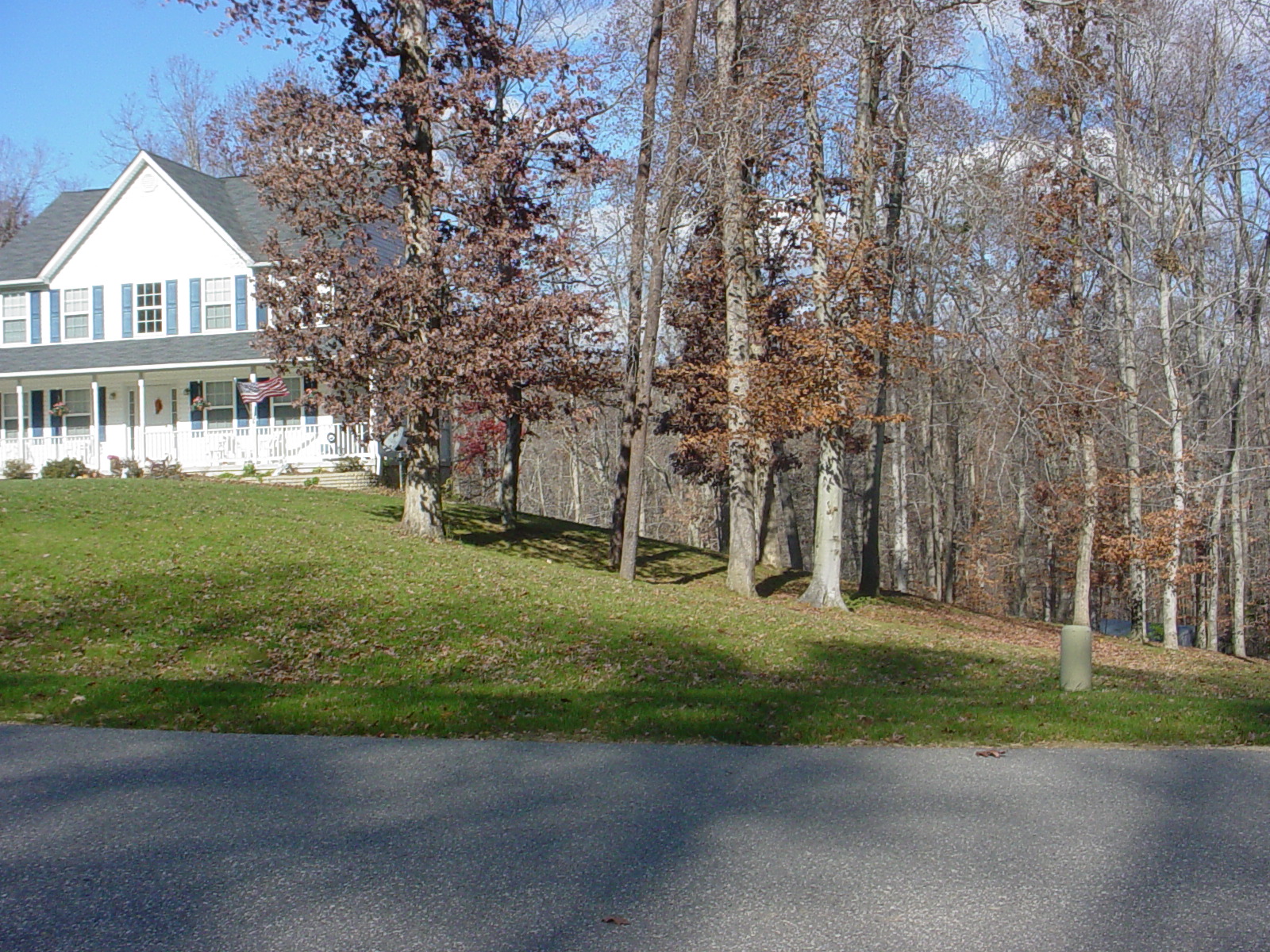

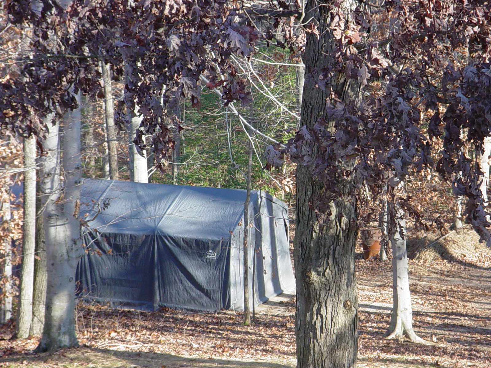

Lt Cheng - on my third year - SL 12x24x8 - and it is still in great shape. We got hit with lots of heavy snow last year - but mine fared much better than Birdmayon - pretty much unscathed. I did not stay ahead of it during the snow, but got to it within few hours afterward - at one point it had over 12 inches. Push broom from the inside and it slid off with a some effort. There is some wear in places where the "tarp" contacts the frame - some thinning - but still completely intact - no rips/tears.
That said - I think where you locate it is key - mine is down a steep slope, in the woods, under heavy tree canopy (3rd pic, bottom right) - so even heavy gusts of wind haven't bothered it. If it was in the front yard, it would probably be gone by now. I only have the 4 "temporary" anchors that came with the kit (the good ones cost extra) and they haven't budged.
One member on here, Timber (I think) did a video on his install a few years ago. He put 4x4 posts in the ground (on the inside -2 on each side) and attached the steel poles to them. He also added webbing (rope or straps)between the "rafters" to help support snow load. I had intended to do this - but since snow/wind hasn't been a factor for me yet - never got to it. I did put self-tapping screws in everywhere the poles connect - this made the frame much sturdier. And I did buy foam pipe insulation to put on the stress points where the tarp contacts the frame - but never got to it either...:D
Another note - moisture buildup. Bare ground inside can make it like a greenhouse when its all closed up. I put a large tarp, doubled up, on the floor - 4 cinder blocks in each corner to hold it in place when driving on it - has worked pretty well. I figured to put rubber stall mats over the tarp, but they are expensive, and haven't needed them. SL sells a vent kit - but didn't like the price, or the idea of cutting the tarp to install it
SL also sells a door kit - think it is $40+ . I basically copied the design (pic 4) with a clothesline, small pulleys and S-hooks (<$10)
Hope this helps!
