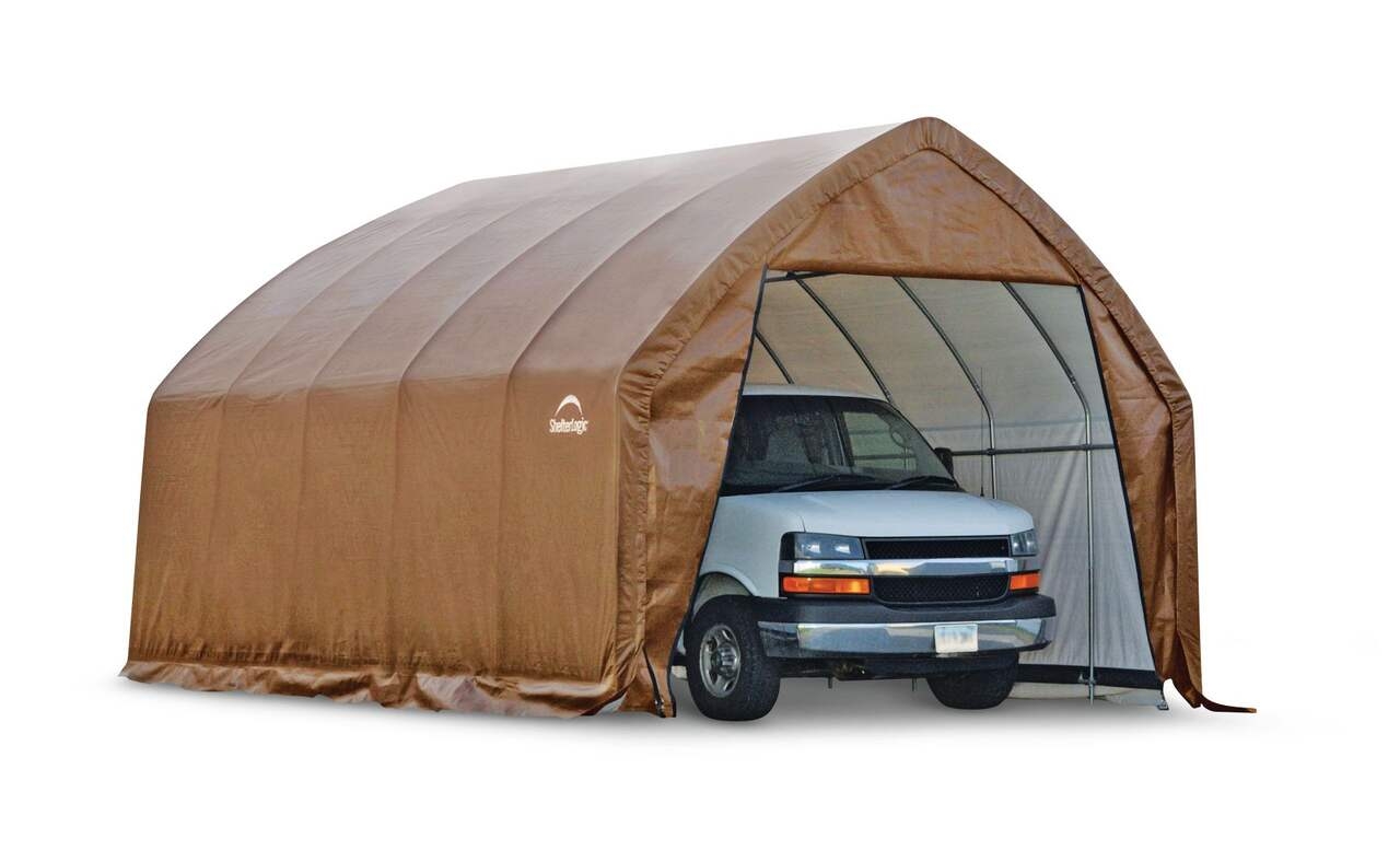

I started with one of these for the tractor and its had a good size cedar tree top that snapped off in the wind fall on it, and while the cover got a few tears, the structure survived fine. This profile sheds snow very well and as long as you don't want to use the doors these silly things seem to last as long as you add some decent anchoring(3.5' t posts hammered into ground level and an angle works well) to hold down the tarp along the tensioning bar along the bottom. I have the south facing door permanently closed and the north facing open and now it stores 12 4x5 round bales every year. The replacement cover is getting about due for a replacement, but has lasted 8 years so far. It's fairly well sheltered from the wind as long as the cedar trees hold up... But has survived some serious storms. If you want the cover to last and don't care about looks, you can buy a huge cheap tarp on sale, fold it in half and put it over the proper cover just to eat UV rays for a few years.
shelter-logic-13x20x12-garage-in-a-box-suv-truck-e0bdd5a9-78fe-4404-9989-728497f79fad-jpgrendi...jpg
I'd say you done pretty good with one that has lasted strong for 8 years!
