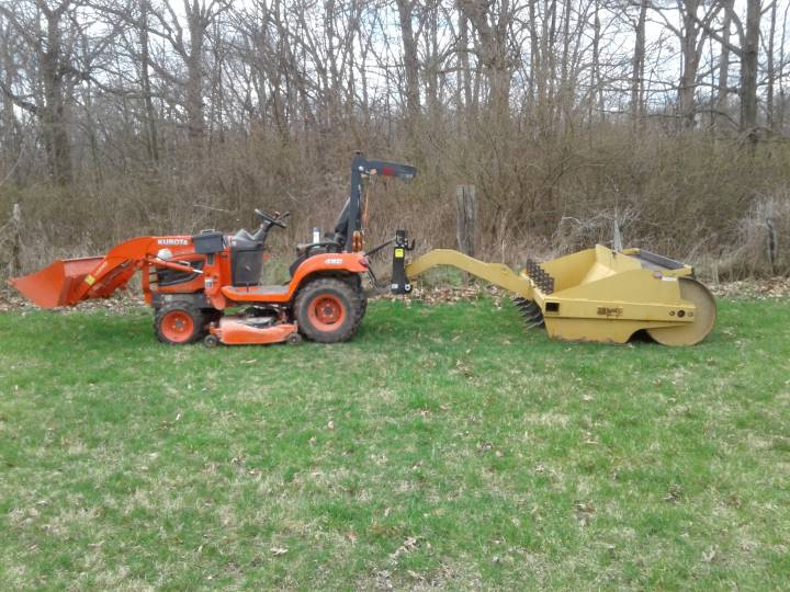

Do you have any post about that attachment?
