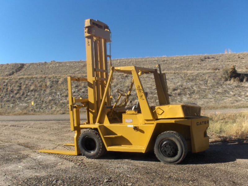

I used to run a Cat V120 at a lumberyard. It could pick up 4 units of 8' 2x4s - I think 208 sticks per unit.
(2.3[lb/ft]*8[ft]*208 [pcs/unit]*4[units])= about 15000 lbs.
It had dual wheels up front.
The mast may be short, but I'll bet it's a telescoping boom, so lift height should be good, provided you stay on dry, packed, level ground. The low boom is very nice if you need to get under a door in a storage building - don't ask how I know.
One of the most challenging lifts was to put a unit of 24 foot lumber on a flatbed truck - the ends of the unit would sag about 6 or 8 feet, so you had to lift the middle way up in the air to get it onto the truck bed. Big pucker, that.

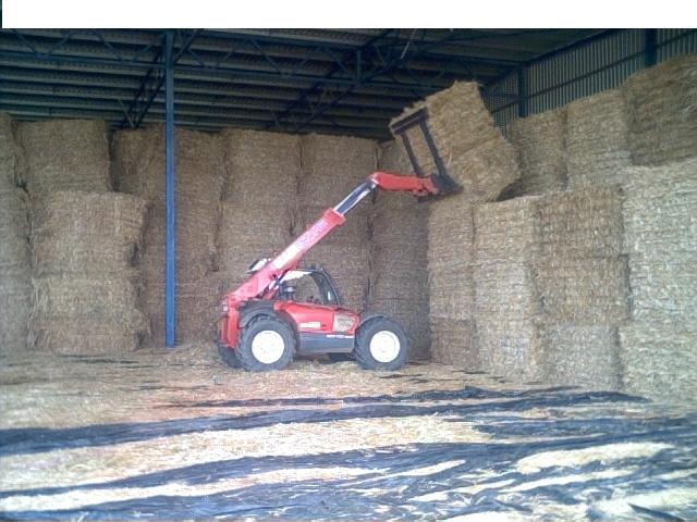

All depends on what/how much you need to lift, how high/what reach & importantly where - a standard type forklift will generally work ok on compacted reatively level dry surfaces, but is a specific use machine - once you have some rain, develop wet spots or wheel ruts/inclines their limitations become quickly evident (And if you have the misfortune to every bog a large forklift, the recovery is often a protracted & time consuming experience).
IMO & depending on (your) budget I'd be considering something more versatile/multi-use, along the lines of a large telehandler (the telescopic boom, AWD & AW steer makes it a stable machine for all areas/seasons -one of ours below will lift 2.5T easily) or maybe a 4WD industrial loader f/w forks (something like our old Case W9 f/W forks below handles 2.5T no drama)

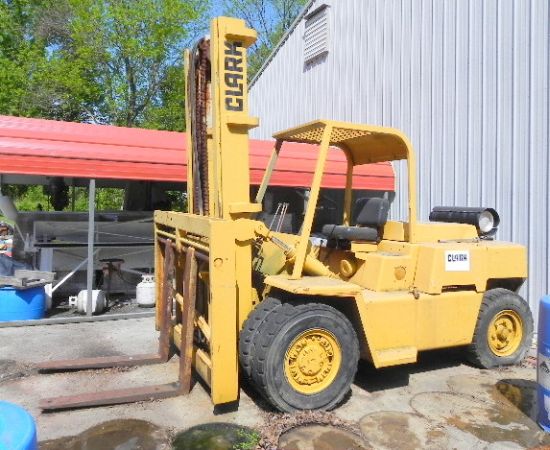

Just looked at this one last night. Its a clark 13,000lb model. Runs but needs brakes and possibly a tire.
Its at an auction so we'll see if it works out. Might get pricey but its close to home. If it weren't for the brakes I could put a Slow Moving Vehicle sign on the back and hit the road :)
