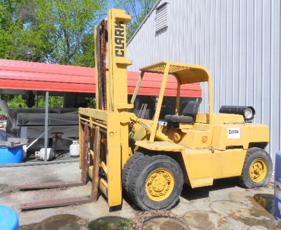

Just looked at this one last night. Its a clark 13,000lb model. Pretty clean unit. Runs but needs brakes and possibly a tire.
Its at an auction so we'll see if it works out. Might get pricey but its close to home. If it weren't for the brakes I could put a Slow Moving Vehicle sign on the back and hit the road :)

if you're mechanically inclined the brakes are no big deal on the Clark. They may or may not be "inboard" brakes. On that particular model I do not remember for sure.
You can tell by following the brake line and see if it goes out under the wheels , or if it goes into the axle housing closer to the center of the differential.
if they are inboard they are basically the same as outboard but are inside the axle housing with a smaller drum. The axle housing on each side must be pulled. There are some bolts going in towards the diff, and some studs with nuts going the opposite way.
Tilt the mast all the way back and put some oak blocks under the front edge of it and tilt forward and raise the tires a inch or so off the ground. No jack needed.
Pull the tires and then the axles. All can be done by "manpower" pretty easily. The brake shoes can be relined for about $15-20 each..... WAY less than what the dealer will try to sell you a new set for.
Get a Clark dealer to fax you a parts breakdown of the brakes / axles and you can see what all has to be pulled. If inboard type its usually 3 hours per side to R&R.
You sir, are a genius! I did this once with my little Hyster at home but completely forgot about doing it with the Clark. The brakes are outboard and they left just enough room between the backing plate and the chassis to reach in and undo the bolts and bleeder screws.
Stupid question, but why are there two brake pedals? One works by itself and has a separate master cylinder, the other pedal has its own smaller master cylinder, but when its pressed down past halfway, the linkage grabs the other pedal and moves it as well.
Is this setup for separate control of front and rear?

On most both pedals work a single cylinder. The reason they do dual pedal is the left one should have whats called a inching valve or function.
What it does is that you can slight push the left pedal in and the trans will disengage. This allows the operator to rev up the engine and lift or tilt the load quickly while the lift is still moving with out the forklift trying to surge and drive.
The right brake pedal is used for when you are trying to get up close to something and dont want it jumping like if your on a incline... if on a incline and you use the left pedal the trans will disengage and it will roll backwards and ya let it out and it will surge fwd. use the right pedal and the trans is always trying to keep it moving fwd and holds it in place.
On that one if it has dual master cylinders, the left one probably works the inching valve and then when it get pushed farther down there is probably a mechanical stop that starts pushing down linkage for the right pedal and working its brake master cylinder.
