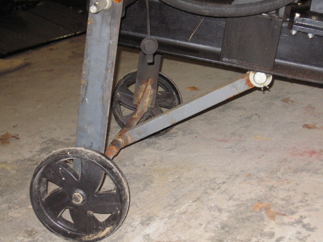

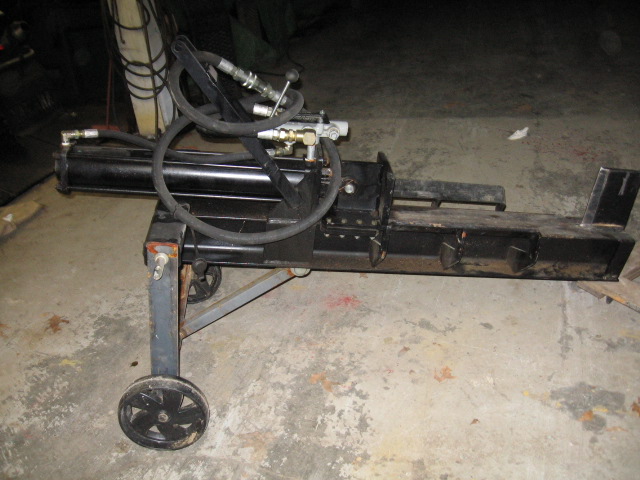

Yes I have one and it sucks on the tractor. I put wheels on it to move it around and made the hoses longer. (use 3/4" hose)
I have used it on the Cat 311 excavator and even made 2 QC and aux spool on the Excavator (33 GPM # 4500 PSI) It cycles in 3 seconds- way too fast........
It does work well on a Ford 3400 (35 HP) 12 GPM
And it also works well on Kubota B 21 about 5 seconds to retract.
It works well- plenty of power and will split anything I've put on it.
It needs a "tray" to hold the split wood so you don't have to bend over.
I would like to see another valve with a detent on the split cycle so you can engage the ram and walk away to get another log- a lil dangerous if you are not carefull.
The 4 way slip on wedge sucks- don't waist your money.

I've had the Northern 3 point splitter for a little over a year now. It works pretty well but I agree it needs a tray to catch the split pieces and its also a little clumsy to hook up. I made a special table to rest the splitter so it doesn't tip over.
I also purchased the 4 way splitter and mine looks exactly like the one pictured. It speeds up the splitting of the softer woods but I guess we just can't let the cylinder extend all of the way so as to avoid the damage.
