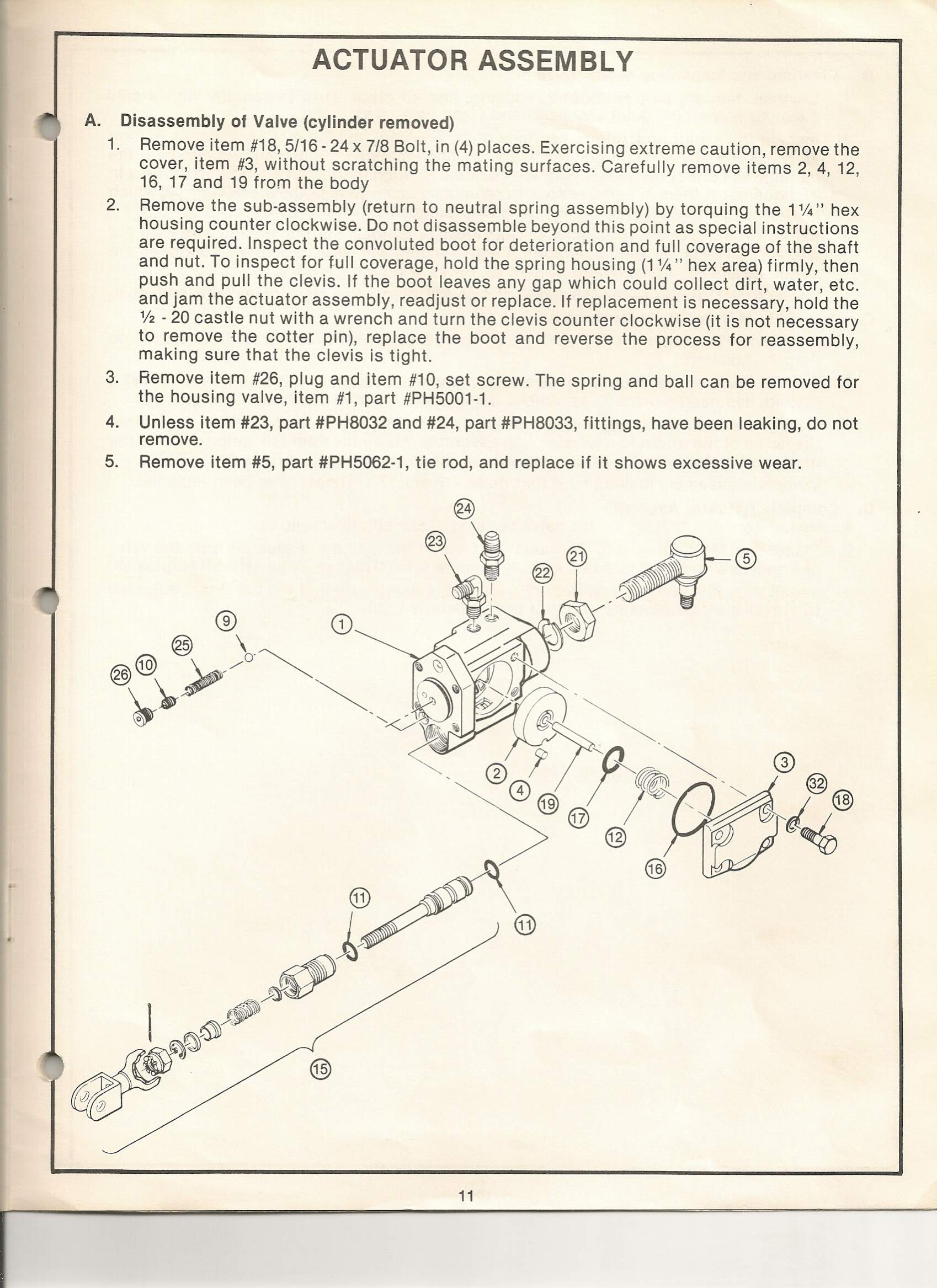

I have a YM226D with a YM186 power steering kit on it and need some help finding a tie rod for it. The tie rod on the end of the hydraulic cylinder broke and I can't find one anywhere. Could anyone tell me where I can pick on up?
   / Anyone have pics of power assisted steering valve and cylinder on their Yanmar? #13
I will give them a call. I ordered a tie rod from Hoye hoping that it would be the same size as the one I need because the manual above says you reuse the factory tie rod from the drag rod. The one I got from Hoye is too big and the part number (TR-1813) is the same as Hoye's, so I am hoping it won't be the same. I appreciate the info.
   / Anyone have pics of power assisted steering valve and cylinder on their Yanmar? #14
Is your hydraulic cylinder pushing on the Tie Rod (the side to side rod) or on the Drag Rod (forward from steering box to axle, Fredricks page 66)?
Can you post some photos of what broke?
   / Anyone have pics of power assisted steering valve and cylinder on their Yanmar? #15
The hydraulic cylinder is pushing the tie rod It is part number 5 in the attachment. scan0003.jpg

I have those tie rod ends in stock.
I will PM you

Here's one I put on my YM2020. Be careful, my cylinder is not long enough and I lost about 1/3 of my turning radius.
Hi Eddie,
I know this is an old old post but the photos look exactly like the unit I need t rebuild.
It's markings: Modular Controls PSC-2117B-12.75-5.
Any info you can provide on yours would be appreciated.
Thanks
Bob
