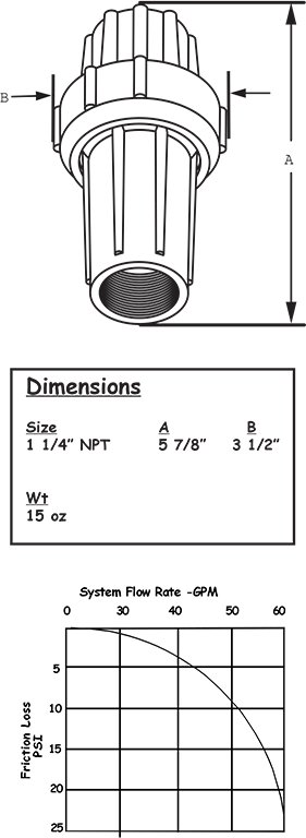

The cycle stop has a 5 GPM bypass, household use below that will still cycle.
I'm not using one of the plastic, fixed pressure cycle stop valves, they have huge head pressure when you get over 30GPM. I'm going to put in the CSV3B2T - CSV3B2T CYCLE STOP VALVE – Cycle Stop Valves, Inc

I've decided to go with the traditional pump and CSV, the VFD option ended up being about $1700 more and I just don't have the budget for it right now. I'm going to upsize my pressure tanks in a few months also to minimize the cycling as much as possible. Now I just need to fish the failed pump out of the hole, the first piece of down pipe broke when we tried to pull it. It's only about 30' down to the top of the pipe so it shouldn't be too difficult to pull it out, I hope.
When you put your new pump in, make sure you put a good rope down the hole with it. That way you can still pull the pump out even if the pipe breaks. I would also use the heavy black poly pipe to run down the well, that way you have no joints between the top and the bottom.
