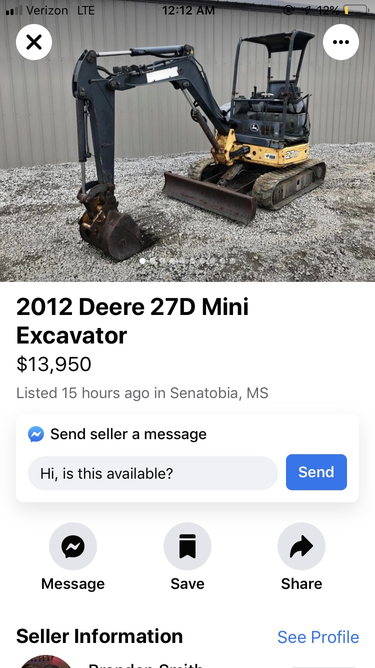

Spending 14k on a tractor mounted backhoe is a really poor value IMO. It’s better than a shovel but on the spectrum of hydraulic diggers it’s close to the bottom. There’s decent mini excavators to be had for that money. A full-size backhoe is the best bang for your buck but I gather something smaller is probably more suitable. One of the smallest pocket size minis would probably dig equal to the BH85 and a 6500 pound one would dig circles around it. Here’s the best candidate I could find with a few minutes of looking but you could sell that and get your money back where you’re going to get hosed on the tractor backhoe and you’d have a lot better digger. IMG_9676.JPG

Yeah I tapped some equipment dealers and Craigslist for a mini ex just to see, I found several in the 14k range but they fell into two categories in a 500 mile range: massive (well 30 to 50 horse, tried to keep it under 12k pounds) and massive hours (>5000) or small and decent, but of questionable condition. I'm not overly mechanically inclined, but I'm not necessarily opposed to YouTubeing a fix. Primary concern is definitely picking something that I can get use from, and know what to look for or to look out for, and I absolutely lack that experience.
Basically if I buy a turd and just wasted 14 grand my wife will poison me.
