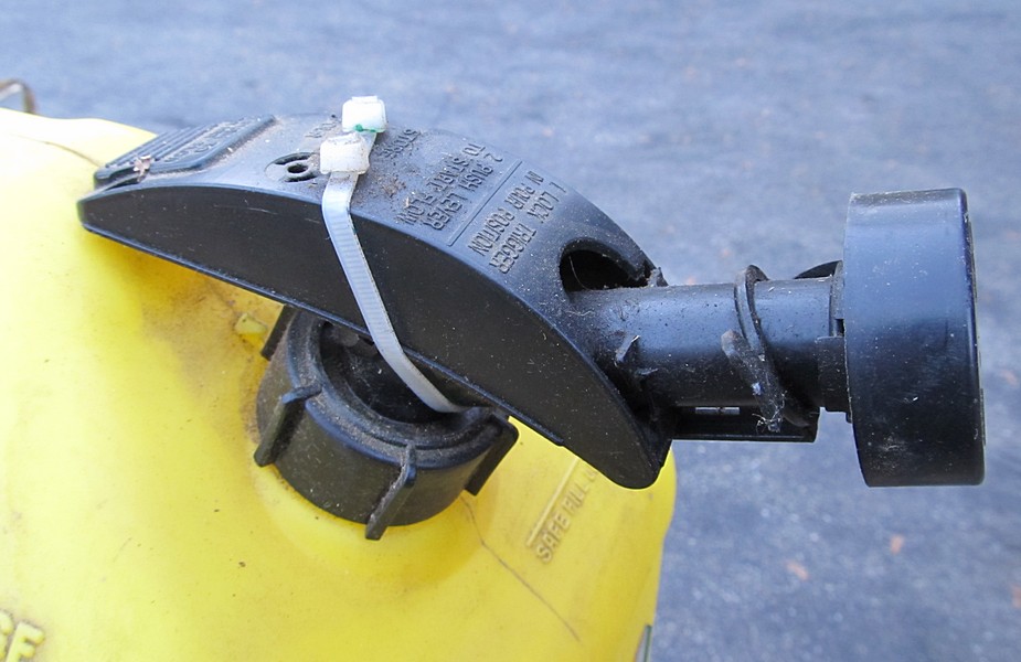

   / Anyone having fuel problems? #12
Tie wrap holds the trigger open on my diesel jug. I just couldn't hold the jug at the height of the tank and also try and hold the trigger open without some spillage.

   / Anyone having fuel problems? #16
Sometimes, you can't find the black ones in the stores as some states don't want them sold as a work around to the 'pollution' rules, Ma is one.
All the stores everywhere have the 'water' (white ones) as water pouring spouts are legal everywhere.
Don't tell anyone, but the only difference between the black one and the white one is the color and the packaging...sssshhhhhh....mum's the word.
