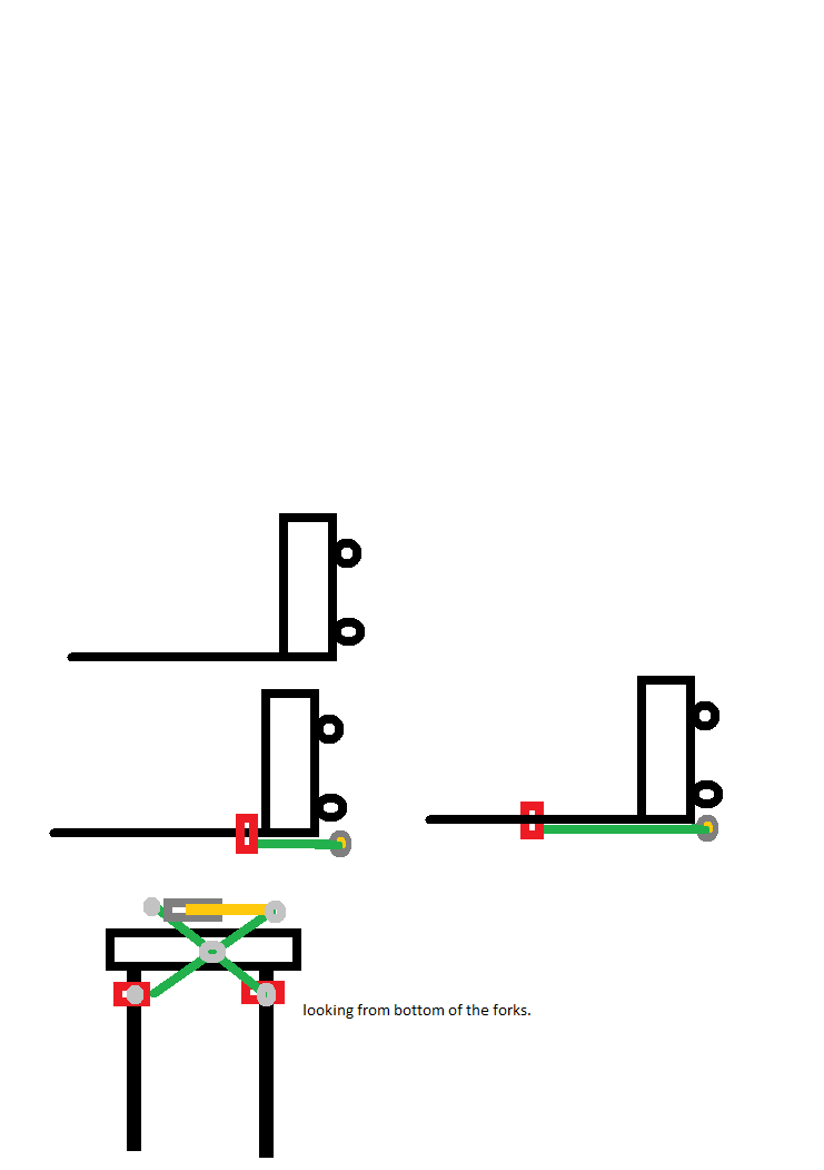

Yep, A clamshell on an excavator is basically the "ideal tool" for it. But since the clam shell attachment alone is 10's of thousands of dollars, it isn't realistic for anyone not doing this work for business. I'm talking about a couple hundred bucks in steel and a hydraulic cyl to add on to my forks to make this process go easier with a tractor or skid steer.
find some metal that will fit over each individual fork. weld on some sort of hinges or spot to connect scissors to. drill hole through bottom of forks main support beam. drop a pin and some washers on for the scissors. hook up cylinder.
problem with putting up on bottom, is trying to get up under stuff, and the scissors catching on every thing.
going to also assume there is not much "width" between the holes that the FEL arms connect to. and guessing why everyone links so far are showing "vertical" setups vs horizontal setups for the scissor action.
it does get a tad annoying, you almost have forks out from under something just 1/2" more, but what ever you do, you just can't tip things and lower things just right. and you end up dragging what is on the forks back away from were you want it...and then you fight with it. till finally you get what you want.
if you do a vertical scissors as other folks link show. you do not have to build the entire "wall" that pushes things off. just run your bottom support and angle brace off each side. and skip rest of the mesh of the wall.
sadly forks get used to much. to load heavy stuff. and all it would take is grabbing a hold of wrong lever and have some expensive piece of something go crashing down :/ and guessing reason why i do not see the "pushers" more often on forks.
Boggen - you hit it on the head. James, Chris - I am looking at an improvement here. I was able to set a couple hundred rocks successfully with the forks as-is, but it could have gone a lot faster if I had a way to push off rocks at the correct position. I had plenty of practice...
I really did need the reach as I was bumping against the lower layers with the skid steer wheels even with 48" forks, so short forks would have caused a lot more problems.
Boggen - As to wrapping around the forks with the tube as you show, I think it is best to stay riding on top of them. That way you can set the fork spacing as needed. I had to change that around several times for different sized rocks. Otherwise your mechanism looks like what I had in mind. I would keep it above the forks or it would be a big problem picking rocks up with gouging into the ground too.
