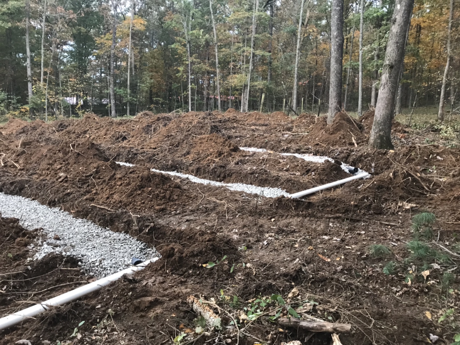

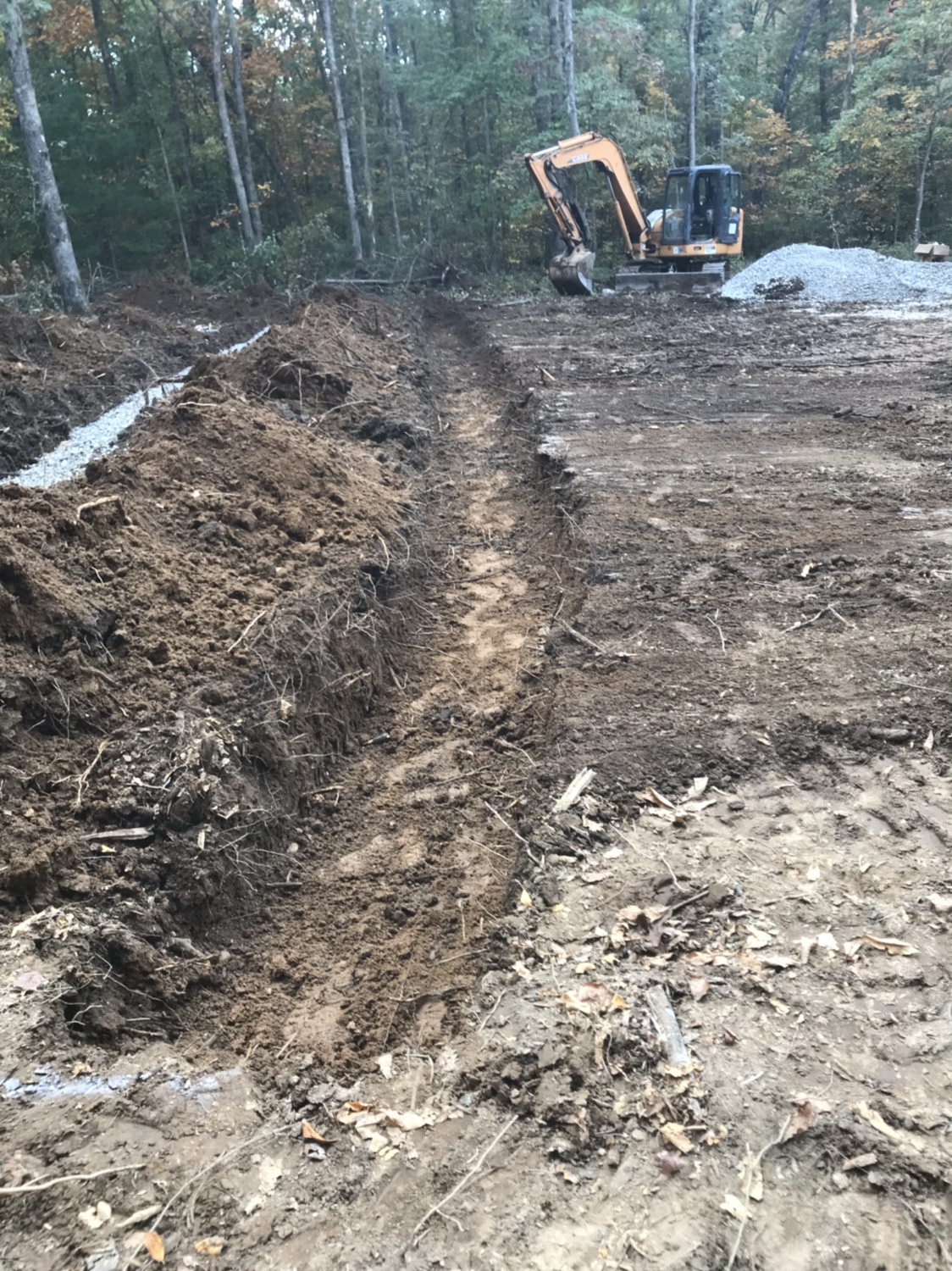

What used to be a difficult job...i.e., properly pitched ditch and drop from the outflow with gravel both under and over the leach line pipe etc., etc...has been made incredibly simple with the advent of infiltrator sections...no gravel required...using a back hoe with a 36" bucket a typical infiltrator system can be installed in less than a day...
I’ve never seen something like that permitted here. We’re still using the old fashioned gravel system. Digging the ditches is the easy part. Getting the gravel in and raked down and then covering the pipe without it floating out is the hard part.

/ Anyone here install their own septic #8
I don’t know what the code in your area is but locally a homeowner can do the work but it must still be permitted and pass inspection. Well that’s for a new construction. If it’s not a new construction you have more freedom. But putting in a septic isn’t high profit work at least locally. You’d probably be better off hiring it done especially if you need to rent a machine.
I don't know about Florida septic profitability.
In some areas of the country, septic work can be quite involved, and will put fillet mignon on the table.
Florida likely has very basic requirements, similar to your photos.

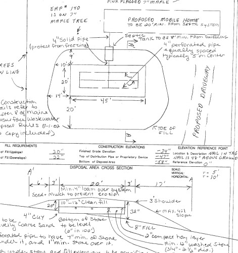

Liquid runs downhill. I had to get a site plan and permit... the plan tells exactly what needs to be done. SepticSnip.jpg Here's a snip of the plan for the house lot I bought last year, which can give you an idea of what needs to be done. Plastic tanks may be easy to use, but they also float.

Liquid runs downhill. I had to get a site plan and permit... the plan tells exactly what needs to be done. View attachment 681961 Here's a snip of the plan for the house lot I bought last year, which can give you an idea of what needs to be done. Plastic tanks may be easy to use, but they also float.
Is that mounded up on top of the ground vs dug? Locally the ditches are supposed to be level with at maximum 4” downhill slope allowed.
/ Anyone here install their own septic #13
It's a mound, which is the way they seem to be going here. I would rather do that than infiltrators though.
/ Anyone here install their own septic #14
How are you supposed to deal with that once it’s done? That looks like a completely ruined yard in the making.
People plant grass and treat it like a lawn. The system I cited above was raw ground on a rocky sidehill with boulders as big as dinosaur eggs. It was installed in 2004 but never used, I bought it for a eemigly good price and hope to take what little wood there is off it, clean it up a bit, get permits and power, then hopefully make a little money off it. Of course the day after I list it will be the day the real estate market crashes...
