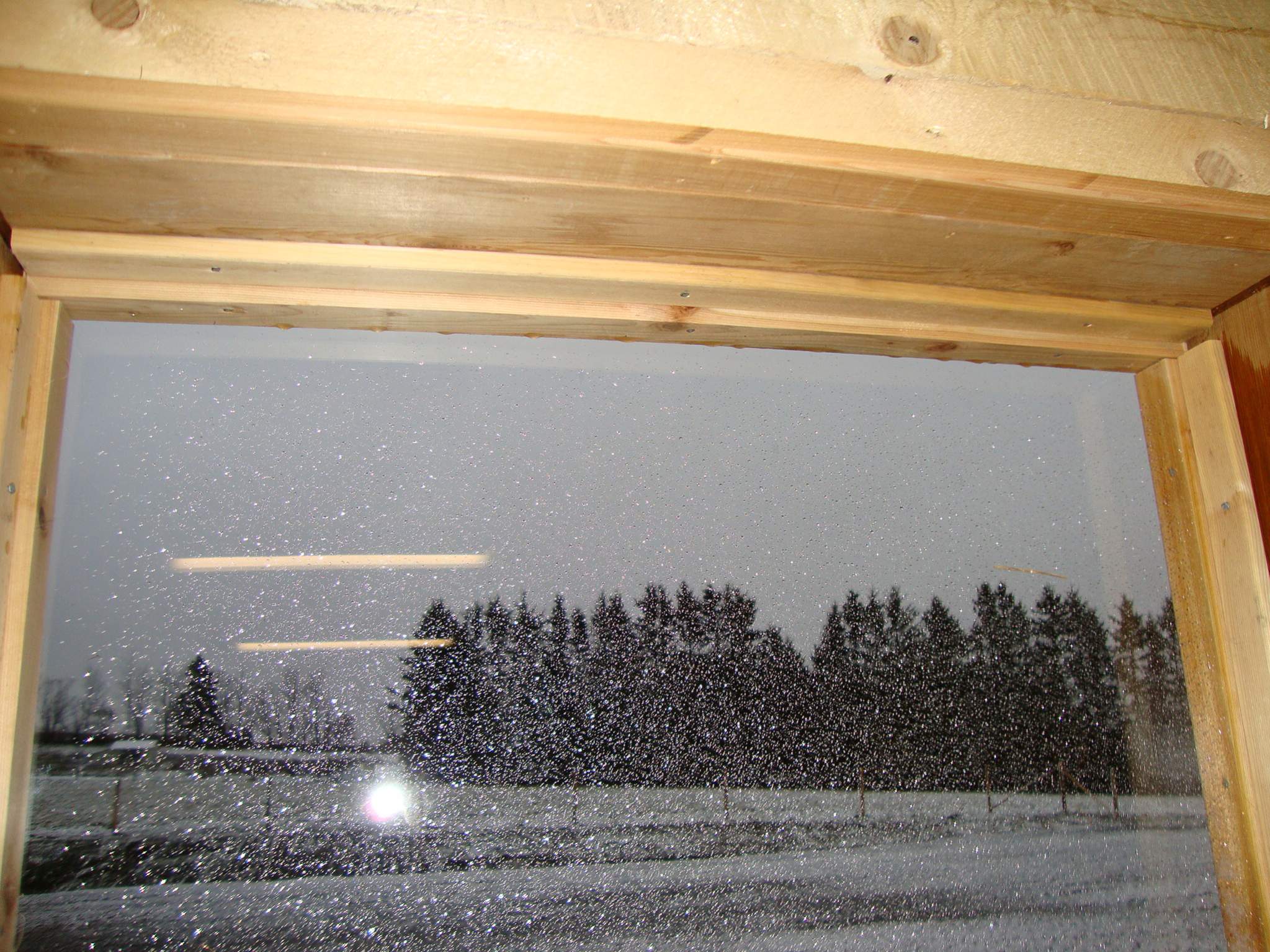

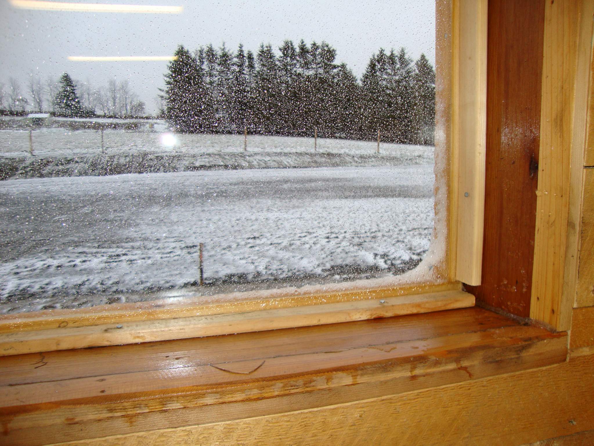

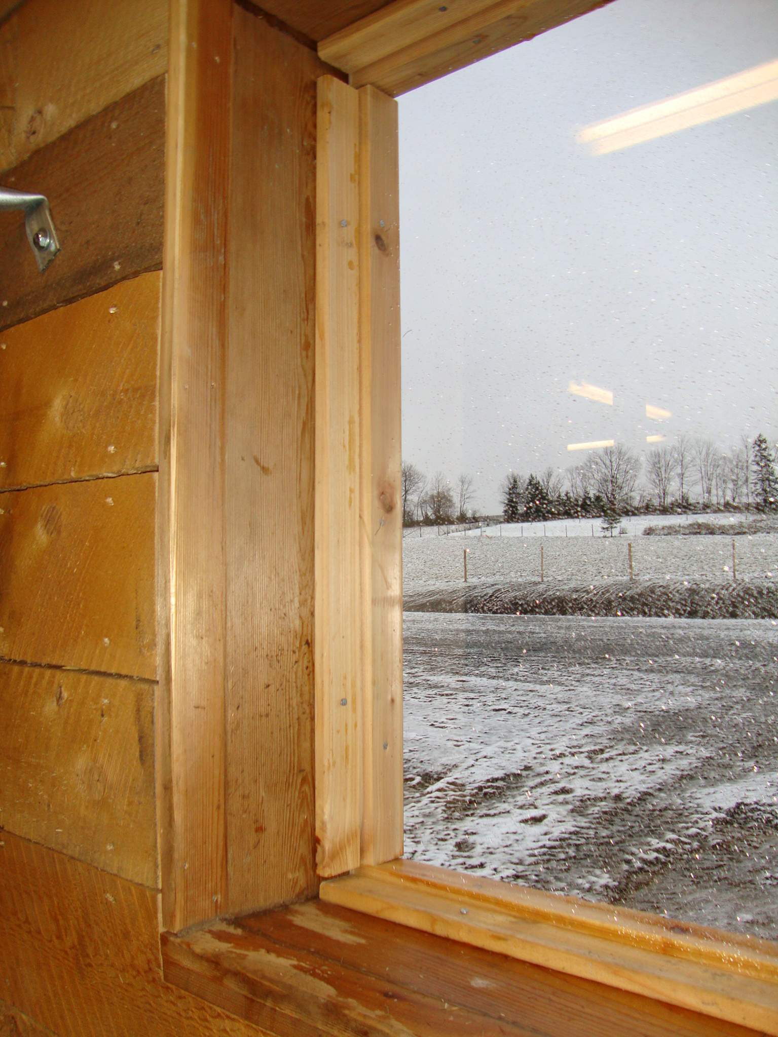

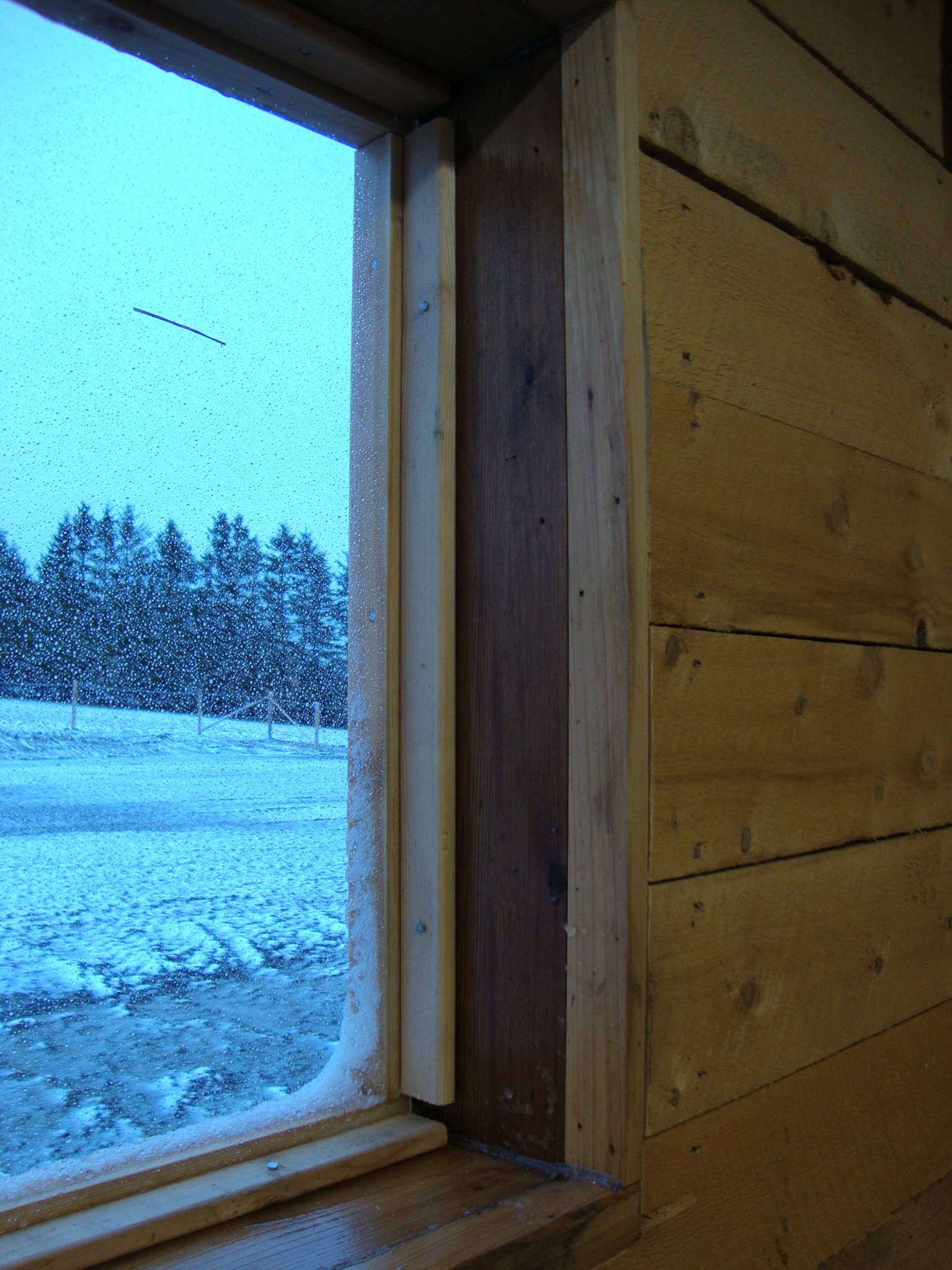

We put our windows in this morning, woke up to a couple inches of snow and a cold north east wind.
I used cedar 5/4 x 4 decking, ripped down the middle for the outer frame, and cedar 5/8 fence boards for the interior frame. The Lexan is 3/16, sandwiched between the two frames. The casing was wet from snow and rain before we put the Lexan in, normally they leak very little if at all.
I tried something new this year. I cut transverse grooves in the bottom of the lower outer frames so water running down the windows would have somewhere to drain away. The frames are simply nailed into the casing faces.
Sean

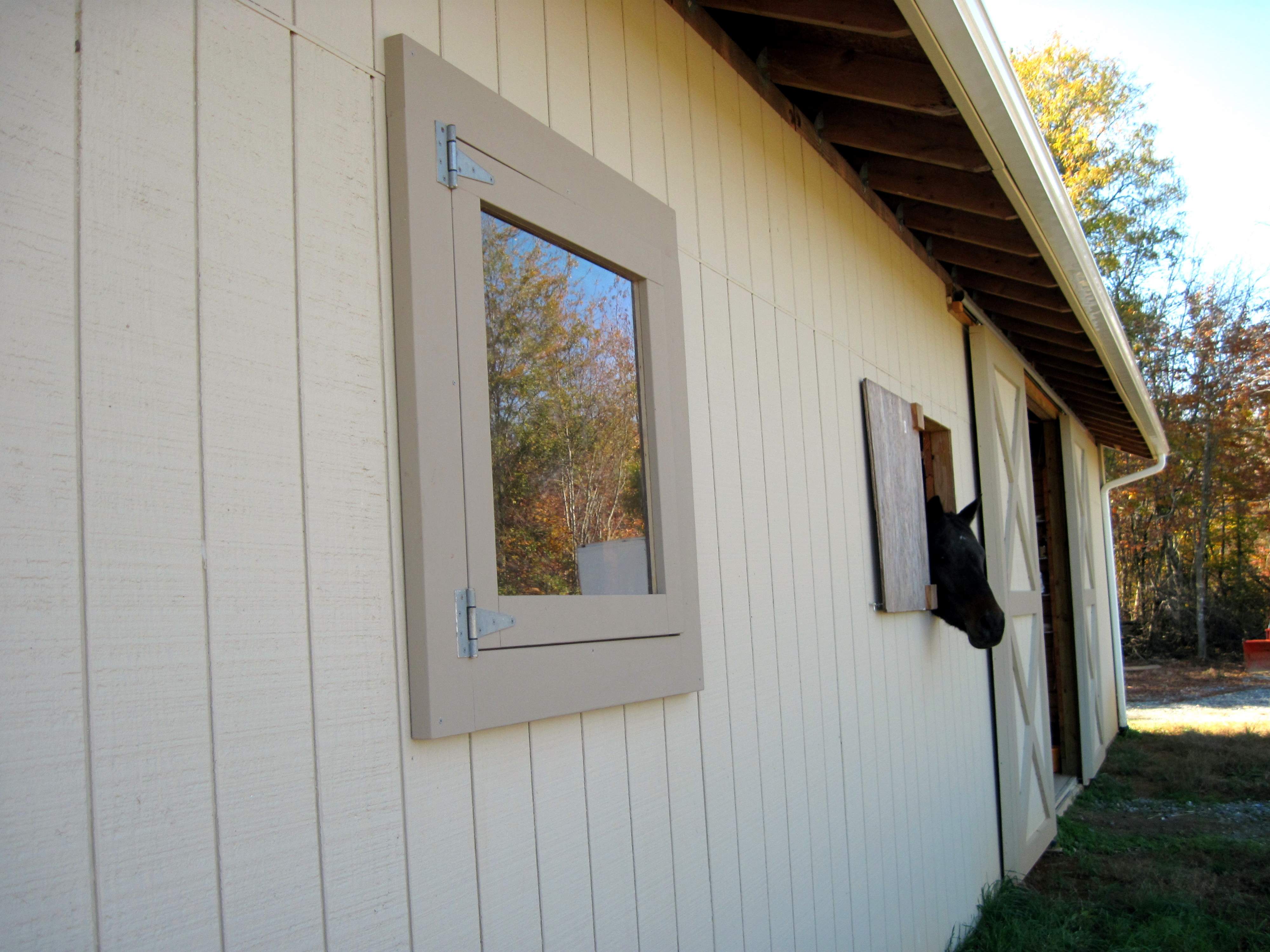

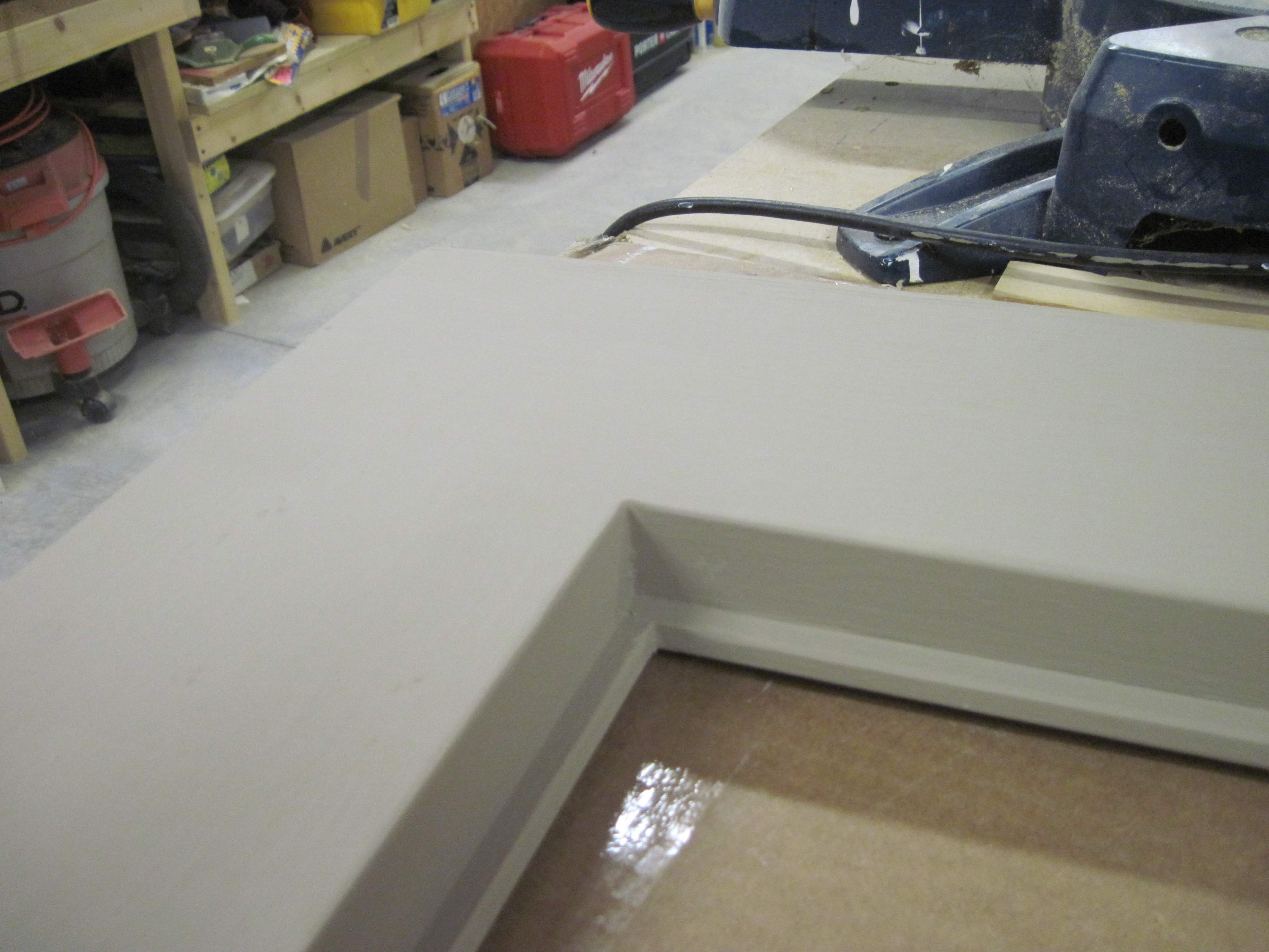

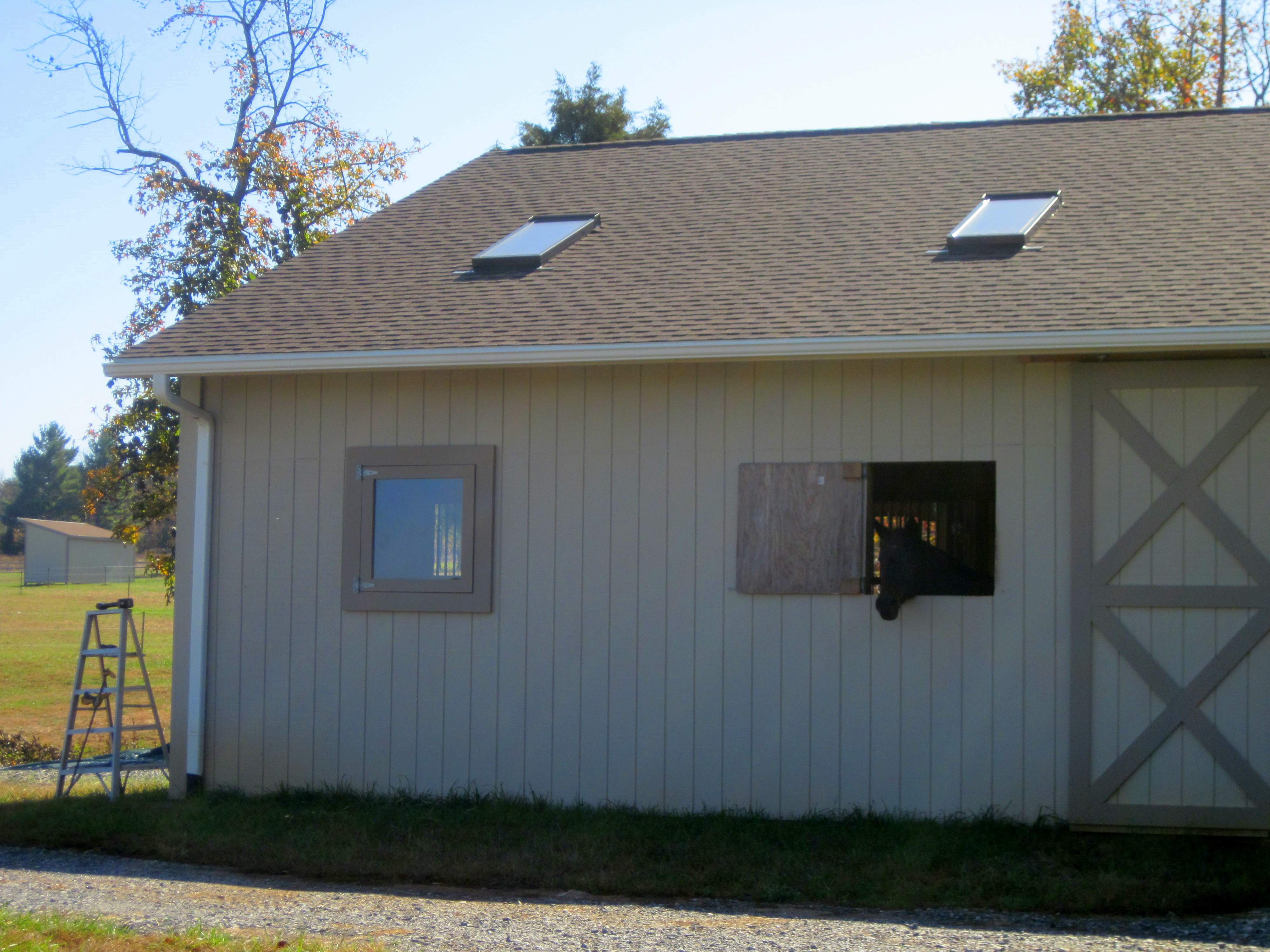

I finally finished one of the windows. Got one more to go.
I promised pictures so here you go:
The frame
attachment.php
The window
attachment.php
The opening
attachment.php
The framed opening (note the ugly temporary flap of scrap T1-11 on the other window. That's what's getting replaced).
attachment.php
The window mounted and open
attachment.php
The window when it's closed
attachment.php
Another shot of the closed window. It adds a finished look to the barn.
attachment.php
The view from inside the stall.
attachment.php
