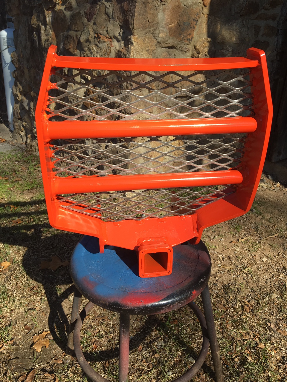

SS expanded metal from scrapyard $4. 3x5” angle iron on bottom to defend against sticks. Added the receiver hitch but really not practical for a loader tractor. Should have added ring or hooks for tie down.

Sorry for old thread, searching got frustrating: What gauge expanded metal? Gonna weld one of these up soon. Looked at stores today and everything was 13 gauge. That seemed light with 3/4 inch diamond holes, but quite rigid at half-inch holes. What's good for this? Thanks
9 gauge

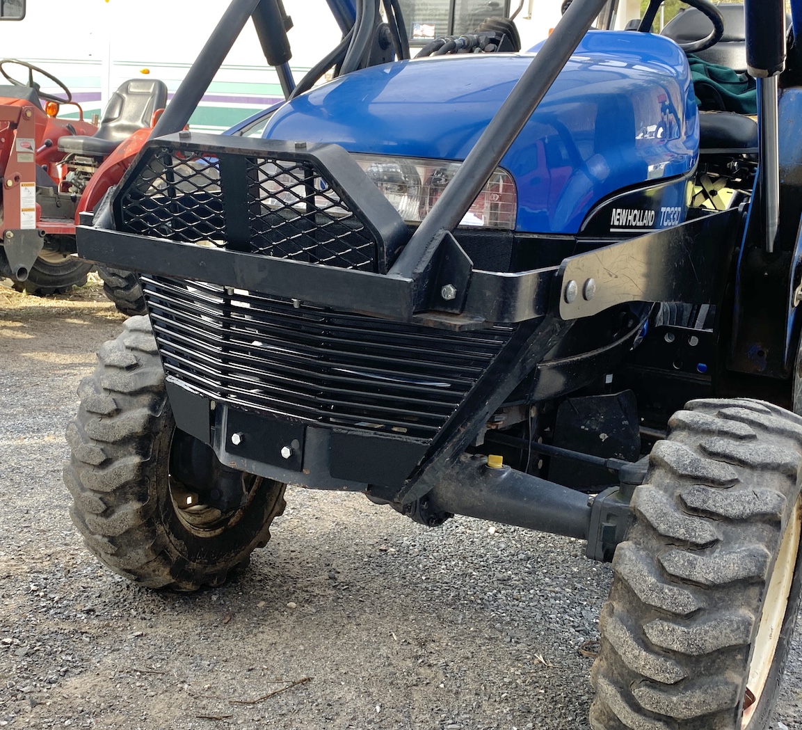

A local fabricator made this up for me. It ended up with a "Mad Max" sort of look

I like it John.
Cripe n heck, I can take my factory grill off, take it to a place right here in A-Town, and they'll cut the expanded to fit. Take it back up and tack the material on (welder's up north), and bolt it back on! Woohoo
