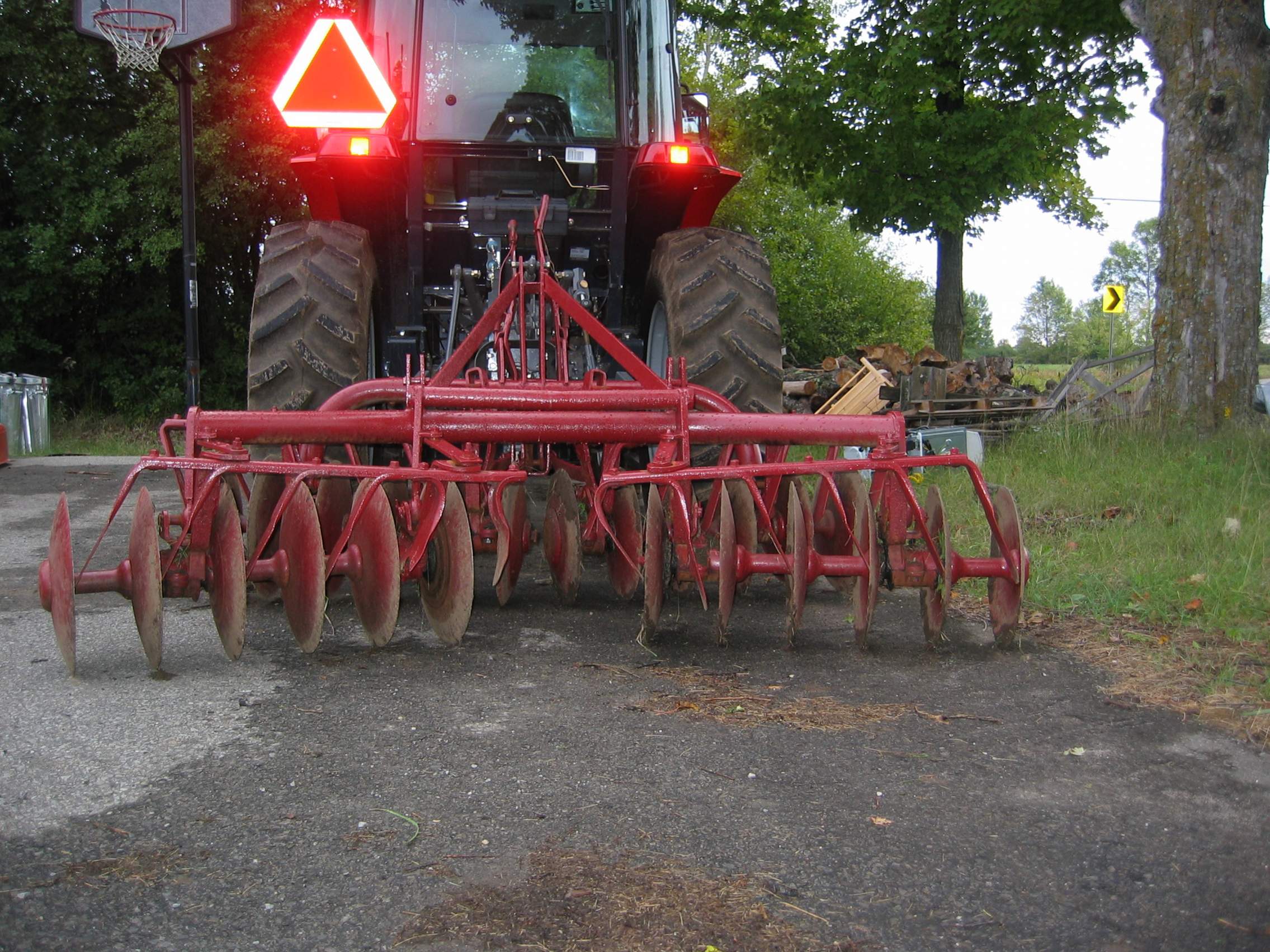

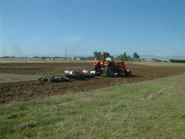

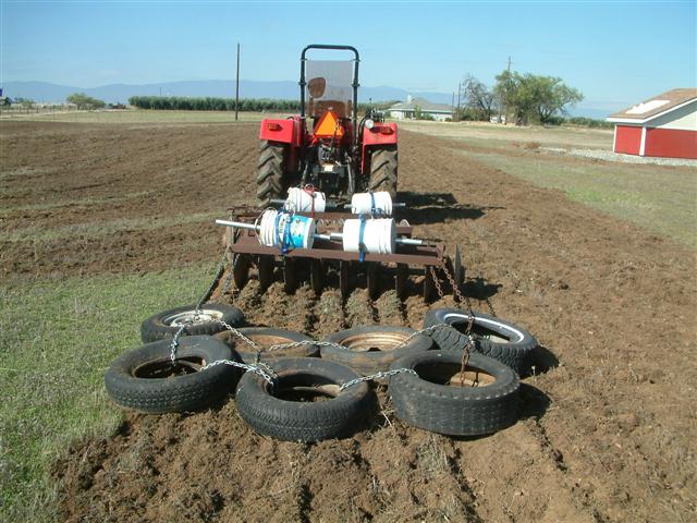

so 4-5 5 gallon pales of concrete ought to do eh ... will have to see what i can find in the way of bulk slap steel since that seems like it would be huge on top ?
I took a look with some pales and it would seem i can do your method of strapping them on main frame (since the outer frame is floating)
4 should get me 2.7 cu ft ... or about 400lbs added
Sounds right. I used two 60-lb sacks of concrete mix for each bucket. I stuck a piece of galvanized fence pipe down the middle to make it easier to handle the weight.

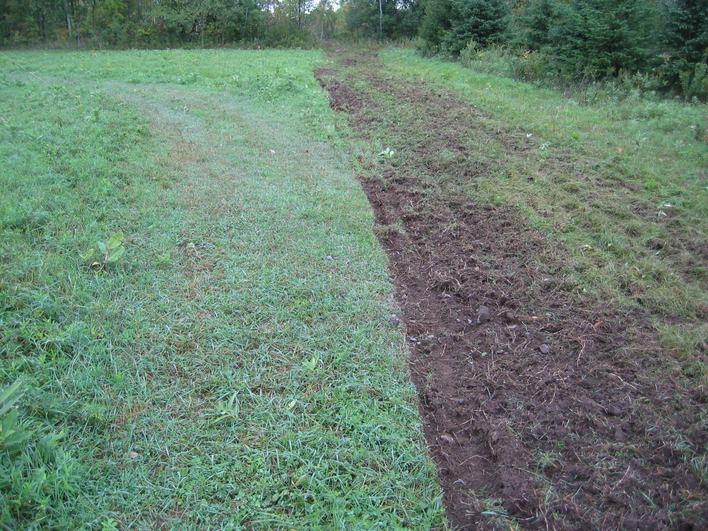

with smooth disc on it I would assume you would need some weight. or even to break gound with plow or middle buster first. to give it something to sink into. with the soil here in N Fla. and serrated discs if I ran over a plot 5 times I would have the tractor buried to the hubs.

I'm out to pick up a 2 bottom plow this aft, so will plow my fields first and disk afterwards
/ Anyone know this disk ? #24
That sounds good. But if your tractor can handle the weight ontop of the disk you may be able to do it all with a disk when the soil is most but not muddy!
#25
I'm just thinking that itll help get rid of some of the post bushhogging residue (sticks etc) as well that is littering the field
