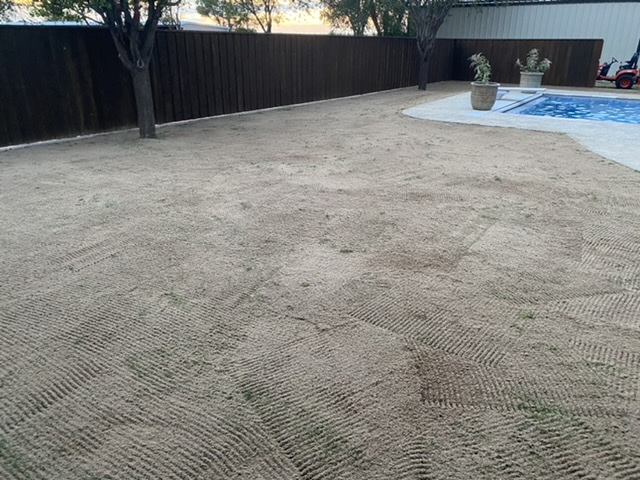

We laid sod back in April. The ground was leveled well before we laid it and we rolled the sod twice. It wasn稚 really bad but mowing at 3/4 with a reel mower you could sure see the high and low spots.
Decided to level it with sand. Entire project took about six hours and 5 yards of sand with me doing the work by myself. Without the BX to shuttle the sand around it would have been a lot harder.
This side I just spread the sand on today. This picture is just it raked in and not smoothed with the leveling tool.

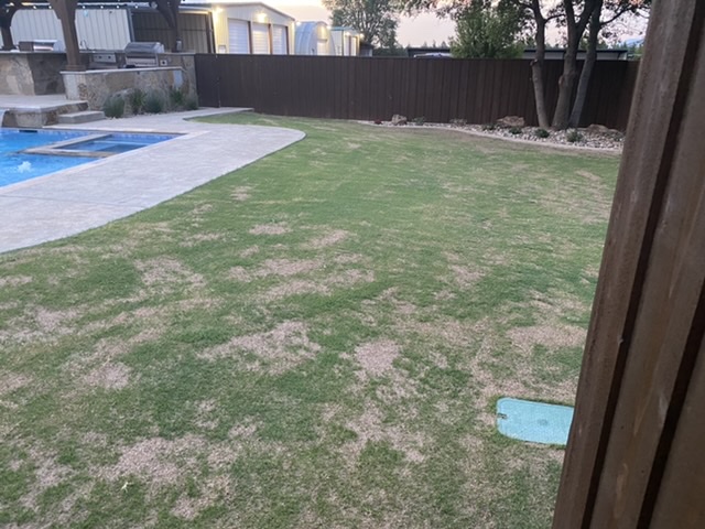

I did the exact same thing to the other half of the yard two days ago and it has already grown in this much.
I can稚 wait until I get to mow again and see what a difference it made.

Looks good!
How did you spread and rake it?
   / Anyone level their lawn with sand?
I dumped small piles across the yard with the BX and then used these.
I actually spread it around with the rake. The picture above is just with it being raked. After it is spread it needs to sit for a couple hours until it dries then I worked it in with the leveling tool. The leveling tool is useless when the sand is damp. It just clumps together.
