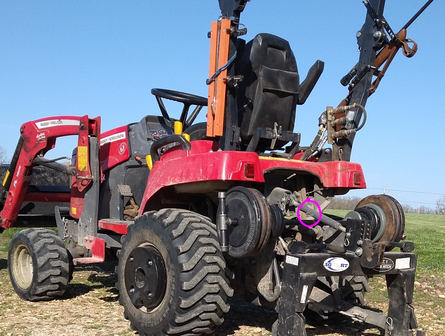

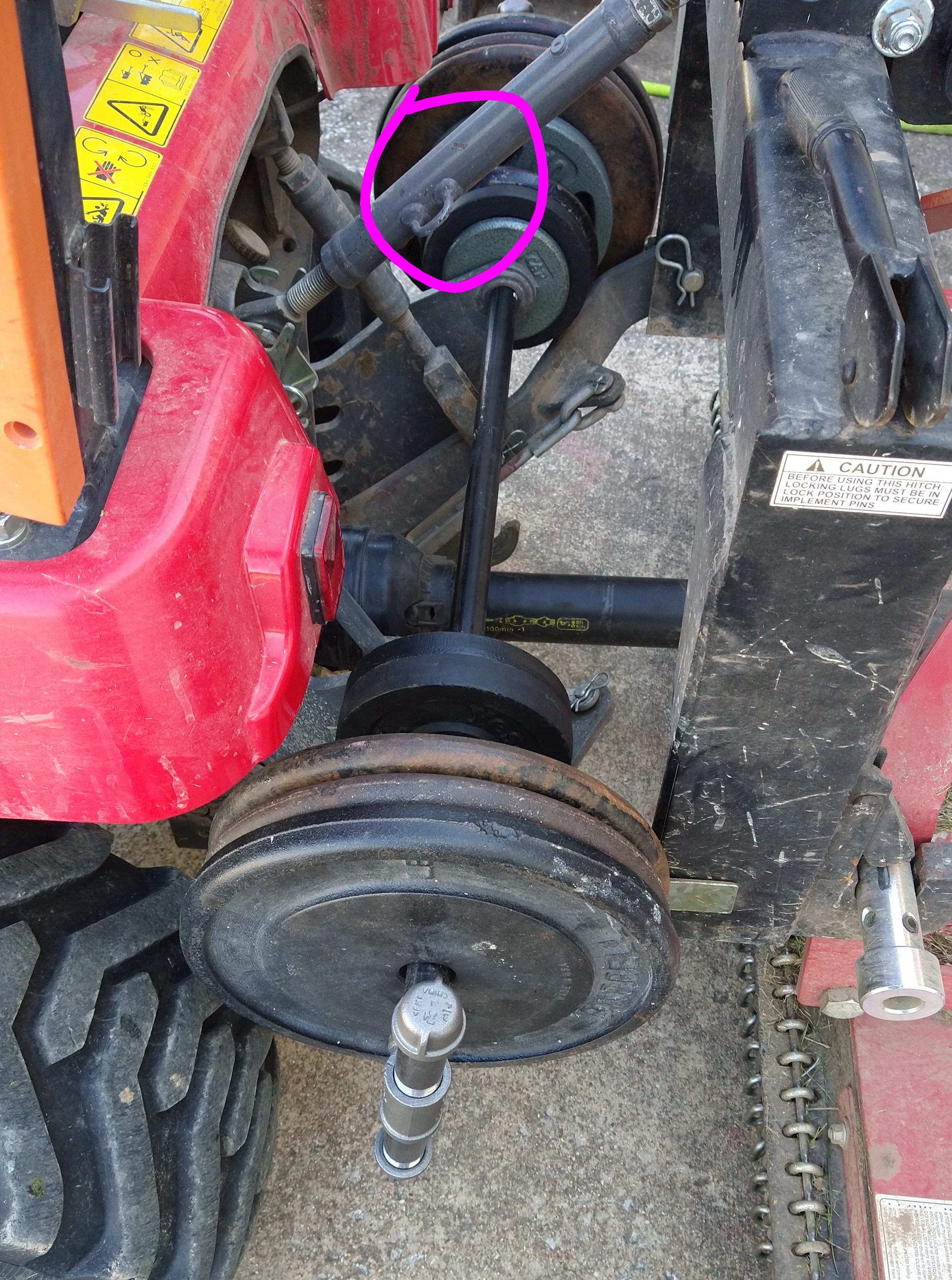

   / Anyone make a ratcheting wrench for a cat 1 top link? #65
Are those barbell weights ?
Yup, I stuck a piece of 3/4" black iron pipe through the backhoe frame, and can put on 275 Lbs ... Mostly for when I'm using my rear blade, as once I drop that on the ground, not much weight on the back of the tractor ...
