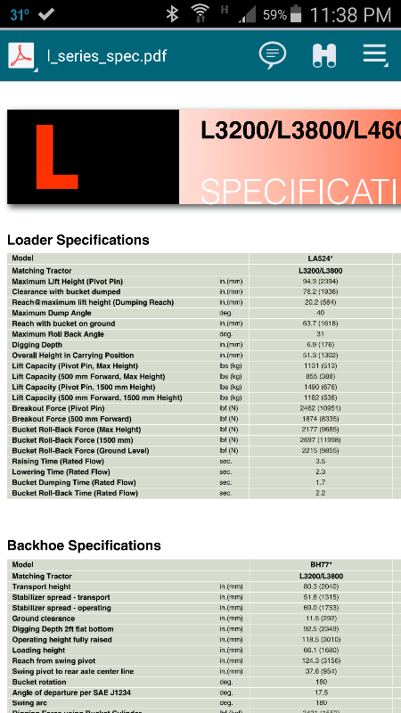

We have a L3200 (slightly smaller) I havent seen the loader specs, but it looks like it could handle it, i would have plenty of counterweight though.
   / Anyone move round bales with a L3800? #8
Here's the loader specs. I have an L3200 and I think I'd be pretty close once you get that far out and depending on the weight of the bail. It'd be a pain to grab a wet one and have no way to move it

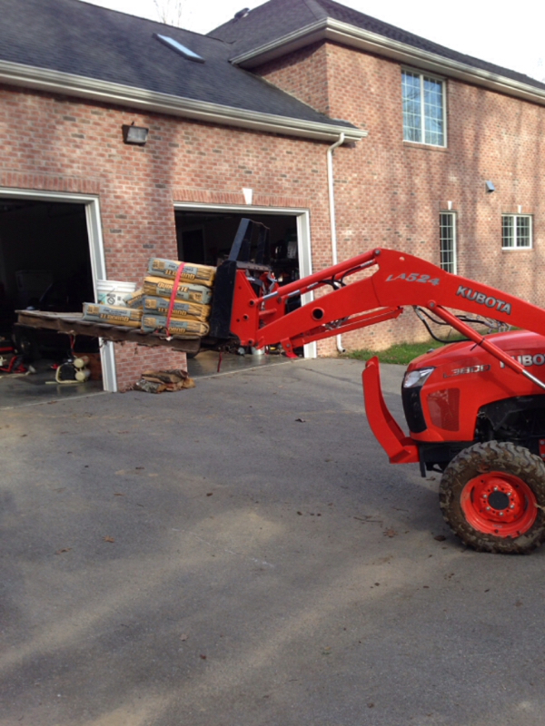

Depends on the size of the bales and desired lift height, it should work on the loader. It will definitely work on the 3 point hitch. Here is 1,000 pounds of concrete on a L3800. image-3330120186.jpg
So i suppose it could, just be on the limit.
