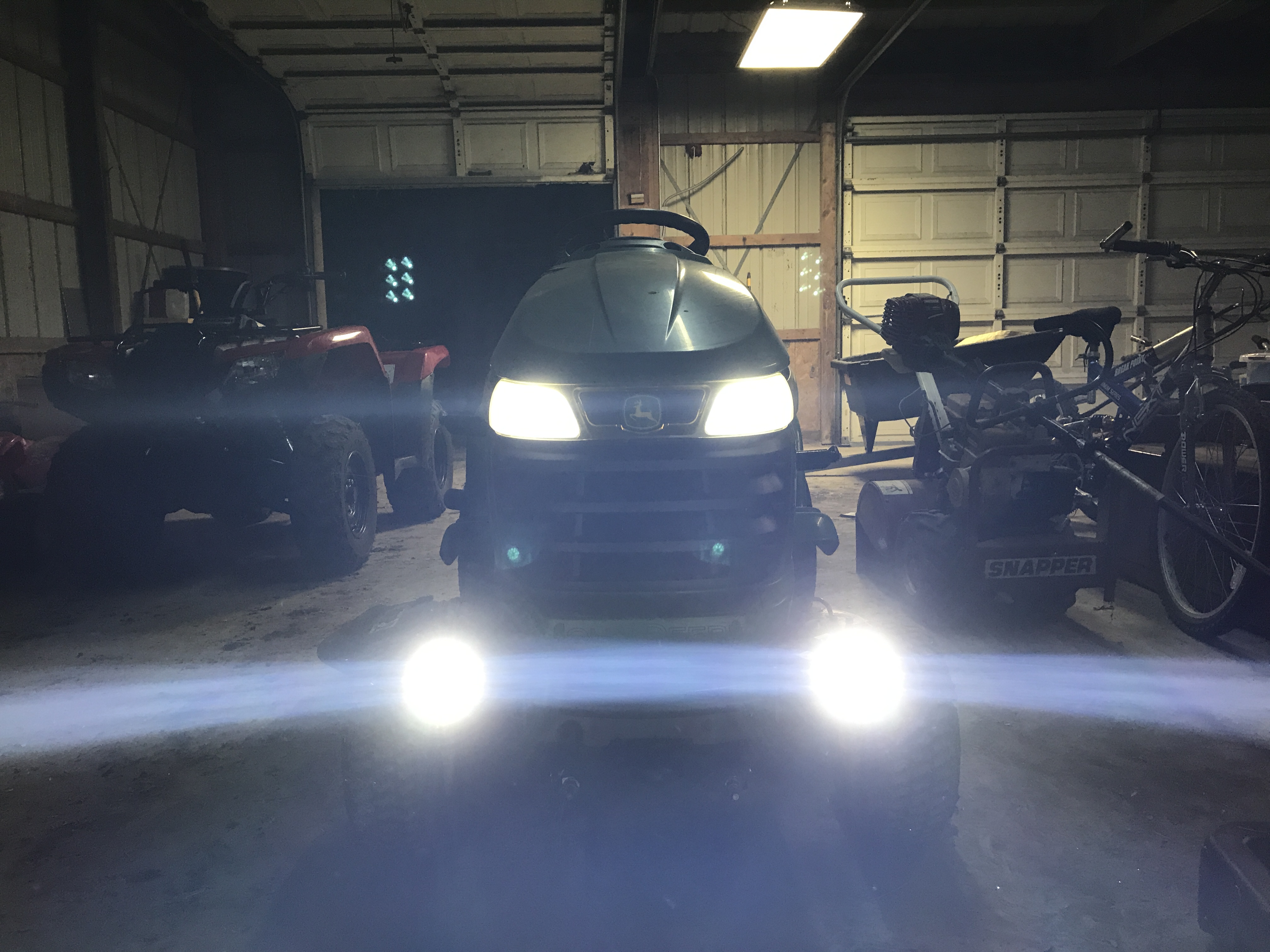

Being in Texas, I do quite a bit of night mowing with my X300. So far, I've swapped bulbs out for LEDs, and added LED lights from Amazon.

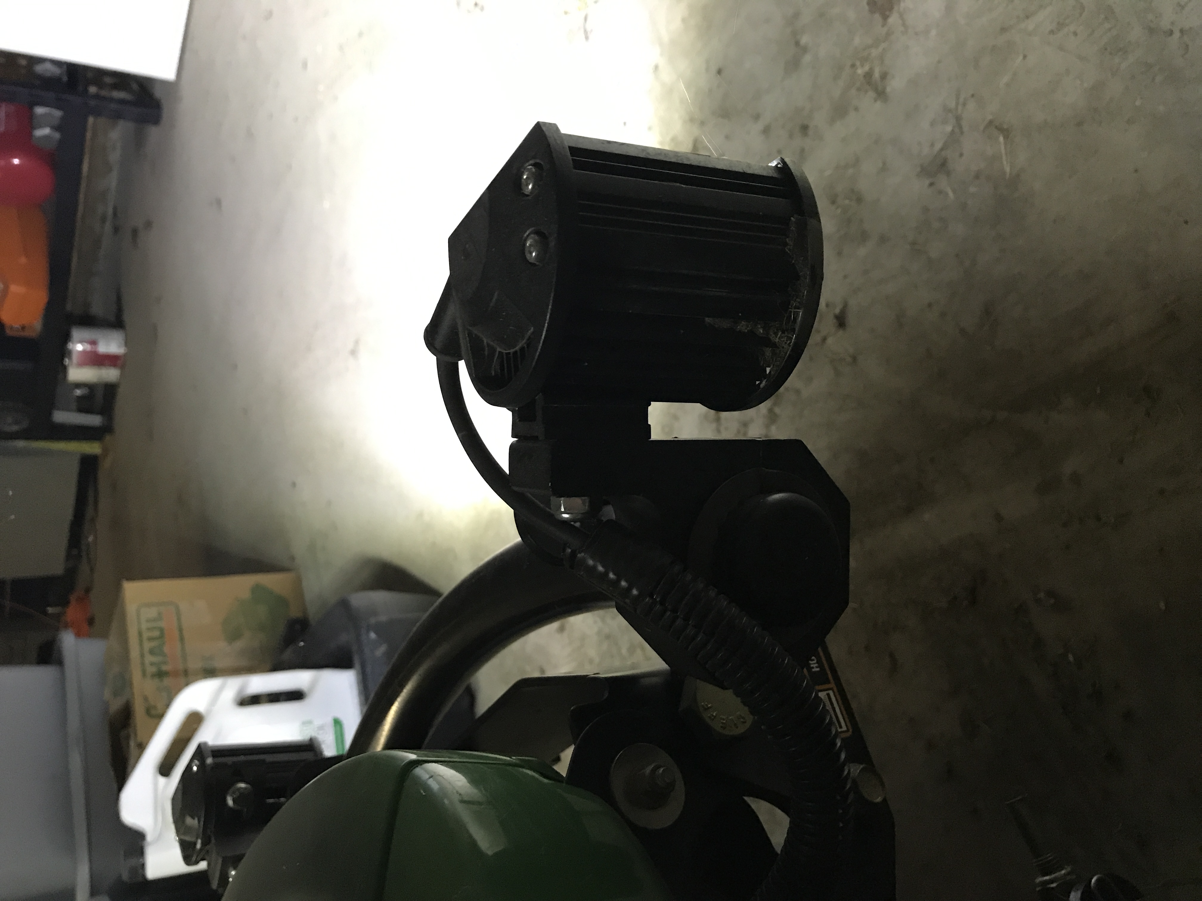

I had originally intended to mount the work lights dead center of the bumper on top, but quickly discovered that interfered with the opening of the hood. So, I experimented with a couple of locations to mount the extra lights, and finally settled on mounting them on each side of the frame using existing holes in the frame. This worked fine... at first. I quickly discovered that I had two issues. Vibration caused the nuts to back off constantly even with lock washers. So, I switched to nylon lock nuts. Still no dice, they just wouldn't stop drifting. Also, one light would make contact with the steering linkage at a fully extended turn. Just enough to touch, but still I didn't like it.
So eventually I dug out a set of bar mounts that were rubber isolated and absorbed a great deal of the vibration from the mower. They also allowed me to mount them to the bumper positioned toward the outside edge, which allowed proper clearance for the hood when open.
Wiring wise, I just tied it into the headlight circuit. Being that I replaced the factory bulbs with LEDs that use less voltage, and that the LED work lights are low draw, I figured it was OK. So far, it hasn't been a problem at all, and I've maybe 40 hours mowing on this current setup. All in, I've spent $45.

I plan on milling around in the shop later tonight, and will take a pic and post it.

Lock washers backed off. I didn't say the nylon nuts backed off, I said the lights still drifted. Which they did.
I would tighten as much as possible without seriously warping the aluminium housing of the lights, but still after 10-15 minutes of usage, they would drift downward. The problem was clear - the existing holes in the frame are much larger than a bolt hole, and even with huge washers, they still moved because of the vibration. The washers were slipping.
OP, I mowed again tonight. Worked like a charm. This was about 9pm, so not quite pitch black yet.
Thanks for the photos! Now, we just need some rain here in Central Texas.
