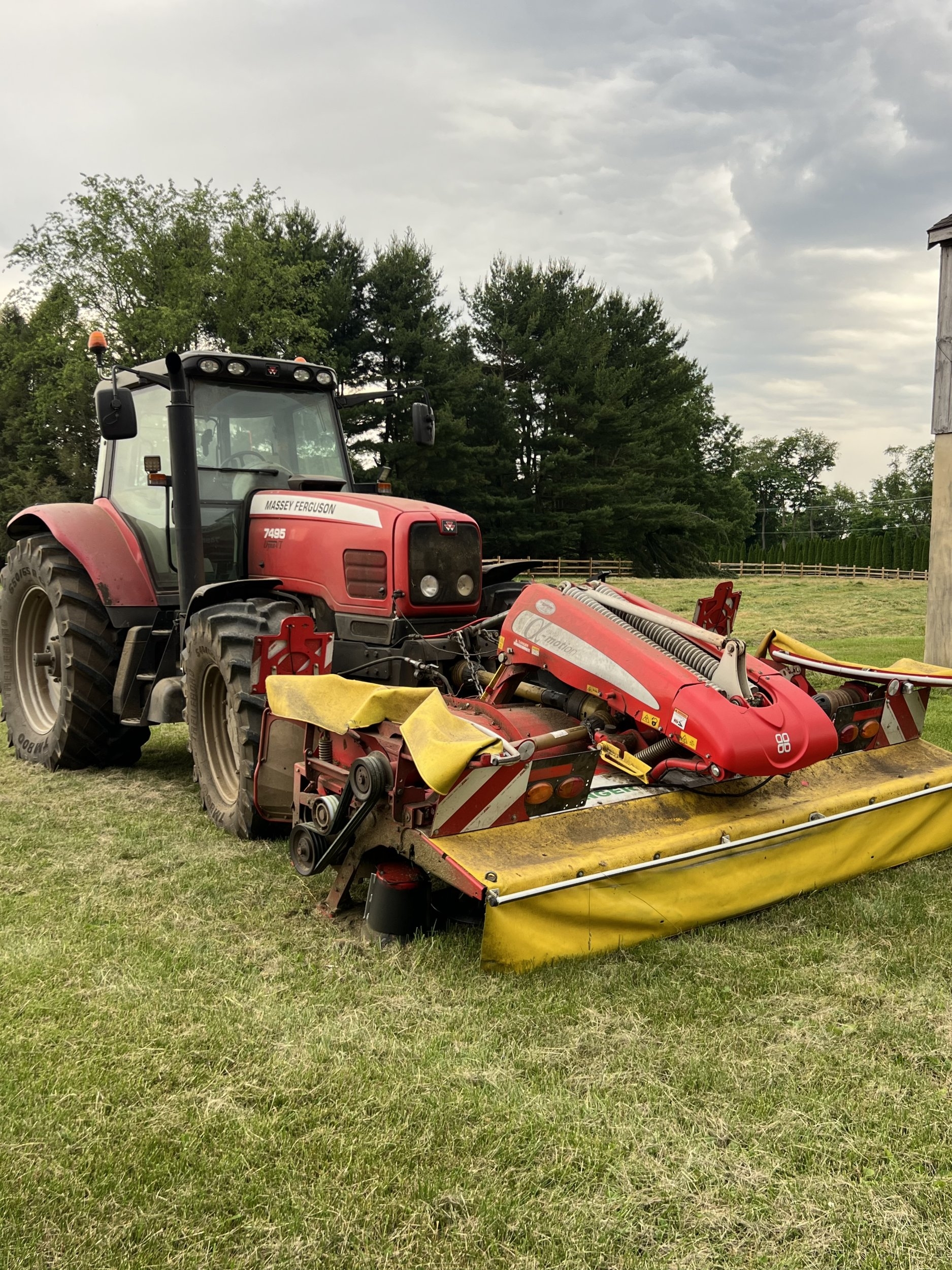

Do you have an air compressor on your tractor to blow out the radiator?
Yes! The Massey Ferguson has air brakes, so it has an engine-driven air copressor, just like a big CDL truck. I have a coupler at the front at the base of the hood. You can see the red hose coming out. I have a blow gun hooked to it.

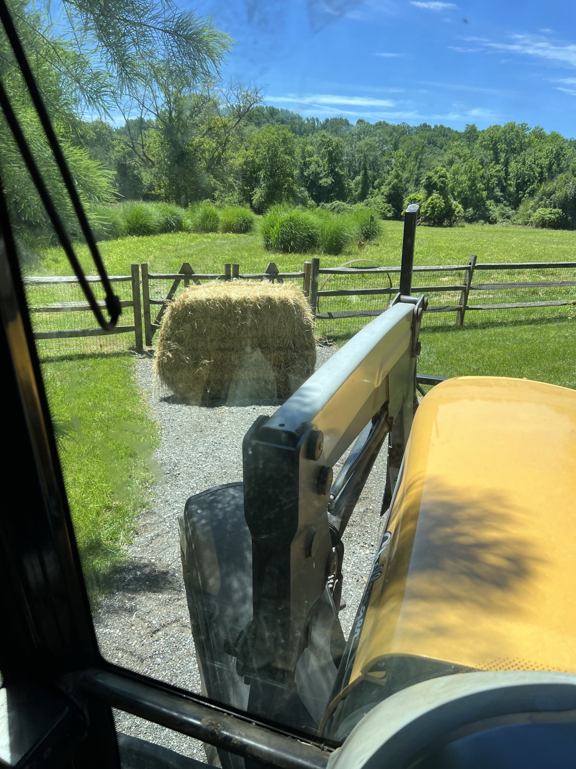

Another feed bale delivery today.
1,000 pounder.
