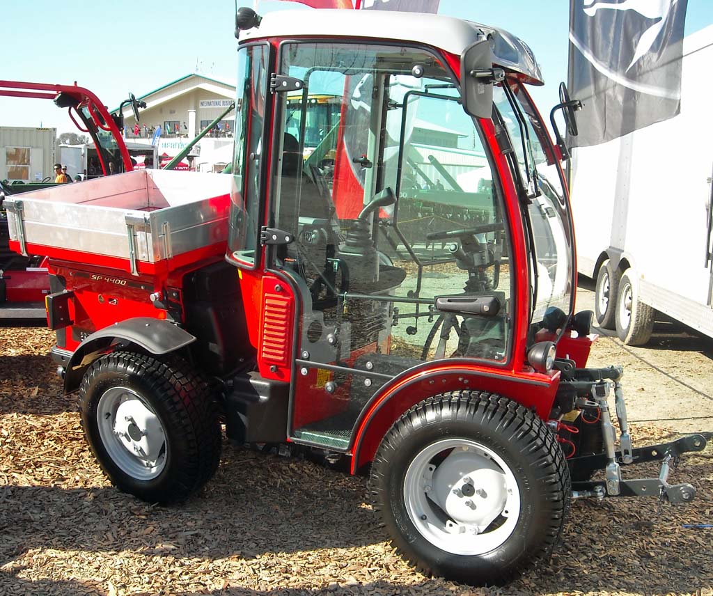

I'd like to add a front PTO and Front 3pt. onto these.
I go to the WorldAgExpo to see the offerings from the tractor makers, and saw this at the 2011
show. It had a front 3-pt and PTO. Not 100hp or your usual tractor configuration, but is was
cool.
That said, I made a front 3-pt for my tractor's FEL, but use a hyd motor instead of a PTO for
rotational power.
