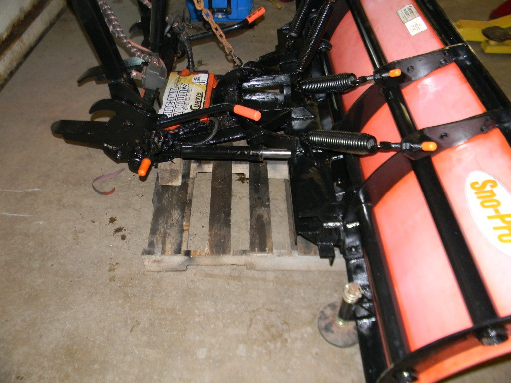

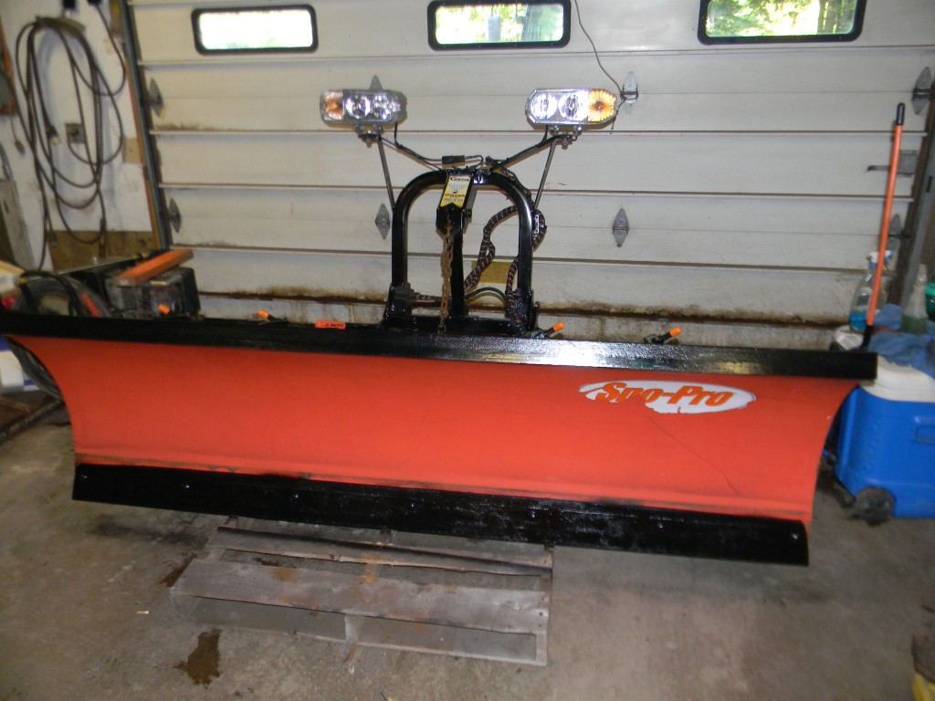

Not on my tractor but I do have a QA Curtis Snow Pro 3000 on my truck. Also called a Hitch-N-Run plow. Probably similar. All the electric / hydraulics are on the plow.
