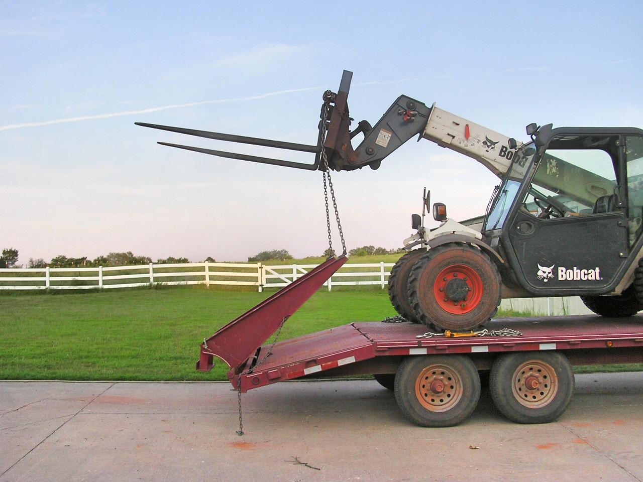

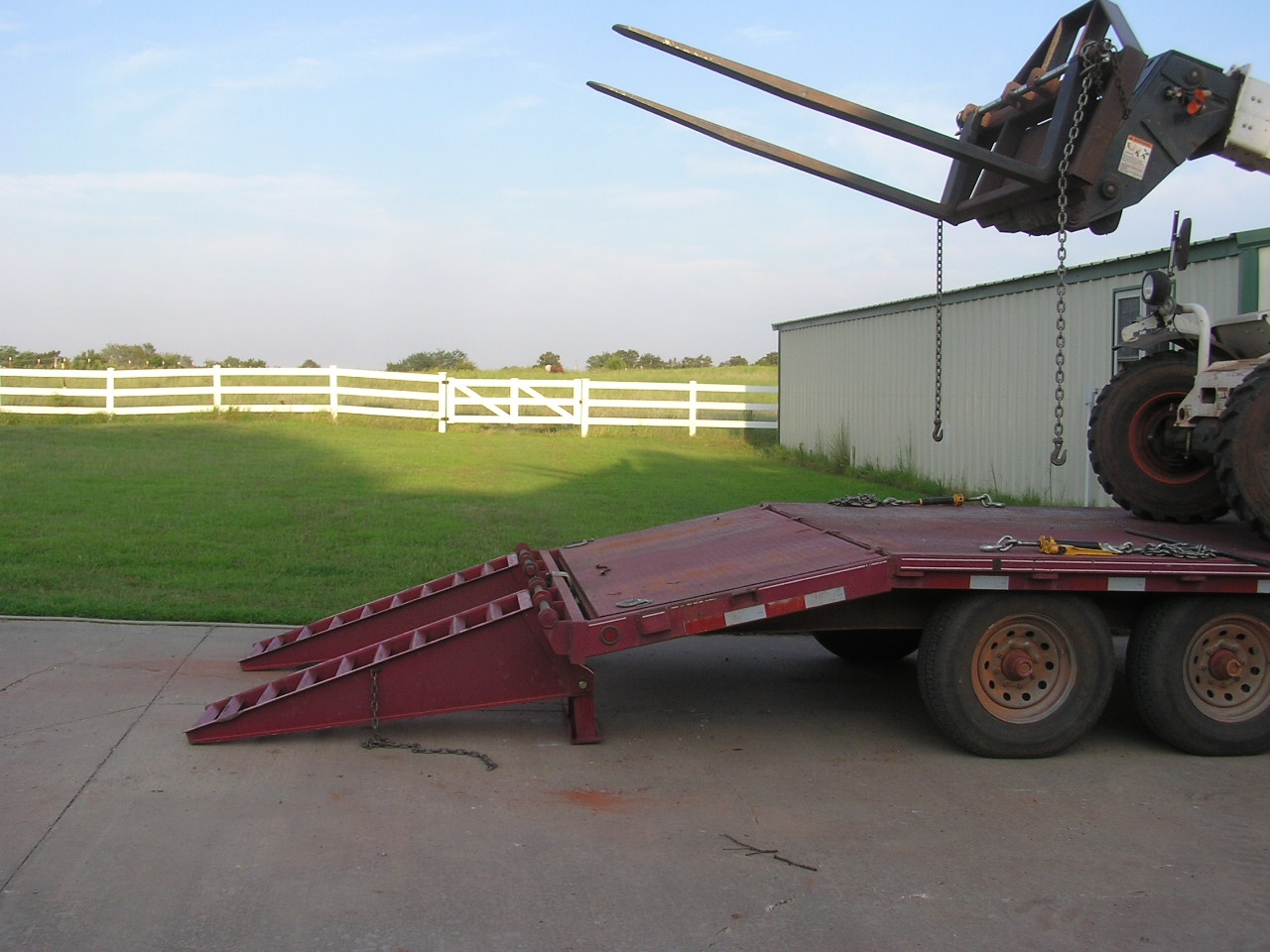

I went with the Mega Ramps on my Big Tex 14GN trailer. I use it to trailer my F2560 72" mower, as well as the tractors. No problems loading the mower.
Exactly.
I have Mega ramps on my Kaufman.
Ever tried sliding those skinny ladder ramps in/out on the pole with rust haze on it?
That crap gets old real fast.
Much easier with full width and even better with expanded metal.

I used to have a Big Tex GN with mega ramps. They had angle iron with the point side up on the ramps. They were good ramps that tracks could bite in without sliding like they do on the ladder ramps and my zero turn would go up fine. The only downside to the mega ramps is they were heavy.

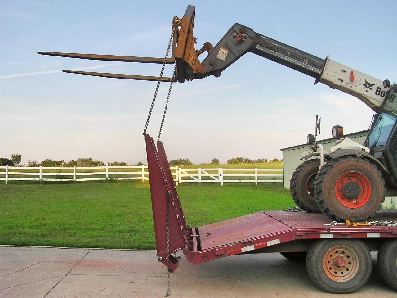

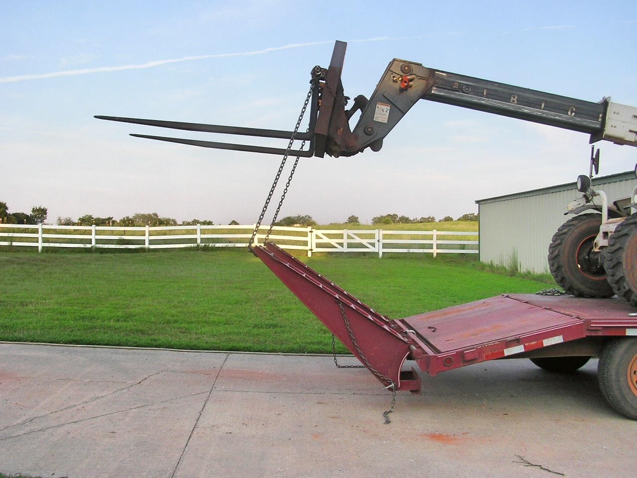

mine are spring loaded. you can lift them with one finger
   / Anyone own an Iron Bull trailer? #70
Mine were spring loaded and not bad at all at ground level where the springs were the strongest. When they were half way up they got heavy.
