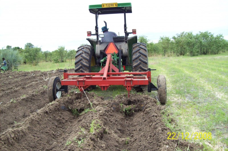

My family did most of the work here on the farm in the last 45 years using small 20 HP to 40 HP tractors to do work that really required larger machines, but all was done well just taking a lot more time. I have a large field I need to plow soon and then level out with a disc and then tooth harrow. I have recently upgraded to a 75 HP NH and was wondering how well it might pull a 2 plow middle buster rather than a single plow. Any advice with a double plow or is the work similar? I have looked on line locally for new and used double middle buster plows and have had no luck so far. Down here they appear to be as rare as hens teeth!

What we call a middle buster plow is not like a mole board plow that turns the soil over in one direction/side, rather the middle buster creates a furrow in the center and throws soil both right and left of center. Our soil is River bottom soil that is a sandy loam with no clay so a middle buster plow easily throws soil in both directions with very few clods if any depending on how wet the soil might be when plowing.
Yes, but you would end up with multiple furrows. If your sandy loam is relatively 'clean', and don't need to turn over sod (which a moldboard plow would accomplish) then just use a disc harrow. If you feel you need deeper tillage to facilitate better drainage or for deep root crops then you could use a chisel plow. A disc plow if you can find one big enough to utilize your 75 HP would also work well. Not to be confused with a disc harrow. The disc plow utilizes a large( 24"+) diameter angled disc to replace the moldboard of a conventional plow. Typically a 30-40 HP tractor could pull a 3 bottom DISC plow in lighter soils.

Double middle buster implement? Something like this?

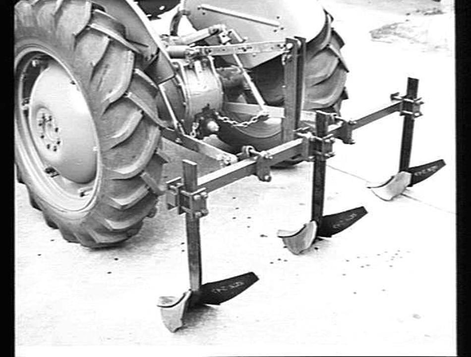

Or on a tool bar like this?
